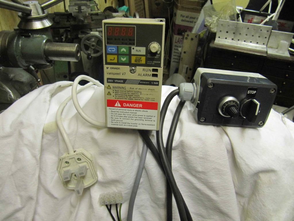

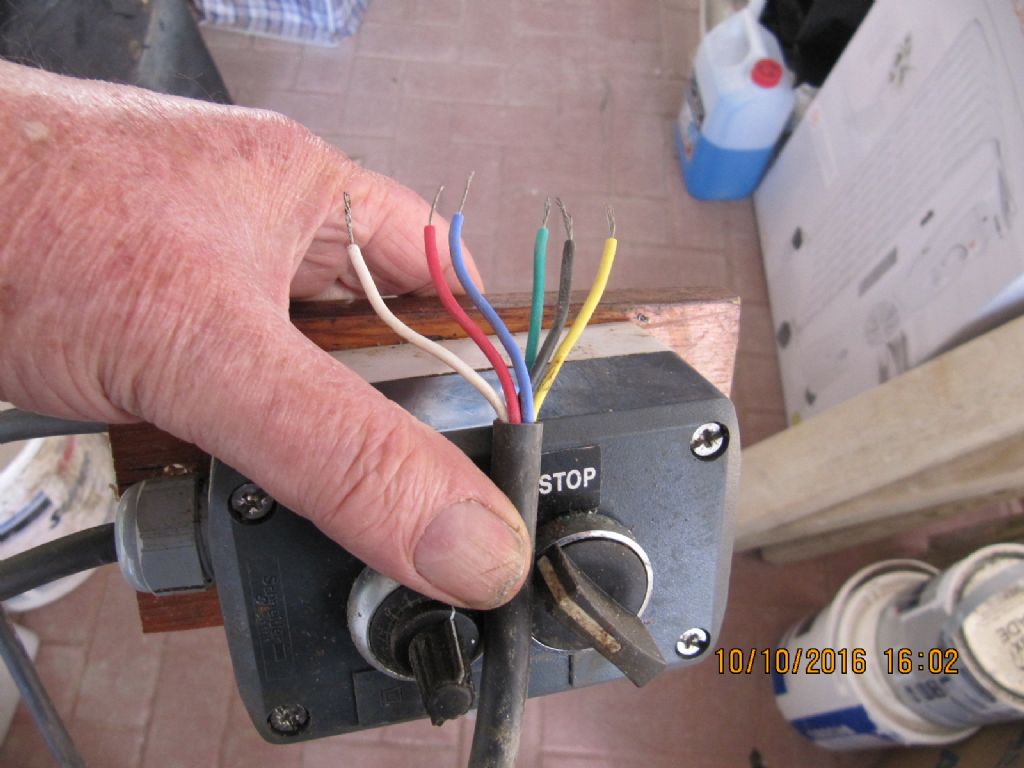

        The first of the pics above shows the vfd as received – all wired up and ready to go.
        The second shows 'as is' now – 'helpful' recovery gang's efforts following the destruction of house and workshop in 2013.
        Ihave a copy of the manual but cannot find any reference to the pendant controls and/or how they are wired in. Any forum member with knowledge of this particular vfd who could offer advice, please?

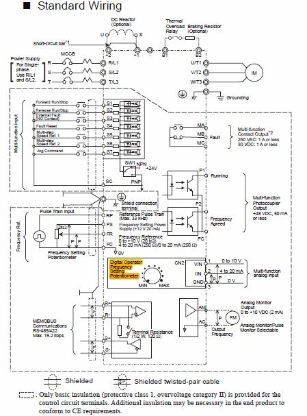

          If the manual I found for download applies to your inverter page 222 "Standard Wiring" and 224 "Terminal Descriptions" (that section actually starts on 223) have the information you need. Page 36 "Wiring the Control Circuits" shows you where the connections are.
          I assume you have a speed control potentiometer and a two way centre off switch for forward & reverse selection on your pendant.
          From the diagram on page 222:-
          The speed control potentiometer goes between Terminals FS and FC with the wiper going to FR
          The common terminal on the forward reverse switch goes to terminal SC, the forward on terminal goes to S1 and the reverse on terminal goes to S2. Stop is when the switch is in its centre (off) position.
          Hopefully nothing else has been tampered with.

              Whooh yeah! Apparently its union rules for the VFD manual writers association that normal folks shall not be able to find the information they require without grave risk to their sanity and being put to sleep at least twice en route. Fortunately it also appears to be union rules that somewhere in the manual there shall be pretty pictures showing the basic connections for ordinary set-ups, the layout of the terminal blocks and a table saying what each terminal is called and indicating what it does. Unfortunately there is no rule that these shall be usefully grouped together near the front of the book where ordinary folk can find them or that the terminal function descriptions shall be understandable without needing at least a masters degree in tech speak. Guess that would be just too easy.
              Not quite so bad when you have some idea of what to look for as its relatively easy to speed scan until you find the pictures.
              I suggest that you find the download on the Omron site and print out the Standard Wiring diagram as large as you can. A4 would probably do, A3 would be better. Much easier to follow on a big picture and room to make notes such as wire colours and make (red?) circles round the important to you bits. You could just print sectional enlargements of the important parts of the picture but I find such rather harder to get on with than a more complete view.
              Certainly appears to be union rules that the version in the box be printed too small to be easily followed. Probably a big prize awaiting the first VFD maker to produce a wiring picture meeting the standard "in the box" level of incomprehensibility when printed to Double Elephant size.
              Hope it all works out.
              Clive.

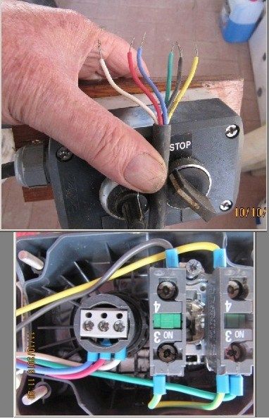

                Your assessment of the 'clarity quotient' of vfd manuals/wiring diagrams is spot on! It's not helped by my lack of familiarity with such things. Apropos which, I am about to ask what may be the ultimate idiot question –
                in the photo below, am I correct in thinking that the 3 wires to the right are the fwd/rev connections and the 3 to the left, the speed connections. Assuming that to be so, unfortunately I have come to a halt!! While I can see on the wiring diagram (P222/3) the item 'Digital Operator Frequency Setting Potentiometer (Speed control?), the annotations for its connections (Block CN2) don't mean a thing to me. Additionally, I cannot see any indications of connections for the fwd/rev function.
                I'm sure that 'for them as knows', it is all quite straightforward but it eludes me. Any further useful pointers would be much appreciated.

                  Bill, The instructions which Clive has given you are correct. You have to take the cover off the inverter front and see the rows of small terminals,( usually several&nbsp all marked up as Clive has said, they tiny and not easily read Fs, Fc and Fr. If there isn't wires in those position, then put three wires into those terminals Write down which colours you use.The other ends of those same coloured wire connect the speed control potentiometer get the colour RIGHT. Next locate in the inverter terminals Sc, S1 and S2 and as before connect the remaining three wires into those same three terminals. Finally connect the same three wires into the correct terminals in the forward and reverse switch. Look out for a PM. John

                      Sounds like you are sorted then. Might help anyone coming across this thread in future to note that the Digital Operator Frequency Setting Potentiometer is the build in control connected to he knob on the box. The pendant connection is over on the other side indicated by the Frequency Ref curly bracket. Basically Frequency is VFD maker speak for speed.
                      Its most likely that the centre terminal of your speed control potentiometer goes to the wiper. If so the red wire will go to connector FR. Blue wire to FC and White wire to FS is probably right but if the knob turns the wrong way to speed up or slow down reverse them. May be best to start off with the potentiometer in the middle so as not to get a jump to flat out if the potentiometer connections are the wrong way round and what you think is dead slow setting is actually warp speed.
                      The turquoise coloured (on my display anyway) wire should go to terminal SC with the black and yellow wires going to S1 and S2 as appropriate to get things turning the right way.
                      As John says the indentification labels on the terminals are usually small and hard to read. They are often a bit offset from the terminal itself and frequently upside down if the box is mounted on the wall or a machine. Which makes it very easy to connect to the terminal next door to the one you think you are connecting to. Been there, dunnit, caught the error under the "have a coffee then go back and check system". Another place where big printout of the picture with scribble room helps as you can more easily physically count from one end to confirm where the terminal is.

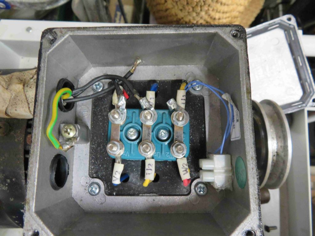

                            First, the good news – NO magic smoke (yet!!)surpriseand the connections, as advised, have produced 'life' in the control box.
                            Next the bad news. Switch on, operate direction and speed controls (on the pendant) produce noises like motor running, accelerating and stopping but NO movement on motor output pulley!sad Try several times, same result. Eventually alarm light comes on, noises cease and the fault indicator shows ol7. This does not appear in the manual – the largest is ol3 but presumably this is similar, but worse!!
                            Now having coffee and biccies to restore nerves but unsure (totally foxed) as to how to proceed. Suggestions from wiggly amps experts very welcome.

                                  Posted by Cornish Jack on 25/10/2016 17:22:27:
                                  Connections made into inverter sockets using proper sized crimp pins (took a fortnight to source the correct size!!) Will check individual wires with a digimeter.
                                  Bill
                                  I've had bad experiences with crimping. It's more difficult to get right than you might expect. Nowadays I tend to avoid using them partly because I don't have the decent tools needed to get consistent results.
                                  It's possible you have an intermittent connection due to a bad crimp.
                                  Intermittent connections are harder to detect with a digital meter than an analogue but try giving the wires a good waggle as you check continuity.
                                  Also do a close visual inspection: all the wires should be firmly clamped at the correct crimping point with no loose strands or other physical issues. Be warned though: I've produced a few good looking crimps that turned out to be poor electrically.
                                  Good luck
