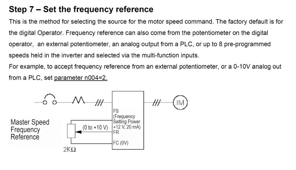

          Diagram at bottom of page 65 of the manual shows how to wire it.

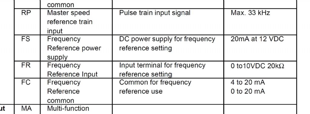

            But I'm worried about the input impedance. 20Ω is very low, and if true would seriously distort the calculation. I'd expect a much higher input value, say 20kΩ. Is 20Ω correct?

              Thank you for looking that up David, and taking the time to respond i believe you are referring to this diagram:

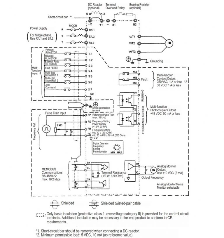

              I may not have been clear enough in my worry. As a beginner i see something that says it needs 0 to 10v, in this case the FR terminal, i start to question myself, before using a12v supply. Even with a potentiometer, i am regulation the voltage between 0 and 12v, not 0 and 10v.
              I don't know if this over volting has adverse effects, or if the only side effect is, that the last sixth of a turn on the 2K pot, will be a "dead zone".
              I might be overthinking this, but it seems very odd, that three terminals that are meant to interact has different voltages. On every other VFD i have seen, the frequency reference power supply voltage has been 10v, not 12v, so i thought i might have gotten my hands on some fancy VFD, where it's common knowledge that you are supposed to put a resistor in series on the 12v side before the pot, to get the 10v, since these terminals also can receive a signal from a PTC.
              Here is the complete diagram of the VFD:
                Hello Dave, and thank you for your kind reply. I was writing my previous post, while you were posting, so that's why my answer might have seemed odd.
                You are indeed right that i misreported the impedance – it is indeed 20k-ohm. I don't even know precisely what impedance is in this context, and what effect it has.

                  When you use an external 10 V analogue input to control the VFD setting parameter n004 = 2 will also re-scale the input so 10 V is maximum speed. I suspect the external analogue control is actually a current loop rather than voltage.
                  When you use the on board 12 V source and potentiometer as per diagram maximum speed needs 12V, ie pot right at the end.
                  Presumably 12 V is provided to ensure that 10 V can be provided if the VFD is a master source for a current loop control despite some voltage drop over the wiring. I guess you'd select a suitable series resistor in that case.

                              I wouldn't presume to understand your explanation fully, but from what you are describing, the pot does indeed function as a divider.
                              On leg connected to 0v common terminal, the middle wiper "leg" to the frequency reference input terminal, and one to the 12v frequency reference power supply.
