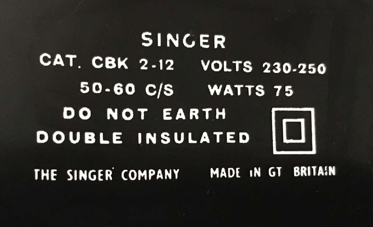

                              On Michael Gilligan Said:
                              Now that we have a discussion going … I would just like to mention that [whatever the modern implications might be]  Singer stated very clearly that the wiring should not be earthed.
                              Yes, the electrics of Singer’s early machines are very simple, and have no provision for an earth.  Made sense at the time, before the UK standardised on 240V 50Hz, when power was provided in some local voltage in AC or DC.   I’m fairly sure Singer’s early electrics pre-date Class 1/Class 2 safety requirements, and would not be acceptable in a new machine today.   As older machines are made of exposed metal, they should be earthed – just like a lathe.
                              Robert gives a good explanation of why these old machines aren’t Widow Makers.   Briefly,  Singer went to a lot of trouble to isolate the motor from the machine.   The motor is enclosed in a Bakelite case, and it drives a rubber belt with a Bakelite pulley.   Not easy to be zapped by one.
                              But what happens when someone changes the Singer motor for a different type?  The modification could break Singer’s safety system, for example an ordinary metal cased motor will probably connect electrically to the machine through the mounting bolts which the Singer motor doesn’t permit.   Thoughtlessly substituting a new motor is risky because it may not meet modern requirements or Singer’s original design!

                                          #760842
                                            In case anyone is interested [in these heady days of BLDC motors:
                                            This is printed on the black Bakelite [?] cover of a recently acquired motor … text starts  approximately 2” from a steel mounting plate … through the slots in which the motor windings can be seen, and could be prodded with a screwdriver.
                                            Ho-Hum
                                            IMG_0213
