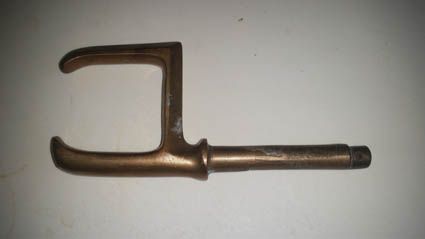

      I have been asked if I can machine the shaft of this rowing boat rollock. Its a brass casting I think. The shaft diameter is approx 15mm and it needs to be 13mm.
      I suggested drilling out the hole it goes into but for whatever reason thats not an option. My first thought was to clamp to an angle plate that is mounted on a face plate. I have a Myford lathe.

          hold the shaft in the chuck to hold it somewhere near put angle plate up to fork end and pack and clamp. put angle plate onto faceplate or if you have a mill reverse bore outside of shaft. balance faceplate with counter balance weights if turning.

            Cast some "Cerobend" (low melting point alloy) around one side of the "U" end. Hold shaft in the chuck and clean up the cerobend end. Turn it around in a 4 jaw chuck so that the shaft is ready for machining. Put a small centre into the tailstock end of the shaft.
            Material will be bronze, not brass and will turn nicely, but like you, the shaft needs all its strength, so don't reduce the diameter too much.

                Cerrobend or Woods metal is very good for this type of job, it melts in hot water but is quite hard at room temperature and, of course, it can be used over and over again.
                I first encountered it when I started working for a company repairing jet engine turbine blades that are very difficult to hold for machining due to their shape.
                The blades were placed into a mould with locations to match those on a milling fixture, filled with Cerrobend and then machined after which they were dunked in boiling water to remove the Cerrobend.

                  It looks as if the curve of the Row-lock is over the center line of the spindle, if so put spindle in chuck and drill center and then reverse, set up between centers and turn spindle down to size., Simples.

                                I would explore the option of drilling the first, say 25mm, on the boat and then do as Clive suggests.
                                Reason is that removing 25% of the shaft, at the main point of stress, would be avoided. But maybe it is well over-engineered so thinning would not be a problem?

                                  How about cutting the round bit off at the collar. Drill and tap the 'U' shaped section and insert with Loctite a new 13mm dia brass or stainless steel pin. Possibly use the sawn off pin if it will be long enough after having turned it down on the lathe.

                                    Its's a crutch- iron made of brass.. for the pedants… I had a similar job on some for a waterman's cutter they were made from cast bronze/ admiralty bronze. The shaft was worn on the back side so the answer was to lop of the shafts and drill and tap M12 in the shank and then machine up some stainless shafts the right diameter cut a thread and then screw and braze.

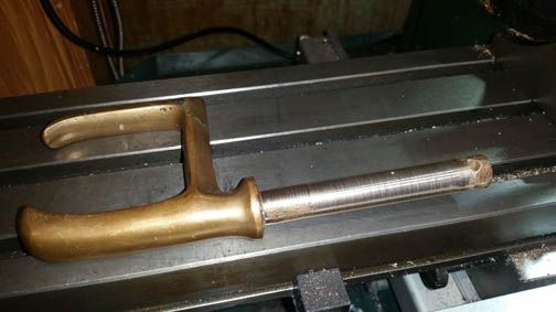

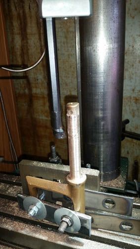

                                            Well three months later I have finally finished this job for my friend. I decided to buy a boring head and then a left hand turning tool. It doesn't take much for me to convince myself that I need another tool !
                                            OK this finish is not great but it will serve the purpose. Most difficult part was of course holding the crutch as nothing was 'square' on it.
                                            Again thanks for all the suggestions!
