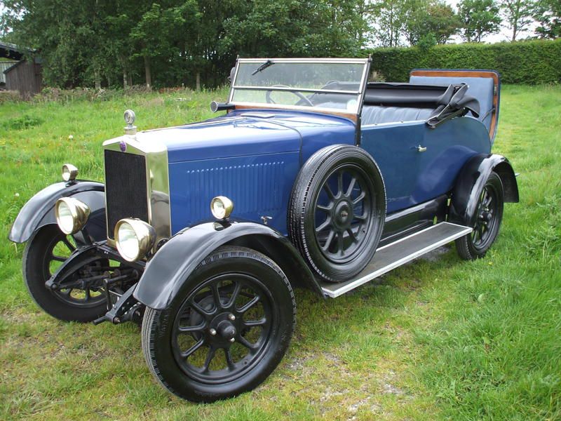

                      This page lists some of the more unusual thread standards: **LINK**
                      The engine of this car I restored used French Automobile Metric threads with Whitworth size hexagons!

                          Very nicely restored car Russell.
