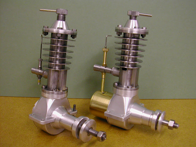

                      I finished the engine late on Wednesday but not so late as to try another drop of fuel and this time it fired and ran on the prime.
                      Thursday saw it’s first run. No problems once the fuel was up (about 15-20 flicks) and the right compression found. Swung a 13 x 5 prop with ease at very moderate rpm – I would guess 4-5,000. It also ‘idles’ nicely when the comp is backed off and the needle opened.
                      The drawings were very good, no dimensional errors and only two omissions which had to be worked out by scaling. Other than the addition of the ‘screw in port’ for the intake tube and the slight change to NVA it was made to drawn dimensions. The porting gives reasonable timing – also done to dimensions given.
                      I’ve made lots of bits for engines over the years but never the whole thing. When it burst into life it brought a grin from ear to ear so I very much doubt it will be my last. Thanks to those who expressed an interest – I’m under no illusions – I fully appreciate it’s not a ‘Merlin’ or similar grand undertaking but it’s give me a lift so I hope it’s inspired someone somewhere to have a go.

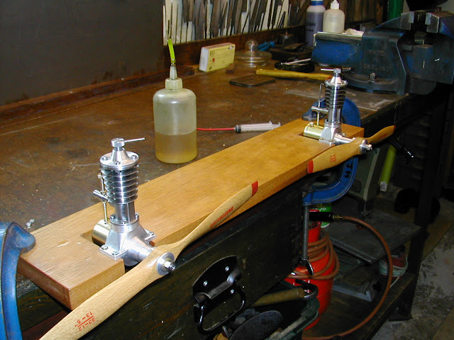

                            Just like to add my friend John finally finished his engine and I went over to his today for a twin run. In a word – Magic!
                            He had made a mount out of a nice piece of wood, the engines were bolted in and the flicking began. Not too good at first but we put that down to the cold – it was a bit parkie with the windows and doors open and snowing outside. Anyway finally got them running – bet his neigbours were impressed – and they performed well.
                            By cunning reduction of his spray bar diameter his has a much larger venturi area and was doing a consistent 5100 to mine steady at 4000 – his has a nicer beat too so having chided him for already ‘tuning it up’ it’s a now question of ‘if you can’t beat ’em’ etc.’
                             It was a good end to a short, very enjoyable project – on to the next? You bet.
