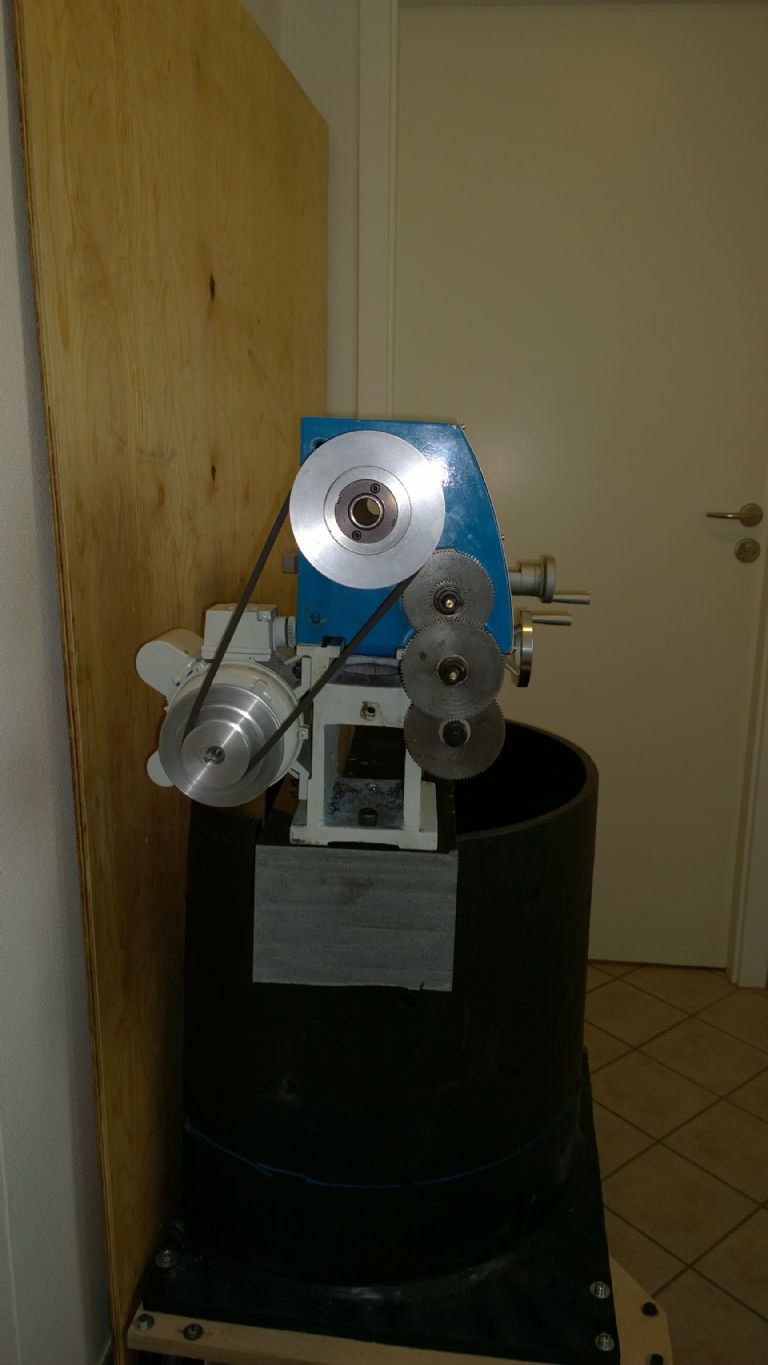

          Somehow I cannot put text on when having linked a photo.
          I need some advice.
          Single phase 4 pole drive system of my WM250 lathe makes an awful noise and I want   60 to 1200 rpm spindle speed with a VFD.
          I can either use a two pole motor and a 1 to 5 Poly v belt or a 1 to 2.5 SPZ belt .Both with a big disc diameter of 125mm.
          What will make most noise and trouble?.

          Brian Wood
            @brianwood45127
            Niels,
            I can't guess at what you mean by " an awful noise". Is it the usual heavy hum from a standard single phase motor? Try it with the belt off to see if you have that too tight. Judging if it is excessive is rather subjective.
            Fitting the motor on bonded rubber mountings will reduce the motor noise transmitted through the foot plate into the machine
            Your second point regarding spindle speed will not be helped by fitting a 2 pole single phase motor as you will be doubling the motor speed from 1425 rpm to 2850 rpm instead. That too will be a 'noisy' motor.
            I am confused by your reference to vfd as well, those systems are not compatible with single phase motors and you would have to change the motor to the 3 phase unit that the vfd will drive.
            Regards
            Brian

                #394143
                Jeff Dayman
                  @jeffdayman43397
                  Hi Niels,
                  If that is a piece of big steel pipe the lathe is sitting on, the pipe itself could be acting like a sound amplifier of the motor noise, vibrating like a bell. I'd try the lathe on a wood or angle iron bench to see if noise is reduced before spending $$$ on VFD or different motors to reduce noise. Just a thought.
                  #394144
                  Hopper
                    @hopper
                    Could it be that strange drum arrangement you have your lathe mounted on amplifies noise?

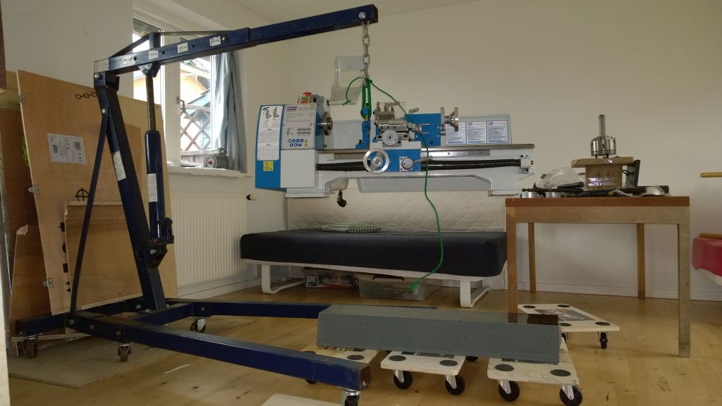

                    #394184
                    Niels Abildgaard
                      @nielsabildgaard33719
                      Noise was more or less the same as in picture.Single phase motors are junk.

                            The bench on which you mount your lathe needs to be rigid, if only from the point of view of dimensional stability.
                            I would not expect to get consistent work from a lathe on a flimsy support.
                            Plain sheet steel is likely to radiate any slight noise and effectively amplify it. (Especially if any of the frequencies coincide with the natural frequency of any of the panels ). A panel with a natural frequency of 50 Hz, or 60 Hz in North America, could be a nightmare!
                            Sheet steel panels are often braced, or slightly dished (Look for shallow diagonals, pressed in), to stiffen the panel.
                            In extreme cases, to damp out sound, panels have been made as a sandwich, double skinned with a lead or rubber filling. At least one Lotus car had a firewall consisting of two sheets of Aluminium with a foam filling, for strength as well as sound deadening.
                            Either the panel can be isolated from the exciting forces, (such as rubber mountings) or tuned so that the resonant frequency is above or below the normal spectrum of human hearing..
                            Lets hope that the "horrid noise" is not failing bearings! Nothing is fouling anywhere is it? Pulleys, or belts on guards?

                            Niels Abildgaard
                              Posted by Howard Lewis on 01/02/2019 16:15:54:
                              Hello Howard
                              All my lathes are mounted on a piece of granite or diabas(dolerit).
                              The black tube is a piece 600/640mm PEHD tube.
                              Motor makes the noise and I want 60 to 1200 rpm by turning a potentiometer anyway.
                              My wish for advise was between two pole and four.
                              I try four first.

                              #394204
                              Howard Lewis
                                @howardlewis46836
                                Ah! A man after my own heart! That should not flex noticeably. If in doubt, make it like a brick mausoleum!
                                Four pole motor will be smoother than 2 pole. Three phase, dual voltage, will be ideal for VFD speed control.

                                Dave Halford
                                  @davehalford22513
                                  Niels, You might find the noise is caused by the sheet steel rear splashback drumming, it's quite a big sounding board.
