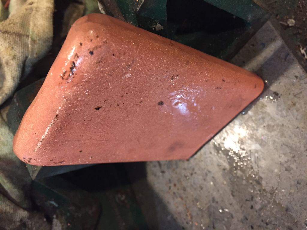

      Whilst making a 2" scale boiler for a traction engine mid 2018 I missplaced one of the inner firebox plates, so made a new one and carried on. Yesterday I was forced to extract a boiler from the acid bath by hand (vets full arm glove) and to my suprise came across the lost plate laying on the bottom. I had always wondered what effect long term acid soaking would have on copper. Anything over a day with brass is very bad news – im using 30% Sulphuric Acid so its strong stuff. The plate in question has a little crystalisation of acid salts on its surface but other than that was in perfect condition – I wont be using it but I wasnt expecting it to look as well as it does.img_0004.jpg

          Copper is one of the least reactive metals, barring the 'precious metals' – it will react with oxidising acids (eg nitric), but only slowly with others. I believe nuclear waste is buried in copper containers for this reason.

            When I snapped a Mills 1.3 crankshaft in a partially turned 2024 aluminium alloy spinner-nut I put it into a plastic yogurt container, covered it with sulphuric acid (battery concentration) and left it in the garden.
            After six weeks the steel shaft finally turned to a black powder that was easily flushed out.
            There were a few dark spots in the aluminium which had turned gray but it was only on the surface and machined away easily.

              That's very interesting. I get in a panic leaving copper in my suphuric acid bath (only about 5%) but from the above I'm worrying quite unnecessarily!
