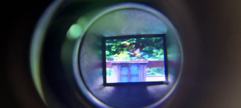

                          Hello all. A reply to my question about a night vision monocular. I brought a Bestguarder 6×50 it has a camera and video recorder, it's well made but I'm a little disappointed with it. I done my homework using reviews and YouTube, plus advice given here. Am I asking too much from this monocular, it states that it can be used daytime, on YouTube it shows a clear images of objects, mine shows a fuzzy image like a cheap digital camera. At night it works as good as the YouTube images. Another point is the lens cap has a air hole which is about 2mm, I can see during the day through the hole almost the same quality image with the cap on or off. I am wondering if the monocular is faulty or not,any thoughts please.

                                    BOB BLACKSHAW 1
                                      @bobblackshaw1
                                      These two photos one with the lens cap off,the other lens cap on with the 2mm air hole. I took the photo through the lens.20230701_113041.jpg20230701_112853.jpg

                                      Robert Atkinson 2
                                        @robertatkinson2
                                        The manual does not show the actual image sensor resolution. It is probably 640×480 Not the 500 million pixels claimed by the adverts. The fact that it is colour immediately tells me it is not optimised for night vision with IR illumination. Assuming it has no IR block filter (there is no control for a day/night filter), being a colour sensor immediately puts it at a disadvantage for both day and night. The lack of IR filter reduces sharpness in daylight due to IR wavelengths being out of focus. At night the colour matrix on the CCD reduces the IR sensitivity.
                                        I'd send it back. Look for a used Sony digital camcorder with "Nightshot" this will work much better as it has a movable IR filter. Bit of info here:
                                        https://laserpointerforums.com/threads/why-sony-nightshot-diy-night-vision-here.71151/
                                        Robert.
