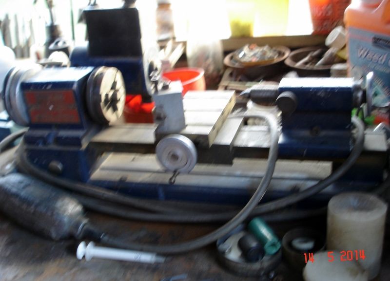

                    dsc00894 (800x577).jpgGot a mate who has a Sherline Lathe, it was made in Australia, it's a good bit smaller than what you have, but there is some good stuff made on them.
                    The other year I was looking at smaller lathes, Jaycar had one the right size, only thing wrong it was a bit out of my price range at the time, don't remember the make, and I don't see it in last years NZ catalogue.
                    Sorry the photo's a bit fuzzy.

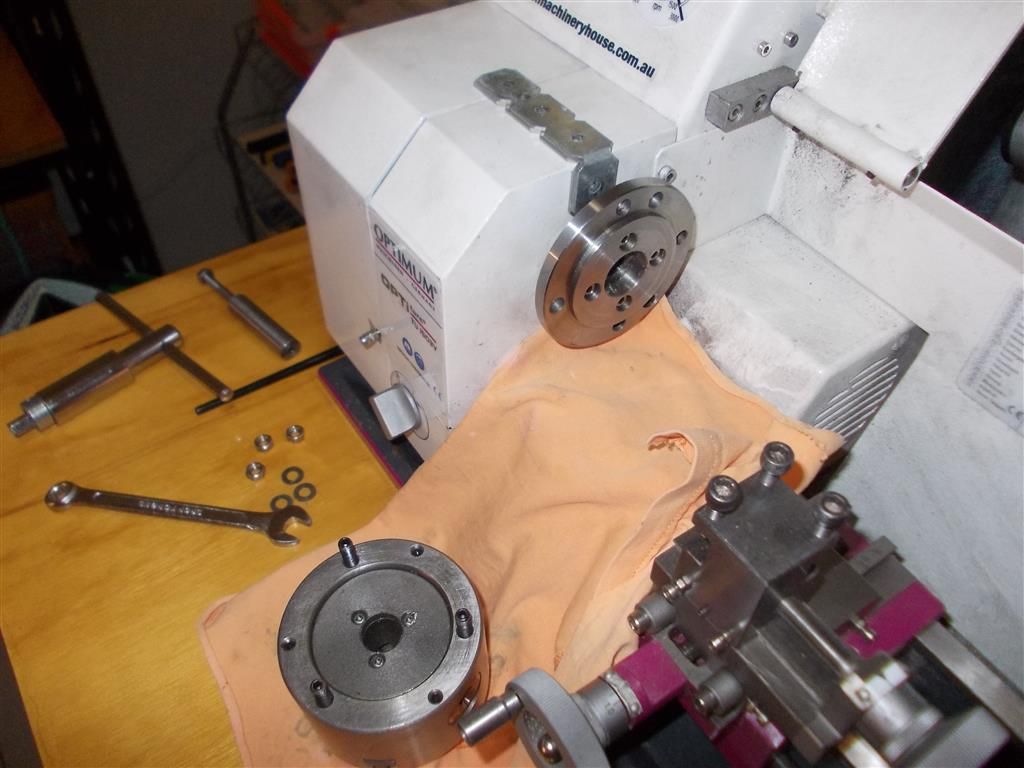

                                  Now that I have the correct size spanner I decided to remove the chuck to see what sort of fittings I have at the back of the chuck/backplate and examine the possibility that a generic face plate may fit. I used Ketan's suggestion of putting a larger spanner through the chuck jaws while applying pressure to the nuts with the correct size spanner (3/8 inch)…thank you Ketan. It worked very well but now what ? I thought the chuck should just pull off but it will not. I have tried tapping gently with a hammer against a piece of wood but it is not moving. Before I apply more pressure (or get a bigger hammer !) I thought I had better ask for some advice.
                                  The exploded diagrams in the manual do not seem to offer much help. I have called the company but they also said it should just come straight off. I am only tapping gently against the wood ; I am yet to give it a decent whack. I am reluctant to do so in case I have missed a step in the chuck removal process.
                                  NOTE : they also suggested locking the cross slide when turning a diameter ie. machining the outer surface of a flywheel. This would solve the problem of excessive movement in the cross slide when it is at the extreme end closest to me. I should have thought of that myself !

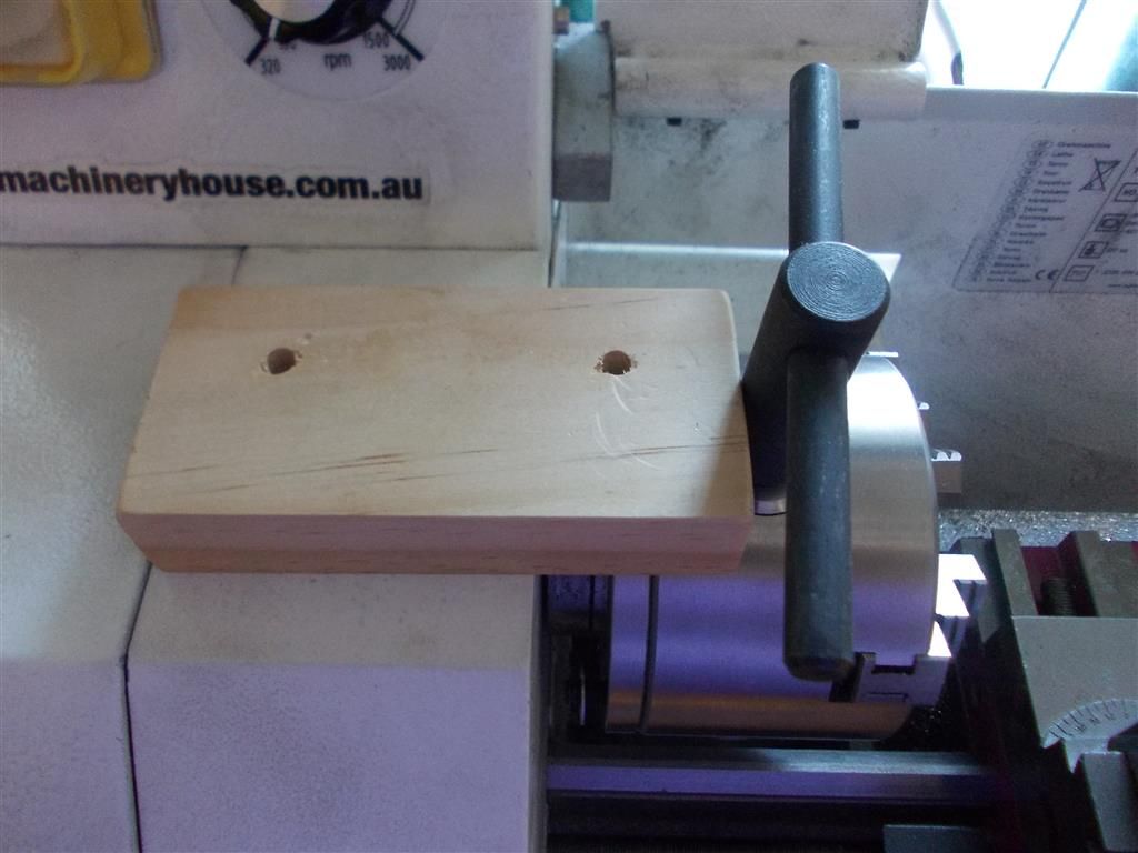

                                    Put the nuts back on loosly. Find a bit of flat metal to put between the headstock and the nut. Then undo each nut a fraction of a turn so they jack the chuck off against the metal packer. Once you have jacked one you wil have to slacken it off, rotate chuck to next one, etc.

                                        Before following Jason's good advice -put a bit of wood under the chuck, save the bed! Then make a proper bed cover.

                                          You will probably find you can use the end of the spanner as a lever Brian against the partly undone bolts.

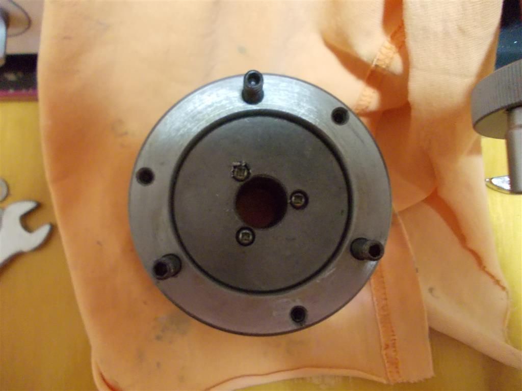

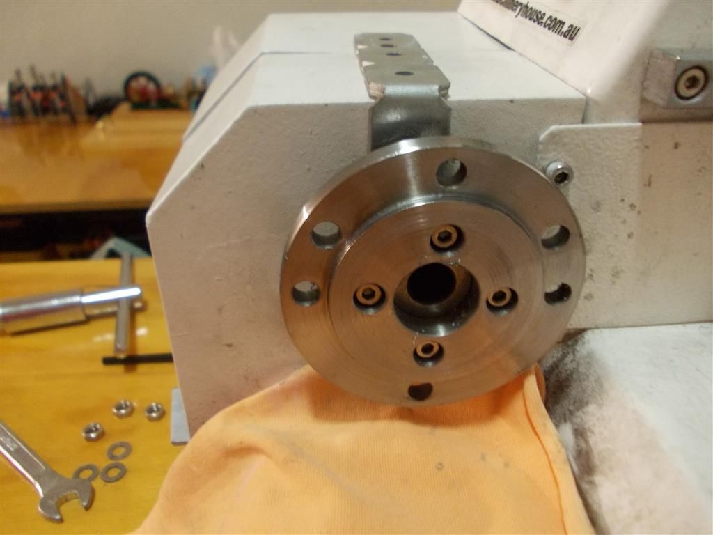

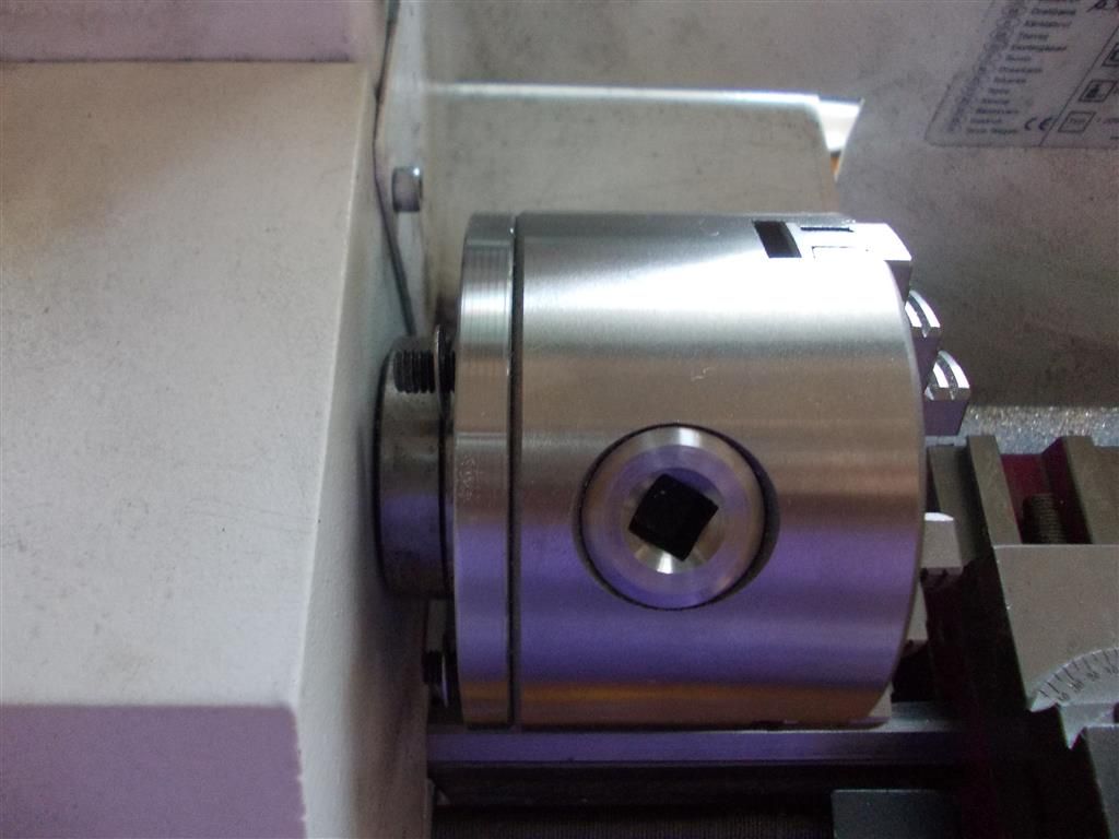

                                            I used Jason's method and it was successful (I could not wait until tomorrow). Thank you to Gordon for his advice regards protecting the bed with timber and cloth. I see no need at this stage to remove the back plate which is held on with four socket caps. Does anybody recognise these fittings as generic ie. will any 80mm or 100mm face plate fit ?

                                              Brian it would help if you gave us the diameter of the recess in teh back of the chuck
                                              #207064
                                              Brian John
                                                @brianjohn93961
                                                The recess is 3.4mm deep and 55mm in diameter.
                                                #207067
                                                  3-jaw and 4-jaw chucks with a 55mm register are readily available here in the UK.
                                                  Beware! Some have an unsuitable  63mm register, also some have four fixing screws which should still work with your flange which is drilled for 3 and 4 mounting holes.
                                                  There are two sizes 80mm with M6 fixing screws and 62mm with M5 fixing screws.
