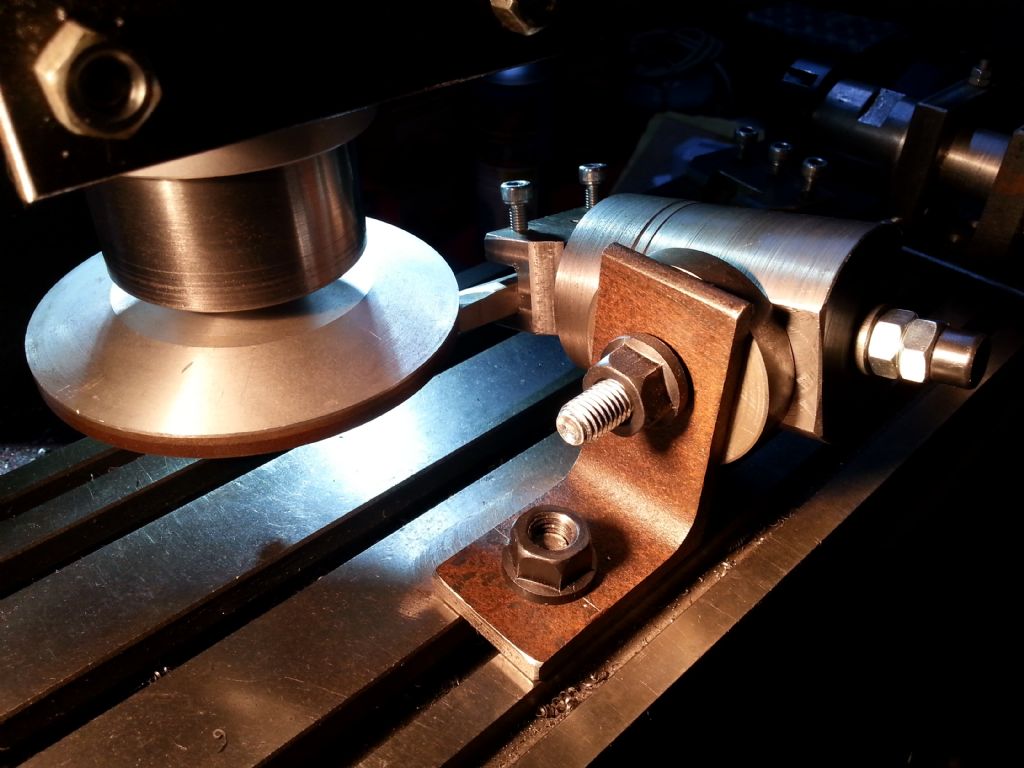

                                                Michael Horner
                                                  @michaelhorner54327
                                                  Here is something I made from the junk box. I needed to touch up the cutting edge on a few tools. You can get 360 degrees on 3 axis. so should be able to get the angle you want, I think it can be improved upon time and brain power permitting.
                                                  Cheers Michael
