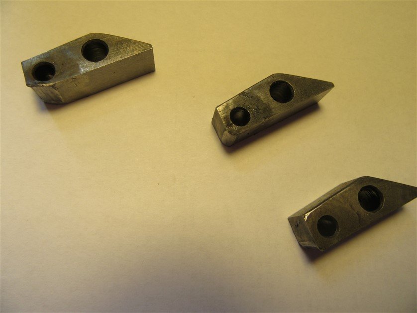

                Many thanks Gray, excellent points. The original (I assume) pin broke rather than bending but both the drill shank and silver steel replacements bent. Both, at 4mm, were a light press fit. I agree re replacing all three so have now removed the pivot pins and pawls. There is a fair amount of visible wear on the pivot pins and the holes in the pawls are (intentionally I assume?) about .010″ larger than the pins and the retaining holes for the pins. This gives a lot of “float” on the pivots.
                As you may be able to see all pawls are significantly worn on the face that engages the ratchet, but one (not the one that keeps failing) far more than the others indicating it has taken most of the load.
                Advice from the owners’ club experts is to have the worn faces built up with weld which I will need to have done as my welding skills are minimal but I’m sure I can find someone to do it locally. Then I’ll be able to file/grind back to original profile. The pawl material is obviously quite soft.
                The operation of the device is that the pins only serve to pull the pawls into engagement with the ratchet attached to the end of the crankshaft and once in contact these should be held in position by the torque from the starter motor until the engine starts when the ratchet spins faster than the starter, pushing the pawls back out so they clear the outer part of the ratchet.

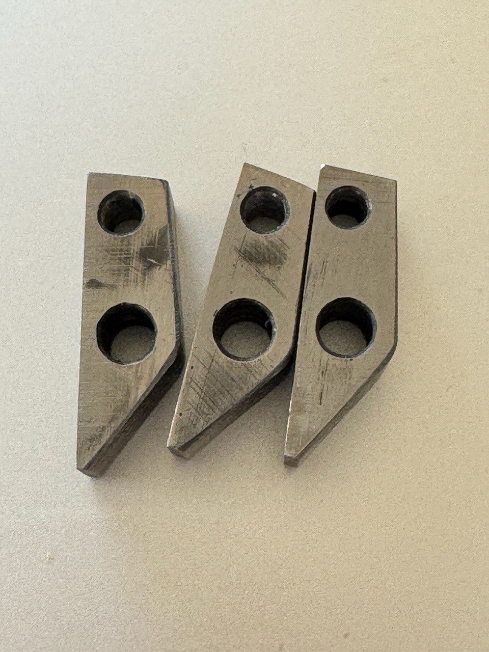

                  Just reporting back on this – John did a brilliant job in rescuing my damaged pawls. Really saved my bacon there.
                  These are they before John’s attention:
                  and here after, with all sharp edges restored.
                  I’ve also followed the advice to use hardened and ground dowels for the pins which is working well – so far…… Many thanks to all here.
