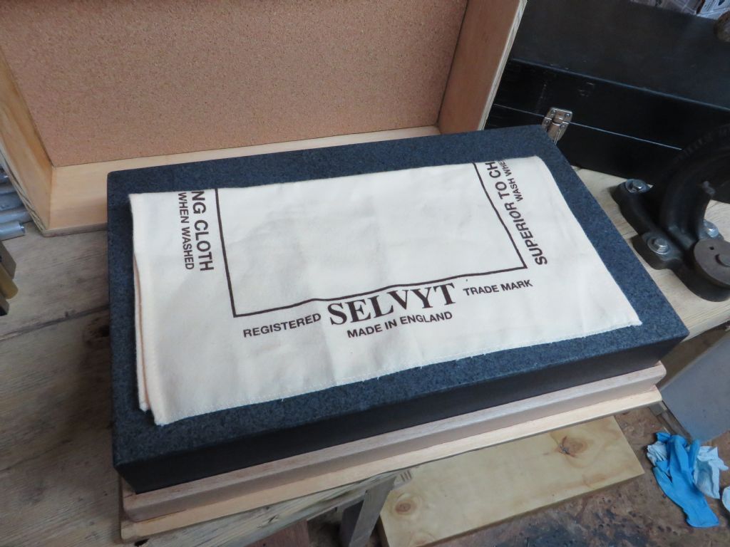

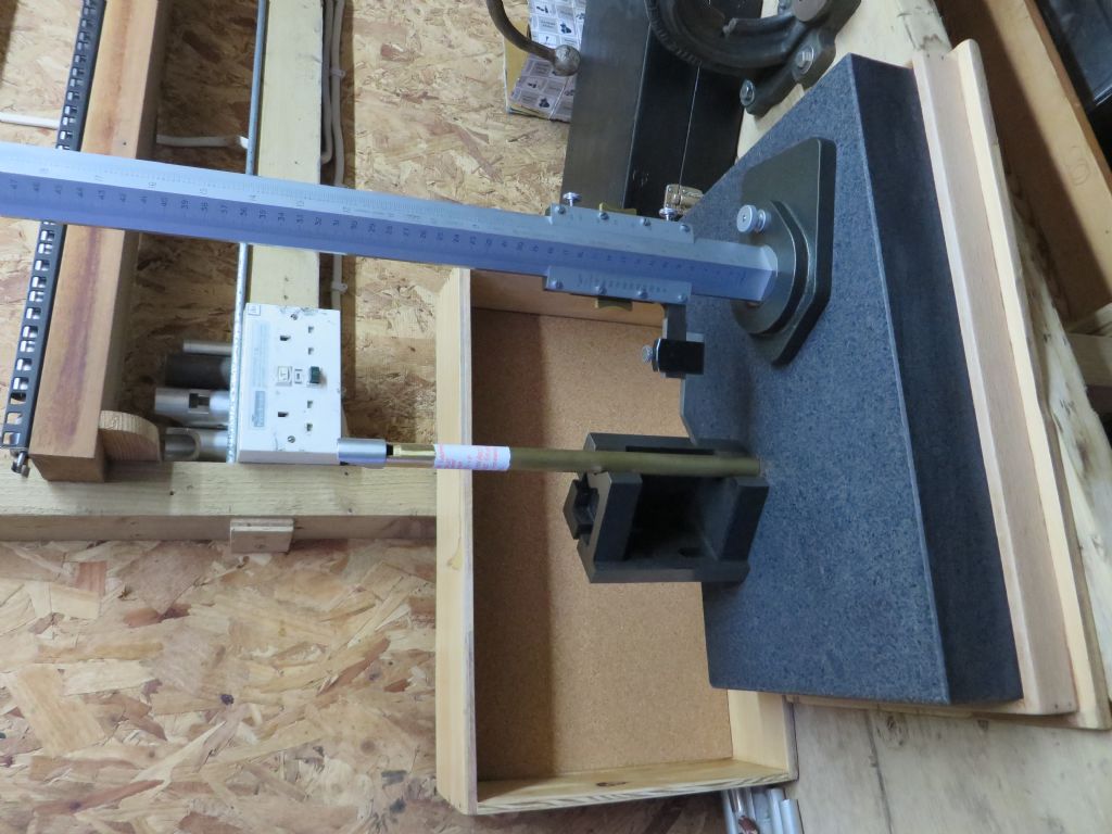

                                                  I am very happy indeed with this surface plate! I made a box for it and it sits in the bottom part permanently with a piece of cork (3mm thick) underneath to ensure it is fully supported. I have lined the top of the box with cork as well. I purchased a selvyt cloth as well for cleaning before and after use. Only thing I will say is that when it came it had a very small chip off the edge, I think you can just about make it out in the pictures but it is no problem at all. Price is bang on. Happy days!

                                                    Should they not be supported at three points?
                                                    #337393
                                                      Posted by not done it yet on 19/01/2018 09:13:25:
                                                      For "anti-rocking" stability, three-point support is ideal … but that does permit the risk of the plate sagging under its own weight [minimised by selecting the right three points, but never zero].
                                                      Otherwise; distributed support, as provided by James's cork sheet, should be good.
