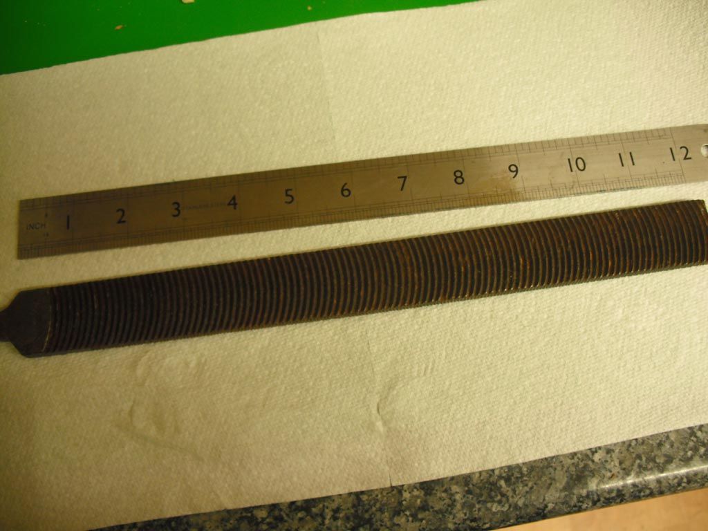

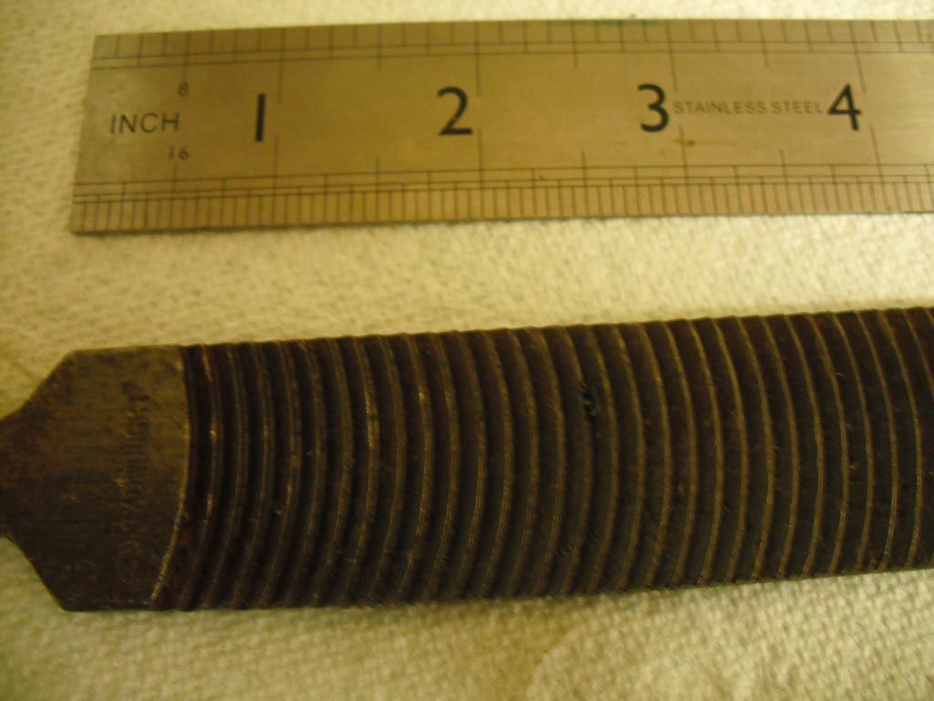

        file1.jpgThis used to be my Dad's and I've had it for years, but never knew what it was for. Some one on here will probably know. It's the same on both sides and has one safe edge. The writing at the top looks like "Dreadnought". Sorry for the poor quality photos.file2.jpg

          I have a a few like that ,use mine on car body work filler and when using lead to take it down a bit ,hope this helps.

            That will be a Mill tooth / curved cut file. Used for fast cutting softer materials like aluminium alloy and commonly used for shaping body filler.

              Yes agree with John Brown 17. I used mine on car bodywork many years ago when lead loading.
              #452355
                I thought" Millen" cut files had the straight teeth and Dreadnought the curved ones

                  It's certainly what Dad called a Dreadnought file.

                    Also known to be used by farriers / blacksmiths when re-shoeing horses.

                      Very likely an Aven Trimmatool blade, a Surform rival from the 50's and 60's, as far as I can remember!, sold a few in my time.

                        We used to use them on aircraft aluminium panels. They used to slice your fingers when your hand continued pushing, but the file stopped moving. We also used Millenicut files. These has straight teeth in sets of 5 , 4 teeth were normal and the 5th was serrated.
                        Dreadnaughts were a very coarse file, followed by bastards, straight cut and second cut. File cards were used to remove swarf from the file and chalk rubbed onto the file to a) stop swarf sticking to the file and b) make the cut finer for finishing.
