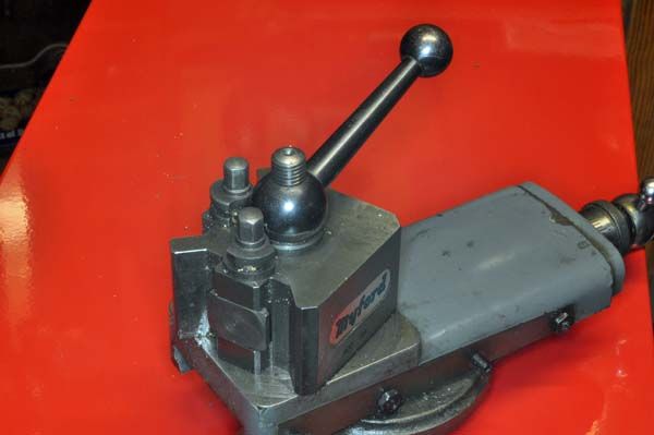

      I would like to make a ball handle/lever for my Myford ML7R tool post, to replace the standard nut and spanner arrangement.
      For it to be visually correct the dimensions/ proportions are important. Can anyone provide this information please? Not sure if this was or is a Myford part.
      There is something very pleasing about seeing a true sphere develop as it is turned. I want to make this.
      Any help appreciated thank you.
      Adrian.

            The Myford toolpost handle comes as part of the rotating 4 way toolpost. Mine is 3" long, ball centre to ball centre, The big ball is 1" OD and the little ball is slightly less than 3/4" OD. Large end of the shaft is 0.44" and the small end is 0.31". The handle sits at about 20 degrees to the horizontal.
            I use mine on my Dickson toolpost:
            HTH,
            Rod

                  On the 'odd' occasions when you wish to set the toolpost at strange angles with the topslide set at an angle or to use a position on the tailstock side the ball handle can get in the way of the cam hexagons somewhat. On my last arrangement I had a fairly thick bush under the ball handle which moved it up to use the top threads. This helped ease this issue somewhat. Arrange the thickness to leave the handle in the most useful place.
                  regards Martin

                      George Thomas's proportions for aesthetically appealing ball handles ( listed in his Model Engineer's Workshop Manual, also ME 3 Feb 78 ) are as follows:
                      The large ball diameter (D), 2 to 2.4 x the thread diameter
                      The small ball from 0.75D to 0.80D
                      the length of the handle, between ball centres, from 2.5 to 3.5D
                      Diameter of the shank at either end, not more than .5 of the adjacent ball dia., preferably 1/32" less
                      Angle 10 to 20 deg.
                      Flat bottom on large ball turned back 0.25D, leaving dia. of the face 0.87D.
                      I seem to recall that Prof. Chaddock also listed proportions for ball handles in one of his articles ( can't put my hands on it at the moment). If I remember correctly they were similar but I think the shank was longer.
                      John Purdy

                        Thread it up first tighten up and see where you want the handle to lie. Then simple drill and tap for handle, done that way on last 4 lathes.
