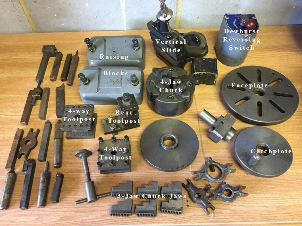

                                        #444411
                                        Steviegtr
                                          @steviegtr
                                          Parts aquired with latheCross sectionBackplatesSome pictures of what I have to work with. Going to Rufforth jumble on Sat morning so maybe pick up a 1 1/8" bsw tap. Bottom photo of rear of 4 jaw chuck with backplate undone. To discard. The slotted faceplate fits great, a keeper. The Large undrilled one is no good as it has a nose on the front which has the threads on it for the headstock. The only one that would possibly go on is the one with peg on but don't want to destroy that one. Looks like i'm looking for a backplate. No rush as the lathe is in bits awaiting the new motor, belts & control gear.

                                            Journeyman
                                              @journeyman
                                              Interesting and useful collection of parts for the lathe.
                                              Don't know what the items bottom right are and the plate in the centre seems to be the only candidate for a chuck back-plate but too big for the 4-jaw. Down the left hand side are a collection of tool bits, holders and centres which may or may not be useful eventually! Can't ID the item with the cross handle. The block with two round bits just above and left of the catchplate appears to be for offset turning between centres (possibly).
                                              As noted by Rod above the spindle nose thread is not BSW but simply uses the Whitworth thread form.

                                              Martin of Wick
                                                @martinofwick
                                                the one with peg on is a catch plate used specifically for turning between centres – likely will be tight because they are not used often (mine is and needs wringing on with lots of oil!). Should be left as is rather than turned into a chuck backplate.
                                                Suggest you check your spindle for burs flats etc if the catch plate is really getting hung up as opposed to tight – should go on as it looks like Myford type
                                                Difficult to see or assess dimensions but if the thread is 1 1/8 in and of correct 12W form, you can clamp it to the face plate and bore out the register in the 'nose; section to 1 1/4 in to fit the lathe spindle to make usable.
                                                I don't know if the backplate in the third picture from top between faceplate and catch plate is the 'large undrilled one' or just the one plate that you say fits.
                                                items bottom right are  lathe dogs for use with the catch plate when turning between centres'
                                                the backplate that you say is too big for the chuck actually requires machining to the correct size with the correct register to fit your chuck
                                                If you want another backplate, I would advise a new one from the usual sources rather than a used one (unless you can view and check over yourself). It will come as a threaded blank which you will have to machine to fit you chuck.
                                                Google  'The Amateur's Lathe' by  L Sparey on amazon and get a copy – you will find it very useful.

                                                #444435
                                                roy entwistle
                                                  @royentwistle24699
                                                  The large one with the nose on front is probably for mounting a chuck on a rotary table and I use a thread chaser to clean gunge from my chucks
                                                  The items bottom right are driving dogs ( ? ) for turning between centres

                                                    #444438
                                                      Posted by Journeyman on 03/01/2020 09:47:14:
                                                      Don't know what the items bottom right are …
                                                      They are driving dogs for use with the catchplate
                                                      … not the common style, but functionally similar.
                                                      Roy beat me to it … I was responding to page 1 blush
