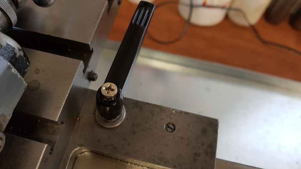

      Hi All,
      My S7 had the Hemingway saddle lock conversion fitted to it which worked well.
      I had to remove it when I fitted the DRO to the lathe and have managed (quite well…) without a saddle lock until recently when I noticed that some cuts were not so good any more.
      I still have the original small eccentric Myford part that goes under the rear rail and have made a 5/16" BSF bolt with a thinned head to fit this. I have also drilled each of the flats with a 3mm hole to take a small tommy bar that I can loctite in position when I have the correct adjustment.
      As there is very little room for access at the rear now the DRO is fitted I am having trouble holding the eccentric while I screw in the bolt and cannot seem to get it to lock the saddle.
      I think that this is because I have the small step on the eccentric wrongly positioned but cannot see which way round it is supposed to go. When I know this I thought I would drill the opposite side to take a small bar temporarily that I can hold while fitting the bolt to it.
      Which way round does the eccentric fit please?
      Cheers, Martin

          If you mean this one at the rear. I have had mine out a few times & can confirm they can be awkward to get in the right spot. I have turned the eccentric over with no difference to it's grip, but must admit there was a time when it just would not hold tight. Cannot remember what I did to fix it, … Ah remembered, the bolt was slightly stretched & was bottoming out on the threads. New bolt & handle & all was good. Also fitted the little cheap ebay handle to make it easier to use.
          Steve.
