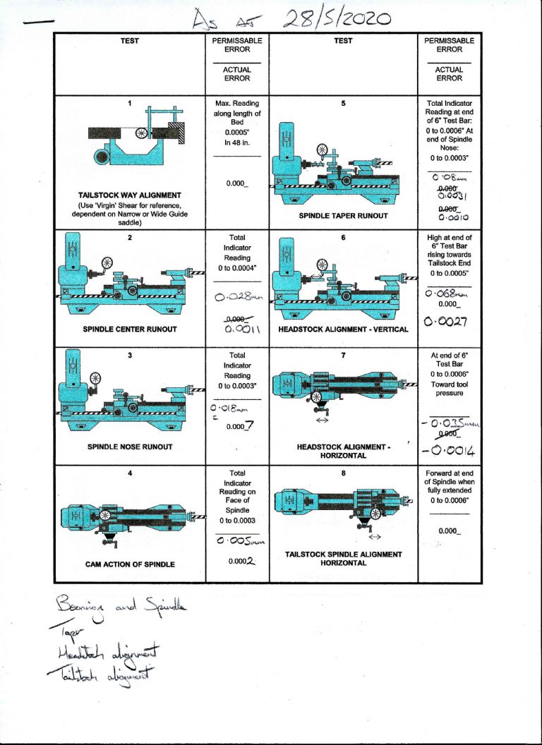

                              I printed a Myford alignment test sheet, and my tests have shown the spindle to be quite outside of tolerances, as follows:
                              As such, I don't think I can trust the accuracy of my spindle taper.
                              Do you have think the bearings may be worn, or need adjusting?

                                  I am a little confused by the XXX "mm" readings which in some instances are larger by a factor of 10, from what I would want to see, taking the 0.068 mm on the Headstock Alignment-Vertical as an example.
                                  Did you check the Test Mandrel for concentricity before you used it? It might be new but it would not be the first time I have experienced one that was wrong.
                                  Placed on dead centres in the lathe and spun by hand under a clock will prove this to be a good one, or otherwise. Clock at the small end of the taper, the large end, the plain diameter next to the lager end of the taper and at the tailstock end.
                                  There should be Zero error at any location, Plus the test diameter should be exactly parallel. If it is then I think you need to inspect the mandrel taper socket for cleanness and for any damage. As the spindle is hard there should be no damage, but you never know.
                                  I know of one individual who decided to try and drill out his spindle to take a larger bar. I had to internally grind the damage out so that the Morse taper would seat properly.
                                  During these tests above, have you tried clocking the mandrel with the belts under tension. Or have your checks been done in the free state? Too much tension will accelerate wear and if the spindle front bearing is out of adjustment then the belt tension will influence any readings.
                                  A clock on the mandrel chuck register will show if the belts are lifting the spindle as the belt tension is applied.
                                  Adjusting the bearings is not a hard thing to do, but I would like to see what the answers are to the Test Mandrel concentricity test as well as the mandrel taper socket, belt tension etc, before I say any more.
                                  Regards
                                  Gray,

                                    Well if it's a combination of spindle bearings and bedway twist the level will eliminate one of these.
                                    I don't think you have done a cut between centres on a test piece. Irrespective of bed twist or tailstock misalignment you should end up with either a tapered test peice or (unlikely) a parallel piece. Either way the testpiece should be 'straight sided) unless you have significant bed wear.
                                    I should like to see you set the bearings up properly first.
                                    Do it like this
                                    1. Power Down
                                    2. Remove all belt tension.
                                    3. Remove Chuck
                                    4. Rotate RH collar one complete turn. (top towards you).
                                    5. Rotate LH collar one complete turn. (top towards you).
                                    Spindle should be completely free of front bush.
                                    6.Loosen allen screw on collar at end of spindle.
                                    7. Using the Allen key tighten collar as tight at it will go by hand.
                                    Inner tapered roller races are now locked together with correct pre-load.
                                    8. Back off LH collar one complete turn + a bit (top away from you)
                                    9. Rocking the spindle by holding the spindle nose tighten the RH collar by hand (top away from you).
                                    10. When you feel resistance to movement stop.
                                    11. Collar should be just tight enough that spindle can just be moved by hand holding the nose.
                                    12. Do up the LH collar by hand (top towards you).
                                    You should still feel resistance when turning the spindle by the nose.
                                    13. With the crescent wrench on the LH collar tap the end smartly with a 12oz hammer.
                                    The spindle should move forwards by a couple of tenths and be completely free running.
                                    14. With the lathe running slowly (lowest direct speed) put the oil gun in the front oil cup and pump until oil issues from the front bearing.
                                    This is how Myfords used to set the lathe up.
                                    regards Martin

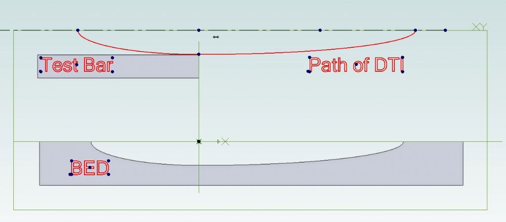

                                        The point I was asking was where does the "0,068 mm" come from when there is another entry written below on the Vertical Alignment Test which is more in keeping with the required dimension which Myford stipulate.
                                        As regards the "5 thou", I take this to be wear across the bedways and as such will have very little effect on the vertical alignment. Yes there is a measured 0.0025" wear on the bed surface but as this wear only affects the tool height it will not give the effect to the barrel shape that has been found. It might have some effect on the Vertical Alignment if the saddle was under a loading similar to that imposed by a turning tool. In the free state I think the error will not be worth worrying about.
                                        The wear to the vertical face will not extend completely down the bedway, otherwise the lathe would be turning parallel. Thus by using the setting bar technique and running a clock along the side there should be an error which replicates the wear. However there should come a point along the setting bar when the clock reads a fairly constant reading.
                                        Further if a clock is mounted such that the carriage is only working on the less worn portion of the bedway then, the clock should read pretty well zero along its length, provided there is no twist.
                                        My concern at the moment is that there is a twist in the bed, coupled with a semi floating spindle, combined with too long a test piece. Unless the problem is approached in a logical manner then Mike might as well role a dice and pick just any of the replies.
                                        Regards
                                        Gray,

                                          I'm wondering how worn or loose spindle bearings could move to allow both the near & the far end of a test-piece to be cut narrower than the middle portion. indecision
                                          Martin.

                                            Yes most definitely. You must. Given the wear on the bed, the bearings are probably similarly sloppy. The bearings should be adjusted as posted by Martin Kyte above before any attempt is made at bed alignment. Otherwise you are trying to align to a moving object. Impossible.
                                            All readings and test results so far are invalid if the headstock bearings have excess play in them. When you said in your OP that you were overhauling your lathe and were now doing the bed alignment I assumed you meant you had already set the headstock bearings to tolerance, as this is the normal sequence of events in lathe overhaul.

                                              The two readings on all tests are simply Metric with Imperial below 0.068mm and 0.0027", ones with more are as readings are taken at two places along the bar.
                                              As the DTI is mounted on the carriage or may be held in the toolpost and the wear is likely to be in the 6" nearest the chuck I can't see how it can be moved in a perfectly parallel plane to whats in the spindle, even if wear is side ways unless an elephants foot is being used the dti may not stay on the crest of the test bar
                                              Sketch below shows an exagerated bed with wear and the test bar. As the dti is moved along the bar by the carriage it will dip down as the carriage follows the worn bed and give a +ve reading as the resulting 0.068mm shows. which at 0.0027" is very close to the quoted 0.0025" bed wear, if I were to revolve that red line about the lathe axis you would actually get a barrel shape
                                              Edited By JasonB on 30/05/2020 07:33:04

                                                Thanks for explaining the dimensions, I would have liked to have heard from the OP.
                                                I was aware the DTI will not stay on the crest of the bar, due to the wear across the bed ways. The amount of "drop off" on the Clock will depend on two things. The diameter of the test bar and the distance moved off centre, let us assume it to be the full 0.005". Simple Pythagoras shows that for a 5/8" test bar the clock will drop 0.00004", too small for me to worry about and a mere fraction of the error found. (It would be less again with a larger diameter test bar.)
                                                What we are not told, and which would be extremely helpful is how this wear progresses down the bedways. The 0.005" could be over just the last 2" of the bed nearest the headstock. It could however be over 10", we are not told this.
                                                This is why the bar test method mentioned initially would show up this wear. Plus as I said earlier, If the the clock is so arranged that the carriage is operating on a less worn part of the bedways then the OP would be avoiding the severity of the wear and proving that there is, or is not, any twist present.
                                                This is also why I initially mentioned the use of the Engineers Level as my first choice. As this method does not involve any machine movements and wear can be very simply compensated for.
                                                Once twist is ruled out then we can move on to the other checks. An un-twisted bed should give 0.010" taper during the turning test, if the 0.005" wear is progressive down the bed. If it is isolated as I suspect, then there might be a very different answer.

                                                    Many thanks for all your posts and sorry for the confusion with the readings – I only have metric indicators, hence the conversion.
                                                    Gray: the test bar has been ground to 0.671", though I will double check its accuracy later
                                                    I set up the headstock bearings to the best of my ability a few months ago, having made a peg spanner as a little lathe project. However, as I'm no expert and I'm learning as I go (and doubt many things I do!), I'll do the bearing setup again, following the instructions to the letter and take further measurements after.
                                                    Mike
