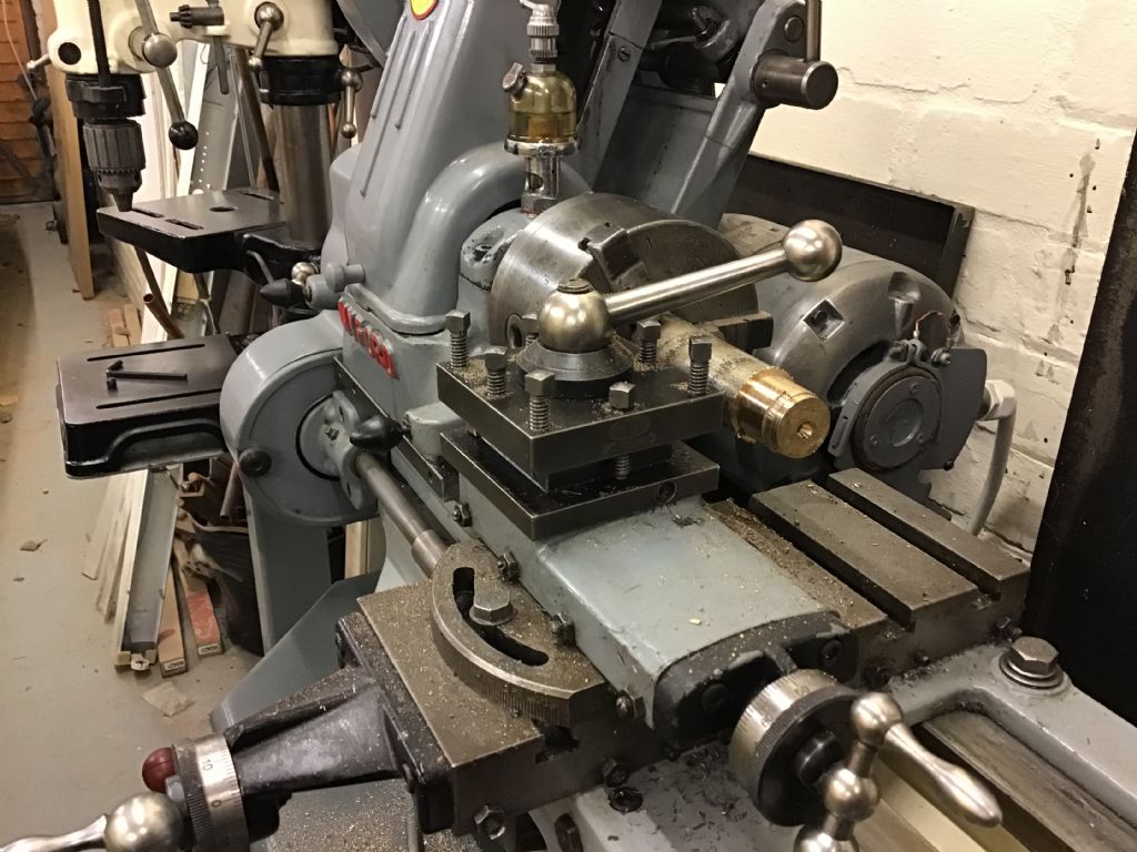

          That's odd. The 4-way original toolpost on my ML7 was made to hold 3/8" toolbits. So 8mm would fit no problem, in fact needing some shims under them.
          But it was holding 10mm insert tooling about 20 thou too high. So I milled 20 thou off the bottoms of the recesses where the tool bit sits and all works fine now. I did the milling in the lathe, holding a 1/2" end milling cutter in the three jaw lathe chuck and packing the toolpost up on suitable blocks and shims until I got the exact height I wanted.
          Sounds like you might have a different toolpost if 8mm is causing problems. But the fix could be the same.

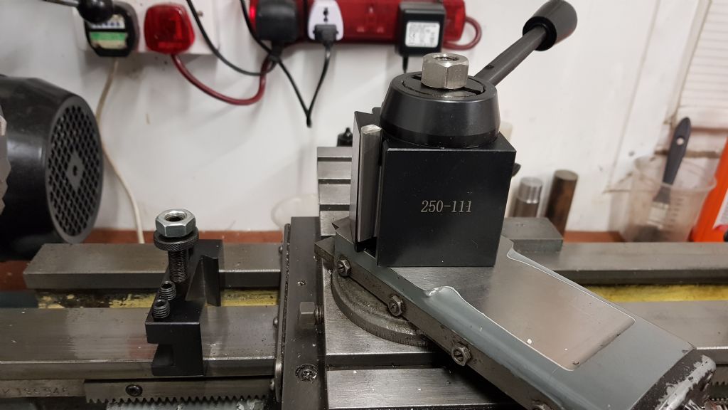

            I am not sure of your toolholder. I have a couple that came with the myford super 7 . they are just a square block of steel with the 4 slots for the cutters. It is the bit about the ball bearing in the bottom i don't get.
            I fitted a QCTP to mine & the height was above what was required. I took my top slide.(Compound) to the engine grinders in Castleford & got them to surface gring 3mm from the top face. Now i have the ability to use up to 16mm cutters. Picture of mine & a link to myford site where they show the slides for the ML7.
            Steve.

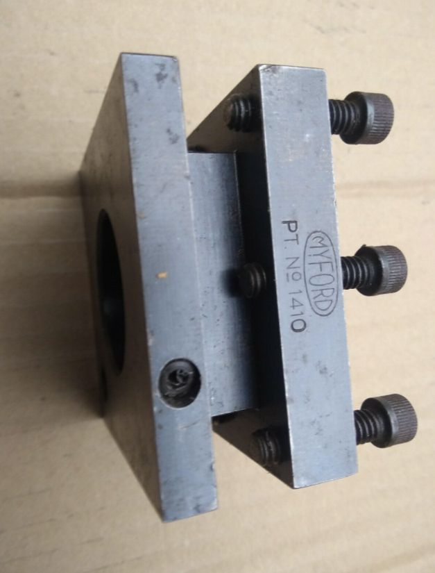

              PS looking at the internet and past threads on this forum for Myford 1410 toolpost it looks like Myford have sold a few different versions over the years, some of them in later years perhaps supplied by outside aftermarket sources so there may be some variation.

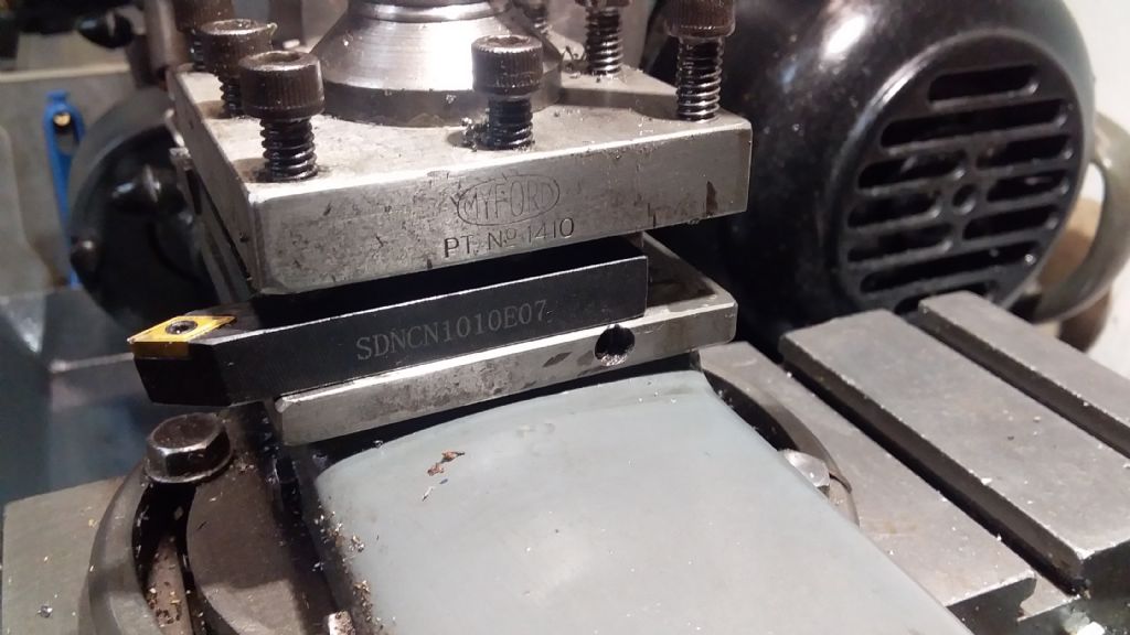

                        You've got me intrigued now. Below is a pic of my 1410 toolpost with 10mm tool in use. The thickness of the bottom section below the tool is now .290" (7.4mm) since i machined about 20 thou off it to fit the 10mm tooling instead of the 3/8" it was previously used with.
                        That is rather thin now that Howard mentions it but they all look a bit that way in pics online. And my base was concave by a few thou when I got it from its extremely abusive previous owners ( a squad of electricians in a motor rebuilding business, not machinists.)
                        I wonder if you could measure yours by comparison because I am wondering if the previous owners had already machined my toolpost down to fit larger tooling? I had always assumed it was factory standard, but perhaps not.
                        I think i milled out the slots rather than just take a facing cut across the base because then there would not have been clearance on top of the ratchet gear that sits in the middle of it. I'm quite happy with the result and it seems to work well. Just need to be careful not to overtighten the tool clamping bolts and distort the whole thing. I do find such parts on the Myford more flimsy than on my old M-Type Drummond so take due care.
                        I did try machining the bottoms of toolholders but they were hard and tough and I think would need a carbide end mill which I did not have at the time. Could not do a good job on them with a HSS milling cutter. Just skated all over the place instead of cutting.

                                How strange. And it's come up before. In this old thread there appear to be 3 Myford 1410 tool-holder owners, all with good reason to believe they have the genuine Myford item, but different dimensions.
                                DC31k suggests measuring the compound slide and saddle. Maybe Myford updated their kit a few times over the years and the holder comes in various sizes to suit?

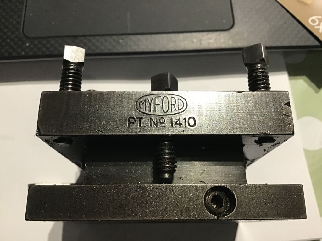

                                  Hi Hopper,
                                  Just reading your post again and realised that my wires were crossed as you clearly state that you skimmed around 20/thou off, whereas I had confirmed what you already wrote! Sorry…
                                  Just for the record mine is 9mm thick at the bottom section of the toolholder.

                                            Thanks for the measurement. Yours definitely looks to not have as much meat above or below that plunger hole as mine did before machining, or the one in the generic pic posted earlier in the thread. As your thickness is 9mm, exactly 1.6mm or 1/16" more than mine was before machining, it may be that Myford made these with two different thickness bottom sections to suit 5/16 and 3/8 tooling respectively. Interesting.
                                            You should be able to dress that bottom surface and the top of the top slide with a 10" flat bastard file. File evenly from one direction, then from 90 degrees to that in order to get a flat finish. You can then rub the surface on some emery paper on a sheet of glass or the table of your drill press etc to get final flatness and finish. Use a figure 8 motion when rubbing to get an even finish.
