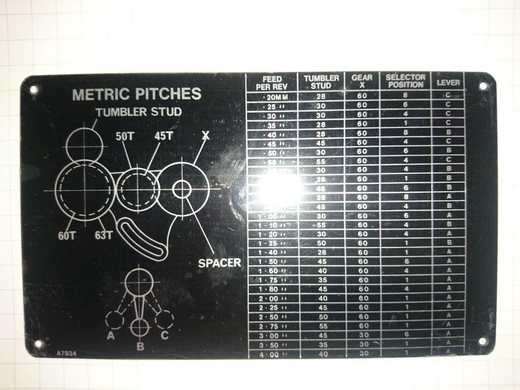

                      #511238
                      Chuck Taper
                        @chucktaper
                        Picture below should speak 1k word.
                        I was going by the first paragraph.
                        "ega said:
                        It may be that you need the answer to your question more than you need the 1481/1!"
                        That's it exactly.
                        Was it simply one gear wheel dropped or was the overall mix of the gear set altered?
                        Regards
                        Frank C.

                        #511244
                        Michael Briggs
                          @michaelbriggs82422
                          If the 1481/1 is the same mix as the 1481 but less one gear, you would be able to use either set with the above chart.
                          Michael
                          #511245
                          ega
                            @ega
                            Chuck Taper:
                            I speculate that Myfords decided that they could get the job done with fewer change wheels.
                            As is well-known, any given ratio can be achieved in a variety of ways and to varying degrees of accuracy.
                            The last paragraph is intriguing, the inference perhaps being that 1481 was for an earlier gearbox. There are far more knowledgeable members than I here and maybe they will be able to comment.
                            I take it that there is no date on your paperwork which I suspect is relatively old.
                            In the meantime, I shall be comparing your chart with the one in my own machine.

                                  #511616
                                  Simon Williams 3
                                    @simonwilliams3
                                    Brian – good afternoon.
                                    Is it as simple as the 1480 kit suited the old Mk 1 gearbox, and the 1481/1 superseded it when the later (double speed) gearbox was marketed? Or is that too simplistic?
                                    I'm trying to think if I've got enough information to follow this through and check the arithmetic works out right.
                                    I believe that this is the diagram for the 1481 kit:
                                    And the label issued for the 1481/1 kit looked like this:
                                    I'm fairly sure (but haven't dusted off my notes from the last time we visited this) that the newer kit needed one less changewheel to achieve the same result. Which could, of course, have been the reason Myford decided to update the kit.
                                    Best regards Simon

                                      #511651
                                      Brian Wood
                                        @brianwood45127
                                        Hello Simon and Frank C
                                        I think between you both this has cleared things up.
                                        For Frank's benefit as the information may be new to him, the early gearbox had an outrigger housing on the saddle side containing two 18T gears and an idler linking them [to correct rotation on the leadscrew] The necessary reduction of 1:2 to make the gearbox work was provided by a 12 tooth gear driving the outside gear train.
                                        The later gearbox has instead a 26/52 reduction built into the left hand side of the gearbox, the 52 gear is coupled to the leadscrew which is brought right through the gearbox. All this is largely hidden behind the plate that the cover is hinged from and the outer gearing driver tooth count is now 24. That gear is case hardened..
                                        The later gearbox also sports hardened gears and engagement dog clutches, altogether a more robust piece of equipment.
                                        Regards to both
