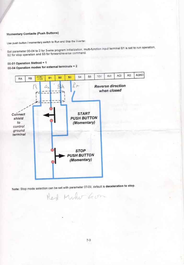

        #577238
        Clive Brown 1
          @clivebrown1
          This is one of the diagrams I used for the remote panel for my Teco510 a while back. All components from Inverter Drive Supermarket. They seem to have now removed this particular pdf.
          Pencil refers to my own wiring colours.
          #577239
          Roger Davies 4
            @rogerdavies4
            Thank you Clive. I think that’s what I’m aiming for. Moat grateful.
            Roger
            #577311
            Roger Davies 4
              @rogerdavies4
              So thank you all for your help. I sat down this morning and went through every parameter, top to bottom. I then did a factory reset… on then returning to the 00 parameters, they were wrong, and would not change giving loads of error messages…. Very frustrating. I almost gave up. But I persisted, reset the motor parameters at 02 and on returning then to the 00 parameters was allowed to change them. Lo and behold (its christmas!) the lathe the ran in the right direction. I can control from the remote stop and start buttons, and the fwd/rev switch. The only thing that isnt working yet is
              #577312
              Roger Davies 4
                @rogerdavies4
                the potentiometer on the remote, but the one on the vfd works for now. I’ll return to that in due course. Thanks to all for your kind help, suggestions and support.
                Edited By Roger Davies 4 on 29/12/2021 16:11:42
                #577313
                Roger Davies 4
                  @rogerdavies4
                  So,for the record the answer to my problems was:
                  1. factory reset
                  2. enter motor parameters (correctly) at 02.
                  3. Only then set the 00 parameters.
                  doing 00 before 02 doesn't work.
                  Roger
