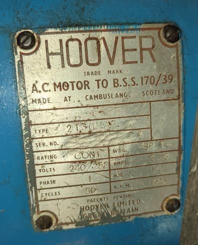

      Hello, I'm new to the forum. thanks for taking the time to read my question.
      I want to try my hand at model engineering. In order to do that I need a lathe, I bought a Myford ML7 on eBay that used to belong to a bagpipe maker in Edinburgh. It's a bit tired and painted a nasty blue colour
      It has a 13 amp plug on the wire to the hoover motor, nothing else. I read somewhere that it needs a proper switch in order not to damage the motor. I tried a while ago to run it and it seemed to work ok but I'm concerned that I'll damage the motor. Also I want something a bit more refined than thumping a 13amp plug into a socket to start the lathefrown I tried it again recently and it blew the circuit breaker for the garage, I think because I hadn't run the lathe for a while and the motor was a bit sticky.
      It's a Hoover Motor type 2130 HAE, 1 phase 50 cycles, WDG (winding?) SP PH 3.6 Amps 1/2 HP 1425 RPM.
      **LINK**
      I know very little about electrics but I'm a reasonably competent mechanic.

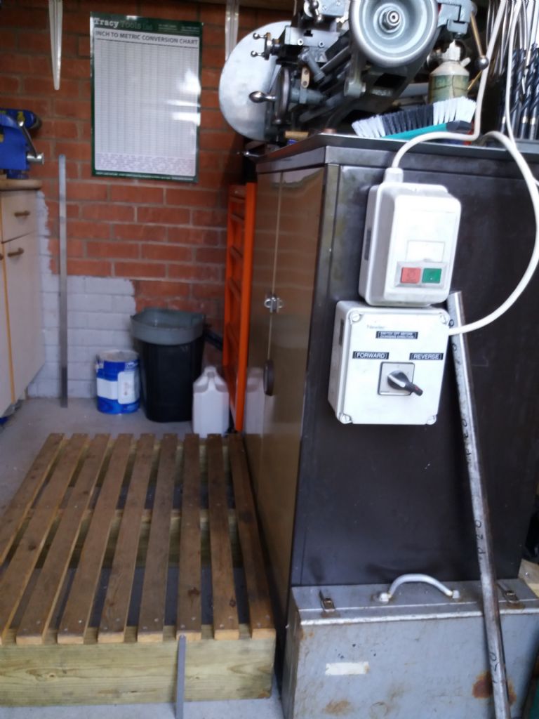

                        Hi Alan the Dewhurst switch was to enable you to run a machine in reverse when needed ie screw cutting. I have wired my lathe with a no volt push button switch as well as the rotary switch to change direction. Don't try to change direction whilst the lathe us still in motion as it may not change direction as you may think it should. When I change direction my no volt switch disconnects as it is wired through a spare contact on the rotary switch and needs pressing to restart motor in selected direction.

                          You really should have a No Volt Relase switch between the plug and the drum switch.
                          Nowadays, Drummond type drum switches are none too popular, because of the lack of the NVR feature.
                          If you search back through previous threads, you will find wiring diagrams for the Drummond switch.
                          (Somewhere I have probably got one! )
                          To safeguard the contacts in the drum switch, it is worth stopping the motor with the NVR switch before stopping or reversing the motor with the Drum switch. This procedure will prevent the contacts being burned by arcing.

                                        Unlikely to be a shaded pole motor.
                                        Those fully enclosed "square" Hoover motors were among the best quality mass production single phase devices. You won't find anything approaching that quality at home shop guy affordable prices today.
                                        Odds are that any problems are due to the centrifugal start winding switch inside.
                                        Best thing about those motors is that they were primarily designed for domestic and low end industrial appliance duties. Washing machines and the like. So not only are they well sealed but they also have a lower start current surge than most motors.
                                        Well worth an investigation to see if any problems are simply resolvable. I'd not greatly worry about winding insulation. Voltages between adjacent coils in the windings are small. Flexible flying leads to the tag board are the main offenders as aged rubber insulation tends to flake off. Especially when disturbed.

                                            Hopefully, when you switch off, and the motor runs down, you will hear a click as the centrifugal switch makes contact again, ready for the next start up.
                                            The switch takes the start windings out of circuit as the motor runs up to speed.

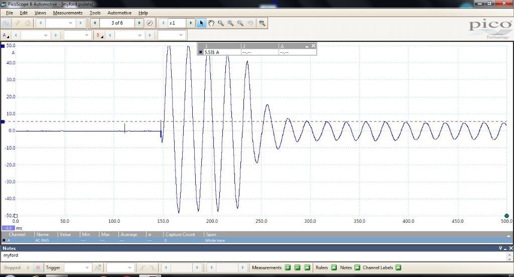

                                                  Hi,A 1/2 hp Brook motor on an ML7 takes nearly 50A for 100mS on start ,this will sometimes trip a domestic mcb but probably wouldn’t trip an inductive load mcb ,as previously mentioned .An earth leakage fault would trip the elcb not the mcb.
                                                  trace

                                                    Maurice, I'm interested in your scope setup. I'm familiar with the picoscope as I have one myself but never seen or used the automotive one. Are you using it with a clamp meter probe? I have a clamp meter but not for the scope. If I needed current logging I might use a current sense resistor and do it that way.

                                                      Thanks for the ‘scope print-out. You seem in much agreement with me – where I also clearly pointed out that it was an overload trip and not the RCD. An RCD trip would have sounded alarm bells for me as any imbalance would likely indicate a leakage to earth.
                                                      All the evidence ( ‘I think because’ was a very speculative suggestion with no actual evidence supplied – I took that to likely mean it could have been the whole lathe that was stiff, not necessarily just the motor) indicates the motor is likely in fair fettle, but possibly needing maintenance.
                                                      A good earth connection (readily checked with a normal DMM) should protect the user in the event of leakage, but a resistance test for the motor is, of course, the far better option – as long as the motor windings are completely dry, of course.
