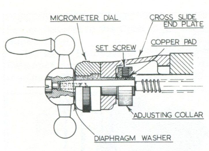

      I turned a shaft down for a machine that needed one. The long main section (20mm dia) had some irregularities in the finish, almost as if the set up wasn't rigid enough.
      I started looking at the cross slide in more detail and stuck a DTI (referenced from the lathe bed) and discovered about 0.06mm in and out movement on the cross slide. By that I mean movement to and from the operator so perpendicular to the bed.
      We started paying with the adjusting collar on the cross slide spindle (see pic).
      Now for the newbie questions:
      1. Is this collar to remove backlash and make the in and out positioning of the cross slide more consistent?
      2. Am I right in concluding that this collar, if not correctly fastened will result in the cutting tool being pushed back the same distance as the backlash in the screw?
      3. If I tighten this collar and remove almost all of the above mentioned 0.06mm I cannot turn the crossfeed handle at all. Is the trick making a compromise between ease of operation and trying to eliminate backlash?

          Adjusting the collar will take the backlash out of the cross-slide bracket/leadscrew interface with the proviso that as it needs to turn freely it will need some clearance. It can do nothing for the backlash between the leadscrew nut and the leadscrew.

                Hi Mark, in answer to your questions Q1 the collar will not alter the backlash between the feed screw and the nut it is there to adjust the the "play" on the end plate and act as a thrust bearing when retracting the cross slide, 0.002" is acceptable and you cannot remove all the play. So No it will not affect the positioning of the tool for the cut applied.
                Q2 answer is No! the cross slide is pushed towards the work by the feed nut and the adjusting collar will not be in contact with the end plate during a cut.

                  Backlash is a fact of life on practically every manual machine, and you just have to get used to countering it as second nature. If you try to remove it all – and Myfords give you more capability than some of doing so – you'll find the hand wheel will bind in places and be quite unpleasant to use. You have to arrive at the compromise that suits you best.
                  Make a habit of ensuring it's taken up in whichever direction makes sure that the slide movement will equal the handwheel movement. Sometimes if the cut's so light that the handle rotates the wrong way under gravity, use the slide lock very lightly just to provide enough friction to prevent that losing your position.

                      Is that illustration from Bradley's Myford manual?

                        I understand that it won't change the backlash, thanks Martin and JohnF. My understanding on how it works was flawed but it is slowly becoming clearer now.

                        @ega, I found the illustration when Googling "Myford Super 7 cross slide friction" and came across it on another board. I am not sure who's illustration it is, sorry. I will look into that book and dito washer!
