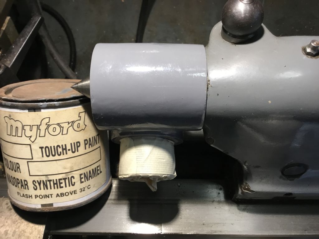

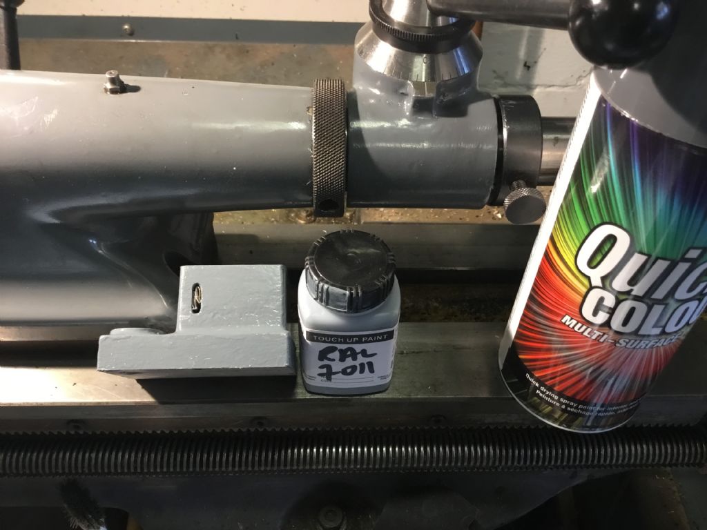

                  Ah . . . , 50 Shades of Grey!
                  Recently acquired a tailstock rack and although the mounting casting was a shade of grey, it didn't match my lathe.
                  Dug out a tin of Myford Grey enamel which I'd had for years, gave it a good stir and put on a coat – nothing like!
                  Looked online and ordered a tester of RAL 7011 'Iron Grey' – as on my rear toolpost casting – nothing like . . .
                  Ended up using a tin of spray paint from B&Q 'Dark Grey' best match so far.
                  Still not quite right but it will have to do!
                  I think the paint must age with all the gunk in the atmosphere.

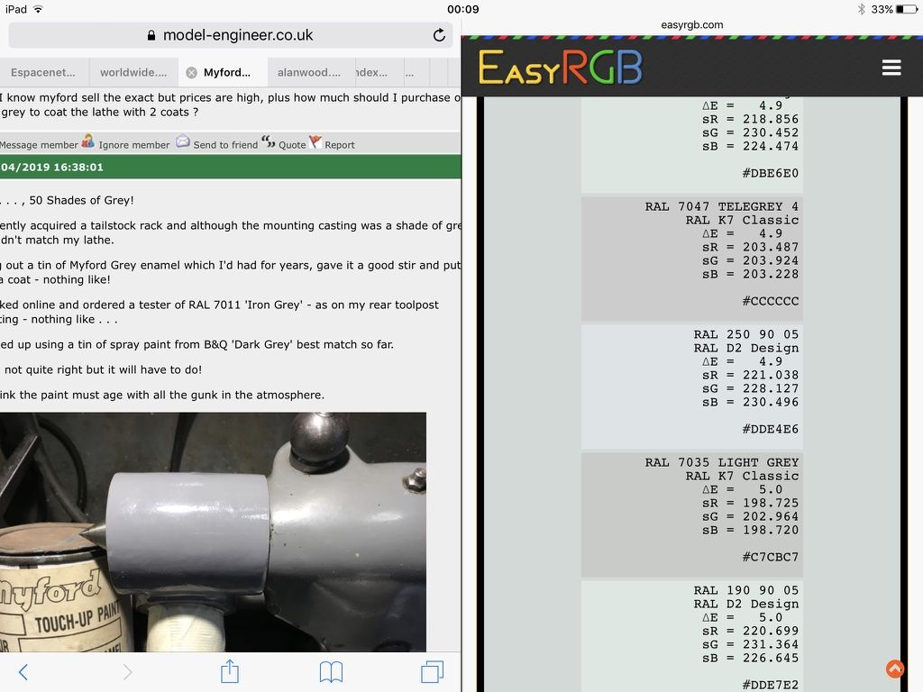

                    Allowing for my tired old eyes and the vagaries of of colour reproduction on computer screens it doesn't look anything like the correct colour to me. Have you looked at lathespares.co.uk they do Myford grey at not quite half the cost of buying from Myford? No connection just a satisfied customer, I found the paint an excellent match and easily applied.

                            This might be useful: **LINK**
                            http://www.easyrgb.com/en/match.php#Result
                            Edit: Here's my first try …
                            Edited By Michael Gilligan on 11/04/2019 00:15:49

                              Thats an interesting site and maybe worth a try in future yes
                              Problem is, with the cost of paint now, and having spent £25 + so far, I would need a guarantee that it would match!

                                    That's s good calculator for code. Going of your photos 7011 seems dark on the colour swatches however when painted on peters piece it seems very light in shade. Going of that as an example maybe dark admiralty grey 18B25 would be just right. The question now how much in quantity? Dont want to spend a fortune on paint but obviously dong want to run out either the quantities are 500ml, 1ltr, 2.5ltr and 5ltr would a ltr do 2 coats of a myford m type ?

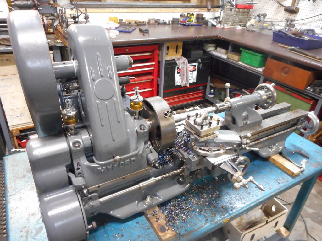

                                        Here's my ML7 painted in what the local paint supplier mixed as RAL 7011. In real life it looks darker than in this pic (on my screen anyway!), and darker than the original paint that was on the machine. But who knows how faded that was? It was in very poor condition from a lifetime in the tropics, which is rough on paint and just about everything else.
