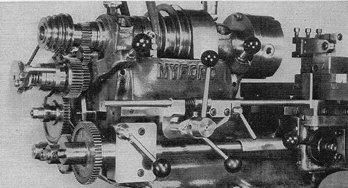

        Myford & reduction gearbox

            We've got a Drummond project for Hopper on ebay atm
            #630055
            IanT
              @iant
              Martin Cleeve made a similar reduction gearbox for the EW lathe. It allowed a slower saddle feed than might available with the usual screwcutting gears. Also, saved some effort & time when swopping between screw-cutting and (fine-feed) turning.

                        Hopper
                          @hopper
                          That thing was on eBay a while back, for I am sure a lot less money, posted as some kind of watchmakers attachment or something weird like that. Couldn't work out how it worked then, now seeing the pic of it set up for fine feed it is certainly the most deluxe fine feed arrangement you could get for your Myford.
                          I reckon you could make a modern version using the three speed reduction gearbox out of a discarded battery drill. Hmmm….

                          Baz
                            @baz89810
                            I am sure that with changewheels or a qc gearbox a minimum feed of two thou per rev can be achieved, therefore what do you need this overpriced accessory for? Unless of course you really need very fine feeds.

                              John Haine
                                @johnhaine32865
                                Stupid price, silly accessory in this day and age. AAs mentioned, an old drill, or a stepper would be cheaper and better!

                                  As discussed previously …
                                  I think the box on ebay derives from Martin Cleeve’s design: which was brilliant in its time

                                          Martin Cleeve's gearbox enabled him to switch quickly from screwcutting to fine feeds.
                                          I suppose it depends what you mean by mad, but he earned his living with his lathe.

                                                    Inspired by the articles in ME, I built a two-speed leadscrew drive for my Myford 7R. Swing the new banjo up and it meshes with the tumbler reverse output gear for screw-cutting, swing it down and it meshes with with a belt driven worm wheel for fine feed. It all fits inside the original change wheel cover. No messing with oily gears, as required with a QC gearbox. There are some photo's in my album.
                                                    Just as Martin Cleeve promised, it saved a lot of time when making fasteners, for bike restorations.
