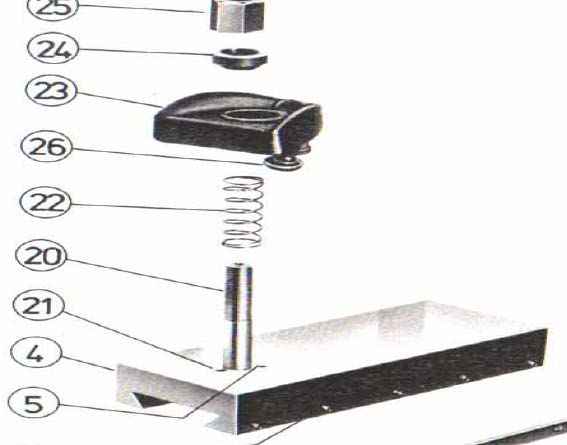

      I need to replace the tool post (or "tool clamp post" ) and see that there are 3 grub screws around it in the compound slide. Their points bear on the top of the tool post foot but don't screw into it. What are they for?

        #621389
        ega
          @ega
          Presumably, as with the Sevens, they are for the four way toolpost ratchet.
          #621393
          Dave Sawdon 1
            @davesawdon1
            I haven't owned a "7" so don't know what they're like. The grub screws are item 5 in this extract from the 254 parts manual and described as "grub screw – plug" – so are they just plugging holes that can be used by the 4-way toolpost?
            Mine has the standard clamp, as shown in the picture, but I have a size A Multifix tool post and it looks like this will fit if I sleeve the "clamp post" … but first I need to replace the bent clamp post!

                4Way toolpost ratchet screw holes
                #621400
                bricky
                  @bricky
                  definately for the ratche base of the four way toolpost.

                    Thanks everyone. I'll be using a Multifix size A toolpost (subject to checking tool height range) so will need to drill a couple of holes for the dowel pins but then will put the grub screws back and stop thinking about them.
                    (Steviegtr: they are in tapped holes in the compound slide but don't penetrate the foot of the tool post. There's a single steel pin to prevent rotation)
