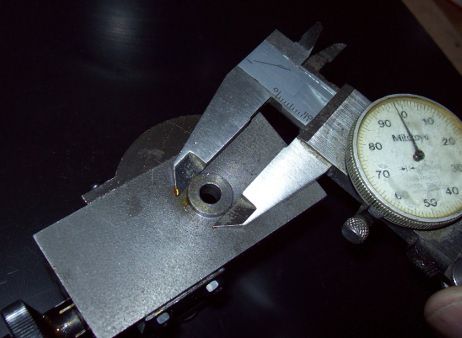

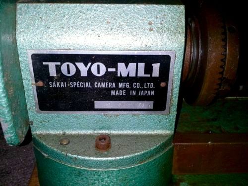

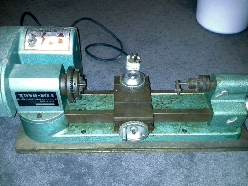

      Purchased off Ebay for £285 plus shipping. Swiss Army knife shown for size comparison.
      I've already cut stainless steel, brass, ABS and nylon. In fact the stainless was being reduced within 10 mins of unboxing at home. (I always have important stuff delivered at work, as I once found eight quids worth of high speed RAM sticks under the bush by the door!!)

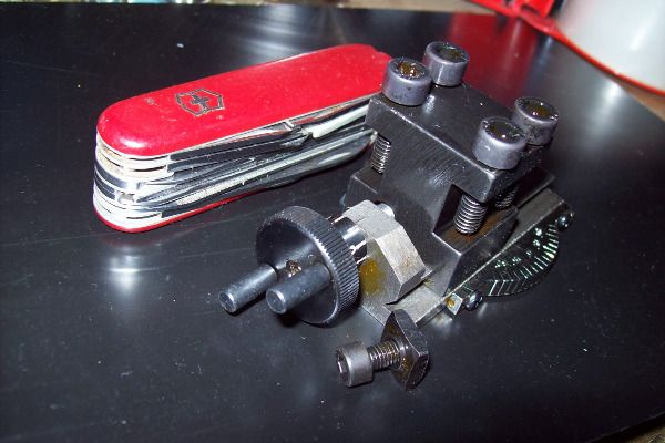

      Oh, and this arrived today, from Axminster Tools
      Axminster SIEG C0 Compound Slide
      The locator on the underside is too big, so I'll have to modify it at work. 12mm dia with the T slots being only 8mm.
      The T slot nut is rubbish as it's been tapped at an angle to it's own flats! So I'll be making another. Ironically, it has an 8mm locator flange, unlike the slide base!
      This item is new, the red/orange bits here and there are what remains of the storage grease that I mostly washed off in the parts wash.
      I'd really like a quick adjust tool post, but beggars can't be choosers at this stage.

        This little beauty will be a work in progress as I add to it.

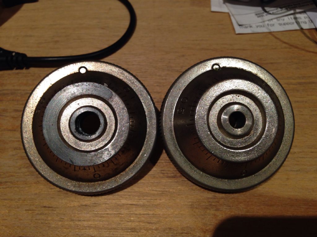

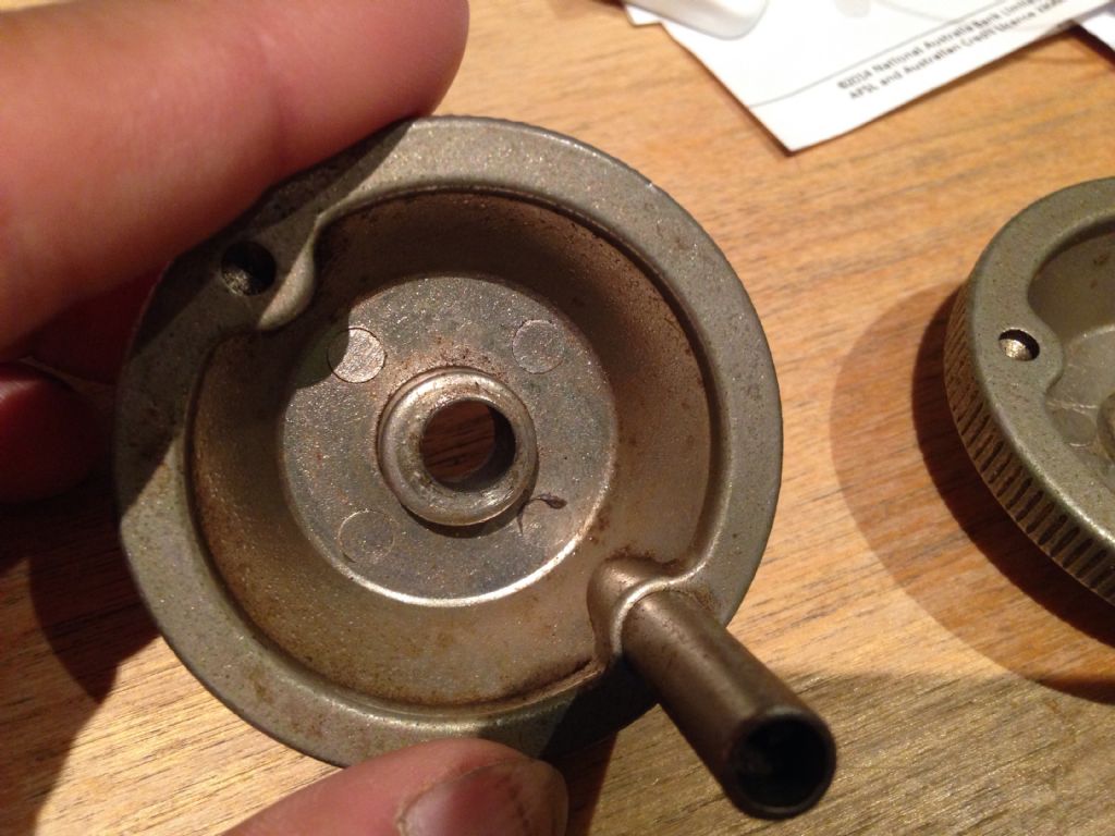

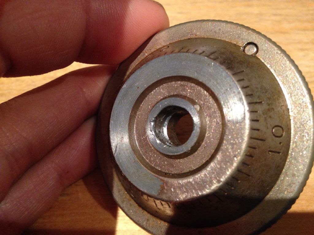

                        Both of he the handwheel for the carriage has no threading. As shown on picture one of the wheel is placed on the carriage.

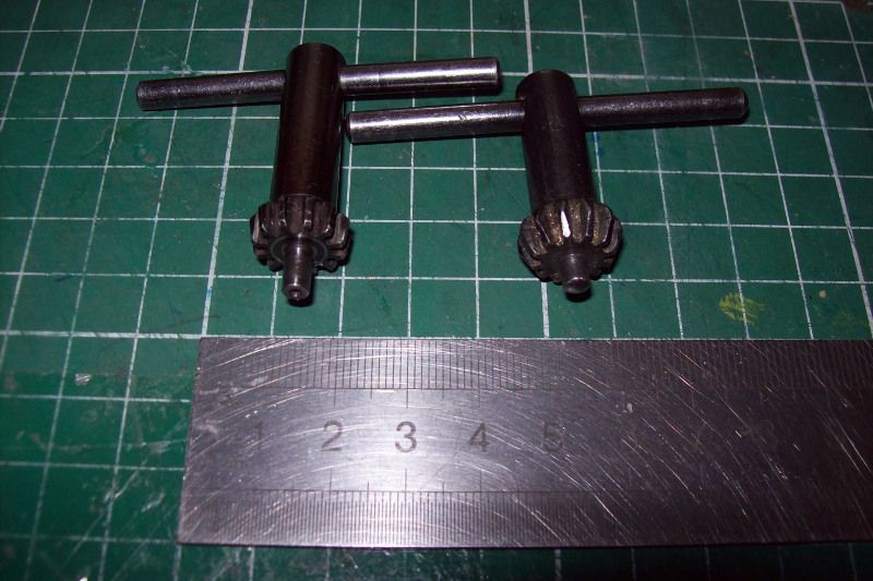

                        I am also wondering what sort of Chuck key I could use, since it is also missing.
                                Apart from that, it runs quite silent and smooth.
                                Curse you for saying it's quite silent! Mine isn't. sad
                                I have two chuck keys and although they look different they both seem to work the main chuck and the drill chuck ok.
                                The handwheels have no M6 internal thread?
                                In that case I would bore them out to around 9 or 10mm, reduce the face that touches the carriage by 2mm and make up a top hat sleeve with a 2mm brim plus M6 internal and press them into the 9/10mm bore, with the 2mm brim replacing the material that was removed.
                                If you don't currently have access to another lathe, I'd be happy to make 'em for you. We have a small hand press at work, so I can make them a friction fit and press them in. Problem solved mate.
                                Drop me a PM if you need to. face 1

                                          Both my chuck keys have 12 teeth, a 15mm diameter and a just under 4mm dia pilot (nose). They do look quite different, but both work in the lathe chuck. I'm guessing that the one on the left is the original. I can't imagine that Toyo Sakai would not have followed standard available specs for this sort of thing.

                                            Thanks for the chuck key photo, and counting the tooth That would make it easier for me to find it.

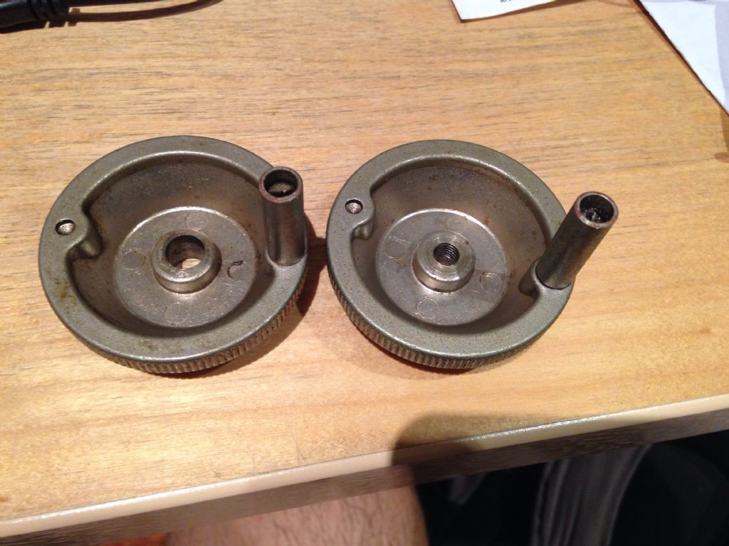

                                            The handwheel is a bit of an issue, hence the fun.
                                            The one on the left is the one without threading. As you can see, it is drilled off center. I could understand that perhaps the previous owner can't find the center when drilling, and perhaps he shouldn't use a drill.
                                            It seems the new hole is drilled from front and back, and it doesn't meet. On the picture 4, the close up shows where the two holes meet. They seems to be drilled different size too, the hole from the back it's 8.95mm, and from the front is 8.33mm. What is your suggestion? Still able to be saved?
                                            I am wondering if the numbers on the handwhe iel is important at all to be line up or where it should start, but I guess getting the wheel attached to the carrier is more important now.

                                            #177586
                                              Posted by elixir oliver on 28/01/2015 11:05:18:
                                              … It seems the new hole is drilled from front and back, and it doesn't meet. On the picture 4, the close up shows where the two holes meet. They seems to be drilled different size too, the hole from the back it's 8.95mm, and from the front is 8.33mm. What is your suggestion? Still able to be saved?
                                              [that was addressed to Pete, so I hope you don't mind me jumping-in]
                                              Take it steady, and this should be a reasonably simple repair.
                                              First thing is to bore the hole out to some reasonable size.
                                              [Centre it by refererence to the outside diameter of the wheel]
                                              Edited By Michael Gilligan on 28/01/2015 11:54:20

                                                btw, I'm quite impressed Pete was mentioning boring it out to 9mm – 10mm. yes Well, that goes to experience.
                                                Mike, or Pete. Do you suggest I bore that with a lathe? I supposed anyone with a big enough chuck could do it.
                                                Cheers
                                                #177589
                                                  Posted by elixir oliver on 28/01/2015 12:08:14:
                                                  Yes, bore it in the lathe
                                                  The Toyo should be adequate if you can mount a suitably sized block of wood or plastic [do you have a faceplate for it?]
                                                  … Just bore a recess in the block and push the handwheel into it.
                                                  P.S. … No offence taken, but I do prefer to be called Michael.

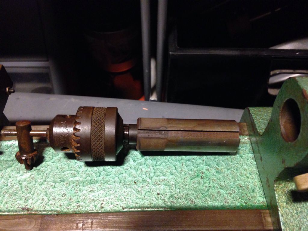

                                                    I tried to take out the drill chuck today, wedge a piece of timber behind the chuck and whack it with a mallet (By the way, is that the right way of removing the chuck?). The tailstock spindle slides out, so I just spin the rest of the barrel out. Now the chuck is still attached to the spindle.
                                                    #177687
                                                      Posted by elixir oliver on 29/01/2015 12:37:11:
                                                      No promises, but: That looks rather like it might be a "self-ejecting" barrel.
                                                      Try putting it back together and winding the barrel back … it may eject the drill chuck.
                                                      … If that doesn't work before it all starts to feel wrong, stop, and we'll think again.
