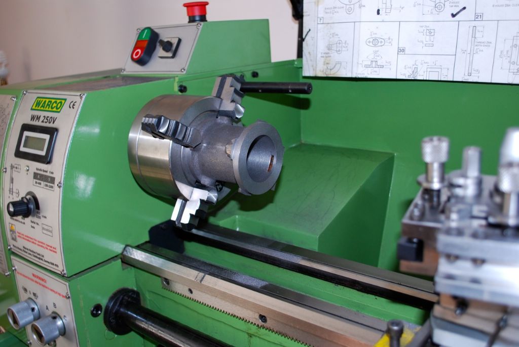

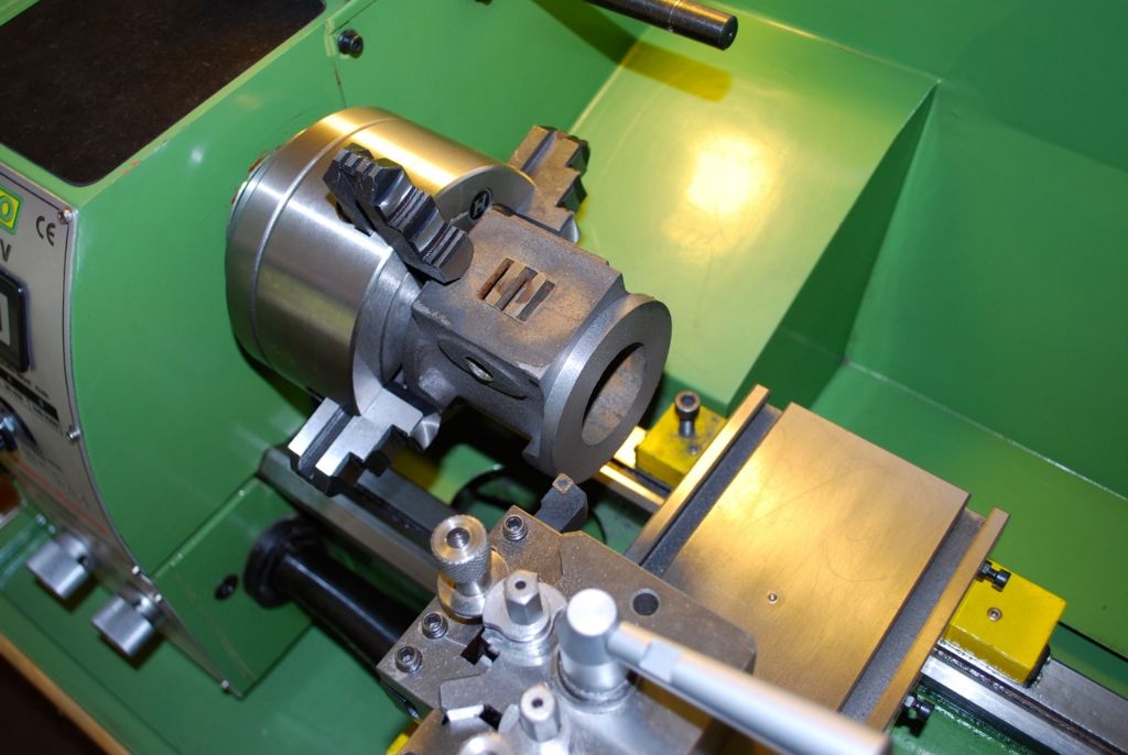

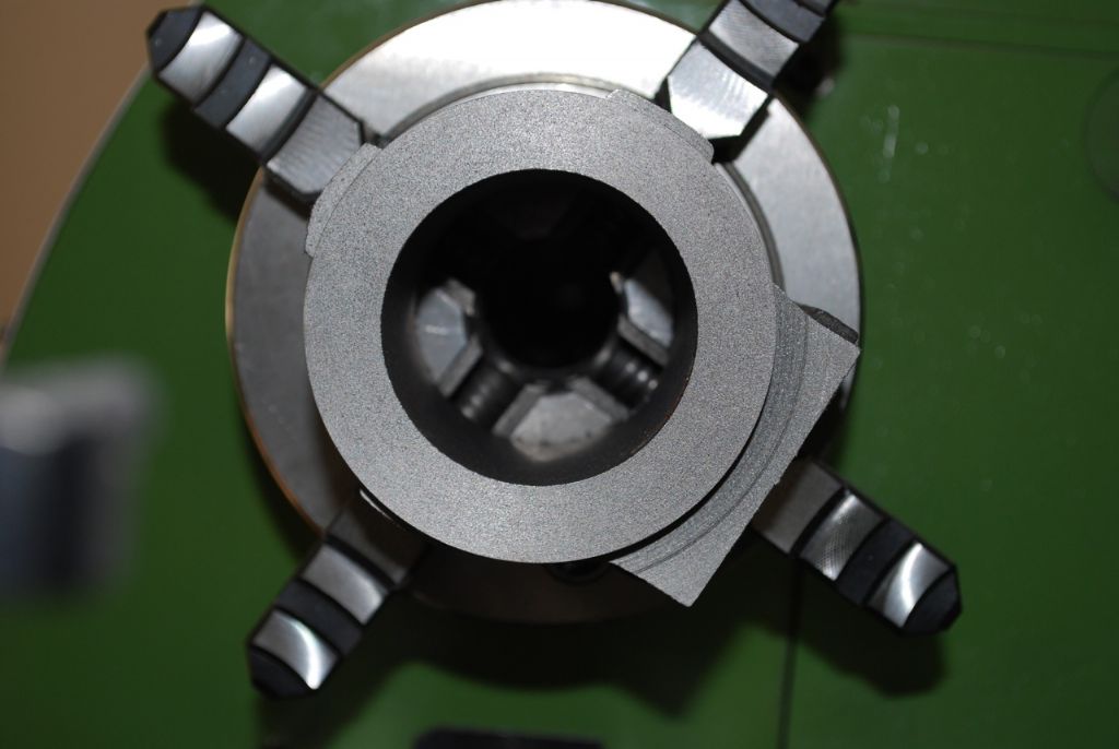

The boring all went very well and interesting to do – apart from ending up about 6 thou oversize in the overall cylinder length everything else is good, but I can always sort that later if need be…

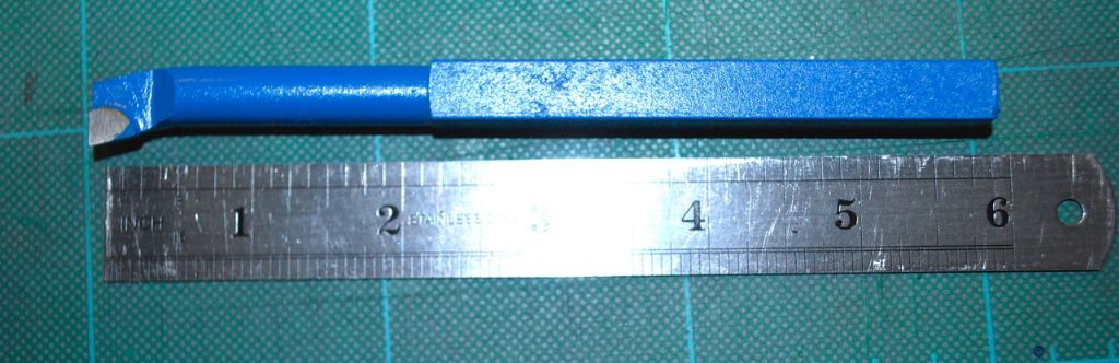

Setting up to machine the Steam Cylinder.

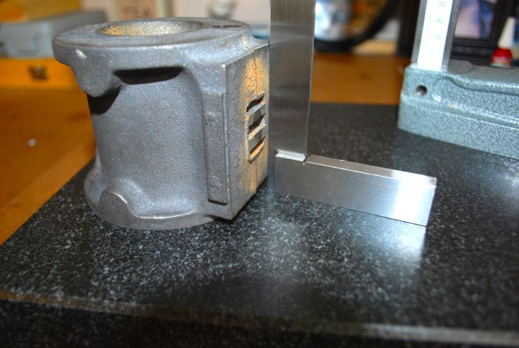

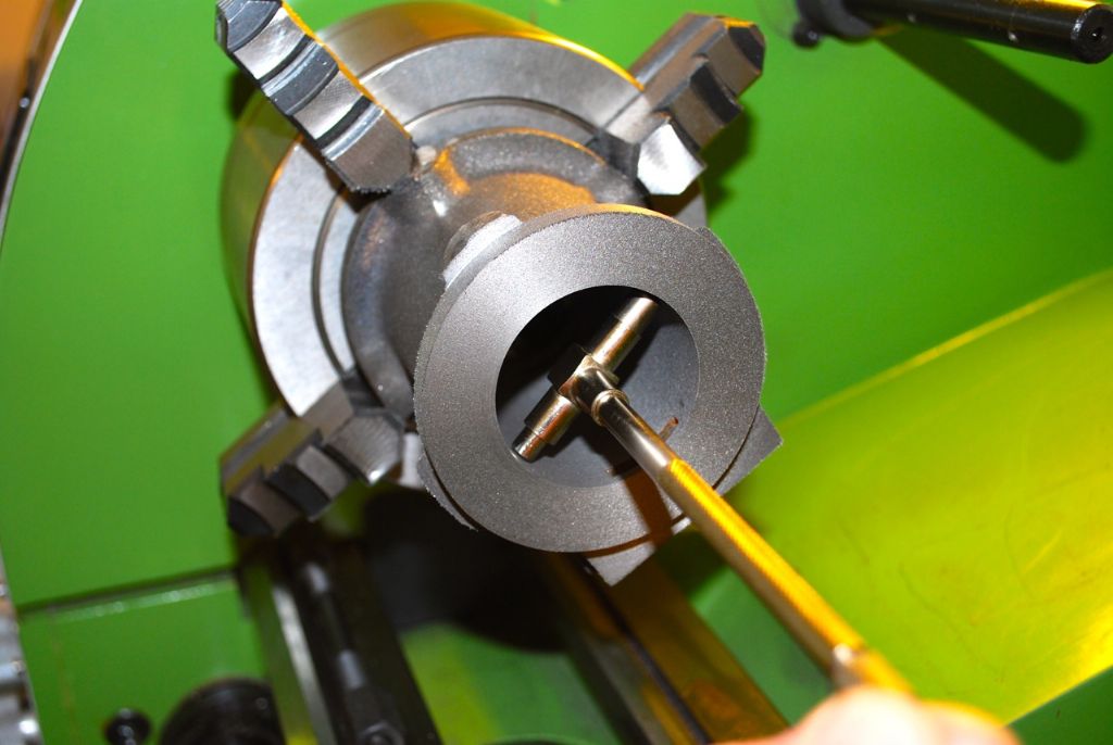

Checking the Steam Cylinder bore. Managed to get the final size to within 1 thou of the 2 inch bore.

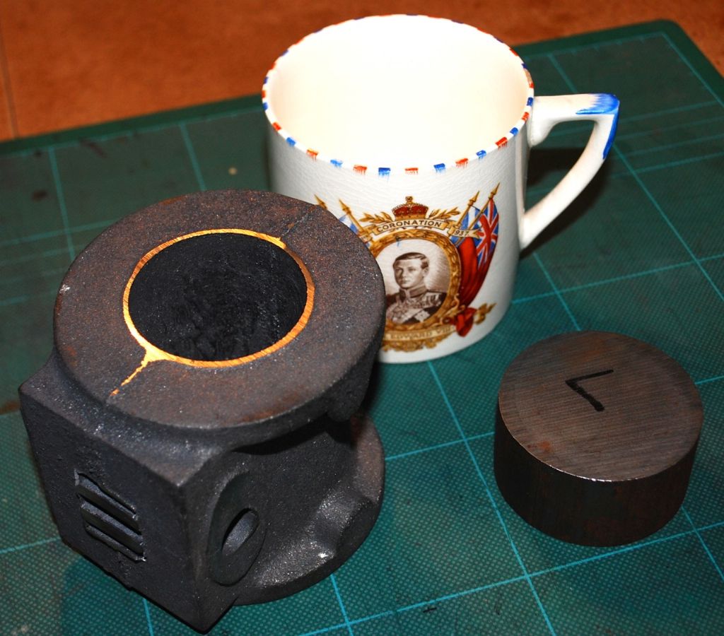

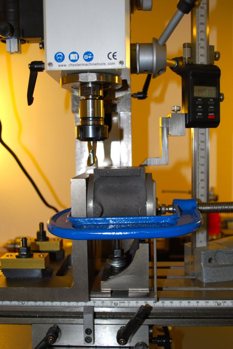

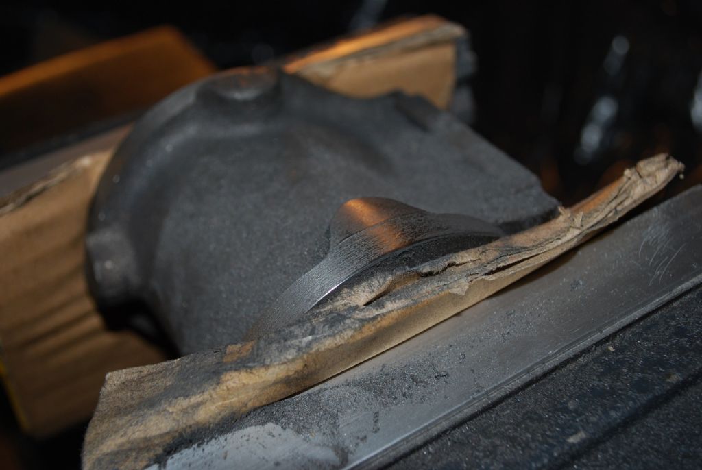

Test fitting the bottom Cylinder Cover – the spigot was almost a push fit, no movement at all, it couldn't have fitted any better I think.. The Cover is slightly larger in diameter than the Cylinder end to accommodate the Cylinder lagging..

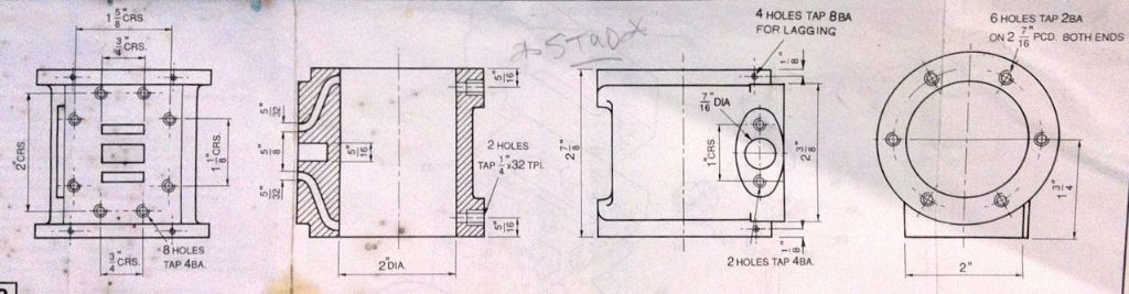

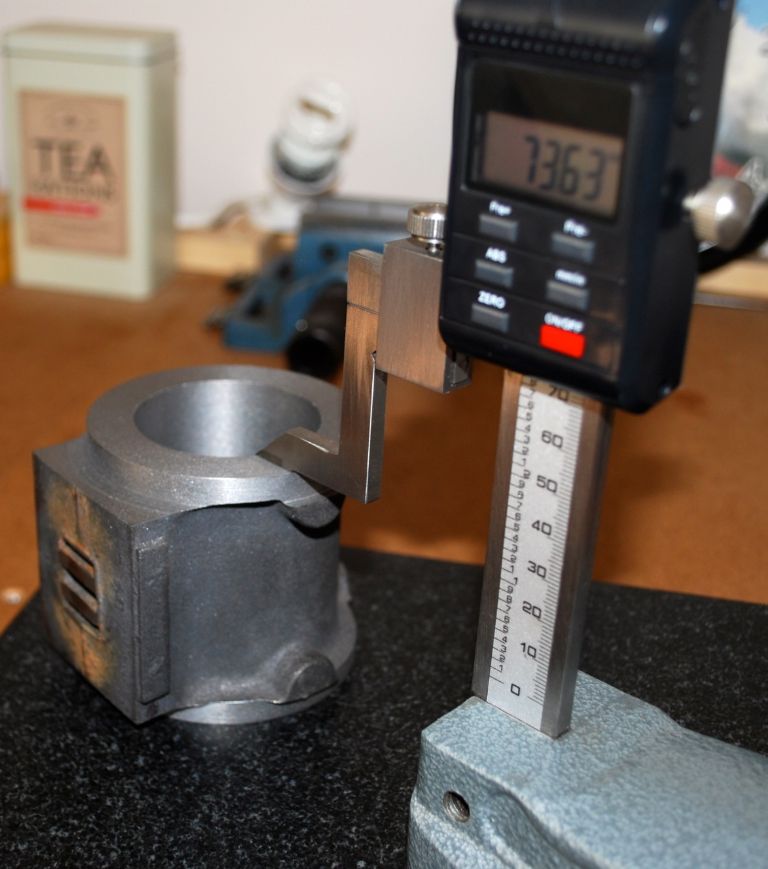

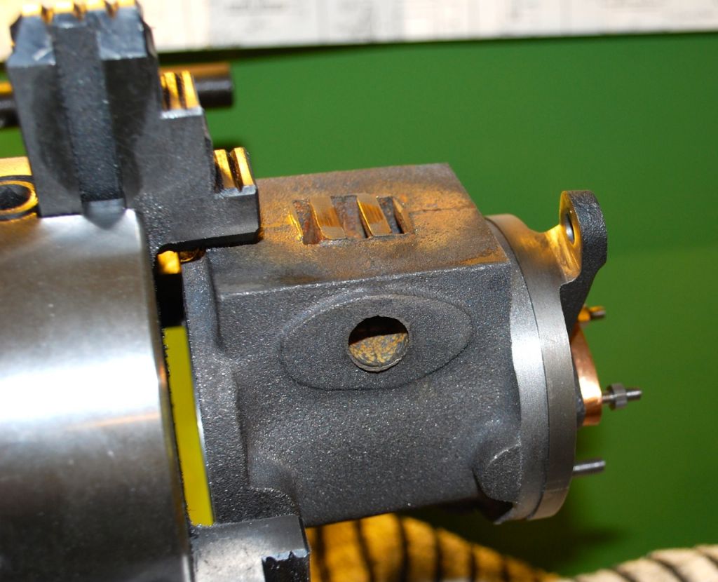

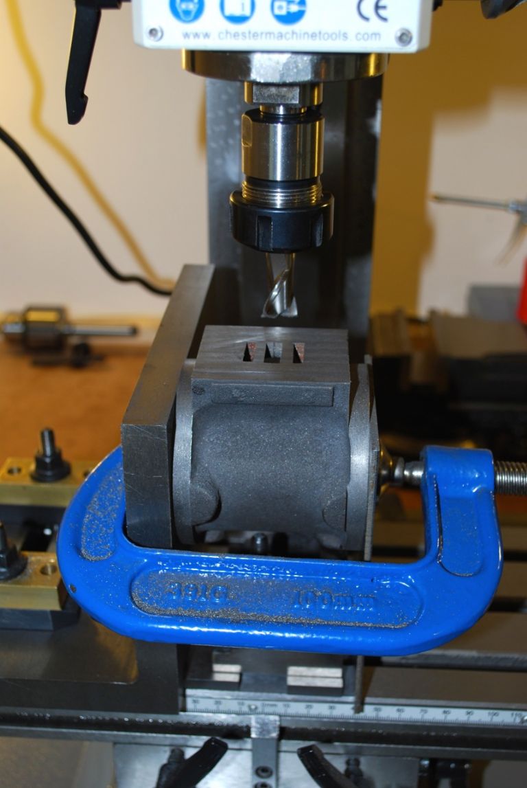

The Steam Cylinder so far and ready to be removed from the Lathe for Milling the Port face.. The 'lugs' I'll do with the Rotary Table on the mill as well..
The Steam Cylinder bored to size.
About 6.5 thou I think oversize for the overall length..
A few seconds video – starting to bore the steam Cylinder. You can see and hear that the bore was slightly out in setting the flange to run true.. But its all come out spot on.. 15 thou cut.
