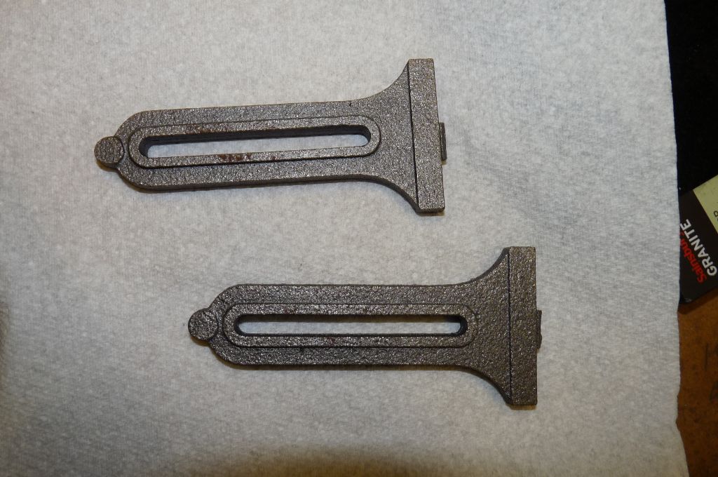

          Got the drawing for the Coombes on Saturday a/m…spent some time checking all the bits and pieces that I have made to the drawing (new) [which now takes precedence over all earlier drawings…including those in the book.]Also bearing in mind what Peter Southworth the Corliss Guru who knew a lot about those engines…when I asked him once about a possible problem with a casting set up…his answer was ''the drawings are only a Guide, Make the parts Fit'' an interesting if not unique reply.As you may have surmised from this there is a slight difference of opinion in a measurement but some careful forward planning should sort any potential probs… all the best for now

            Having a bit of trouble with the Cross head frame slot …found it to be well chilled,milling cutters ,no way…So I set up a Diamond router (for C/F use)..Clocked in each end of slide and let rip with the cutter very S L O W but a great job on the first slide frame There was a little warming up of the mill head bearing so closed down for a while…back later.

              Hi John,
              I was planning to clamp the frames together and mill both slots at one setting. The outer edges were very easy with a file not hard at all. The overall finish of the raw castings was about as smooth as a bear's bum.
              When did Stuarts ship your castings?
              In any event they should replace them if they will not machine nicely, they have always had a good rep for replacing any dodgy castings. I was going to send mine back, but given they seem easy to work, it's simpler to put a but of extra effort in to cleaning them up.

                Hi Steve, I swapped them on ebay …I got a set of Coombes castings and other bits and bobs …He got a Tich loco at about 50% build stage (still have the Kennions Large 3 1/2 '' copper boiler)… I found no problems with the castings …the valve chest and cylinder boring quite straight forwards cutting the slot with the Diamond tooling leaves a great finish ,but it is very slow and I do not want to strain the wee cowells overly much.
                I intend to leave the castings in the sandpaper finish they are in, when sprayed with etching primer the finish looks really good..

                  Finished grinding the slots now working on the sliding bearings that fit them…noticed a bit of heating up in the machine spindle bearing area also in the motor …had a talk with Colin Childs describing the areas and heat intensity…No need to worry,the wee machine performed brilliantly…Job Done.
