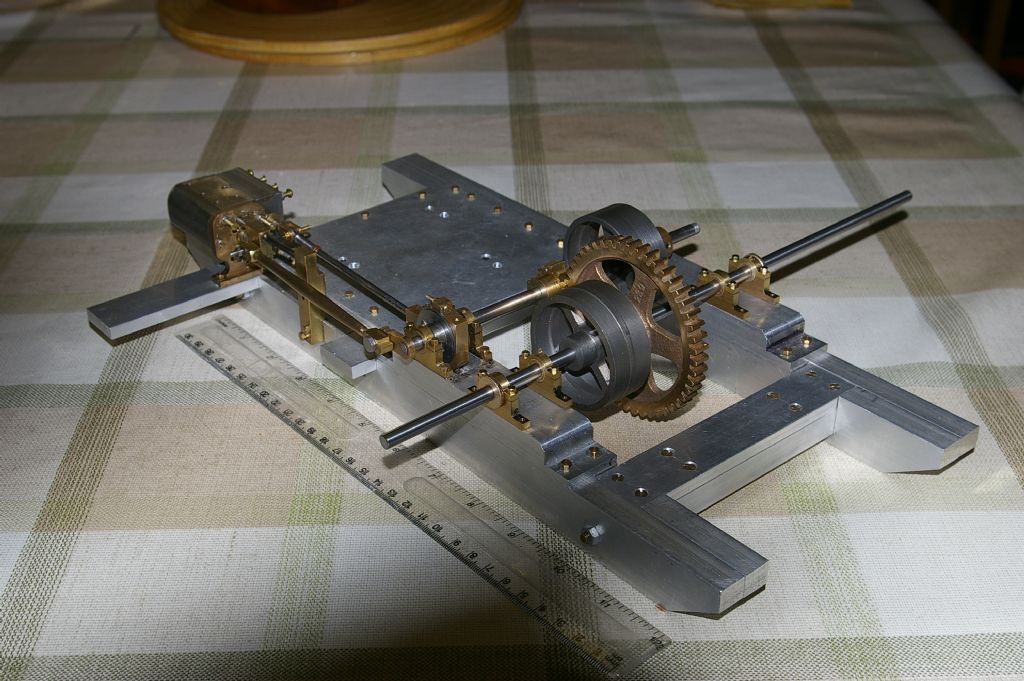

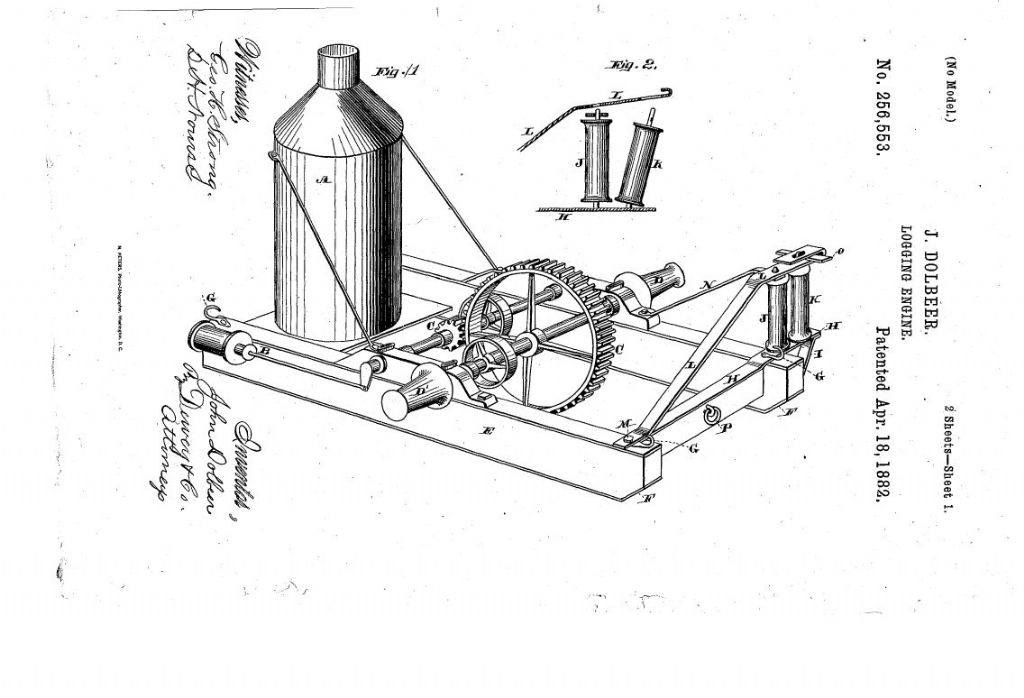

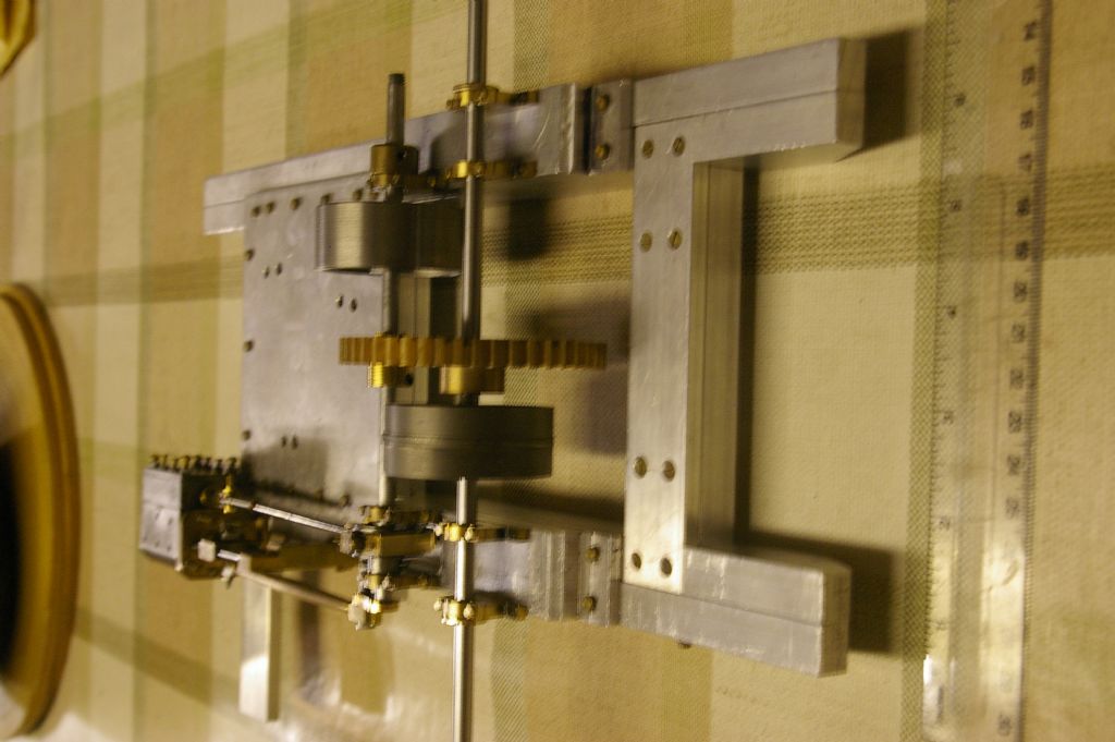

      dolbeerus256553.jpg_igp8103.jpg_igp8101.jpg_igp8098.jpgI am making a model of a A Dolbeer Horizontal Capstan Steam Donkey Logging Engine using the 1862 patent drawing and a drawing of a similar engine with full size measurements
      I have attached a few pictures.

            You have made a good start Ken, would the original have had wooden skids as thats quite a section to have been cast solid?

              Yes Jason I agree if the engine had been produced the sledge would have been wooden.
              Most of the pictures I have seen show the workings mounted on an I beam frame and then mounted on the sledge.
              I am trying to produce a model of the 1862 patent drawing "somebodies thoughts" .
              I was in two minds about how to make the sledge but felt that a model of an "idea" was allowed a bit of " license" and felt that a solid frame followed the drawing and was more substantial if I wanted it to run.
              I look forward to your further input as the drawing is a bit lacking in detail.

                  There is a Yahoo forum called 4L that is interested in logging and equipment. in the Pacific Coast Redwood forest's.
                  I posted the picture attached on the forum asking for the full size boiler dimensions, I was given these plus the information that the "making" of 1"=1' model had bee written up with drawings in the Modeltec magazine in the late 80's
                  After a bit of searching I have just got the drawings in my possession so I know have information on smaller details

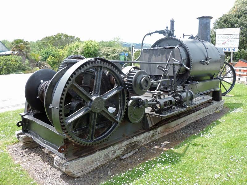

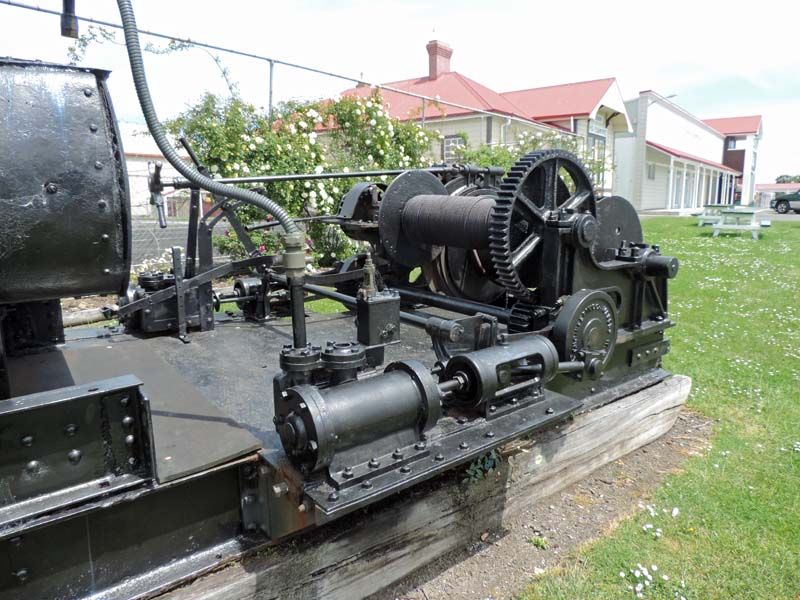

                        Interesting project, I look forward to further progress. I was very much taken with this logging engine seen on my recent trip to New Zealand. It is parked outside the (really excellent!) kauri museum.

                          Rod interesting pictures first one I have seen with a horizontal boiler.
