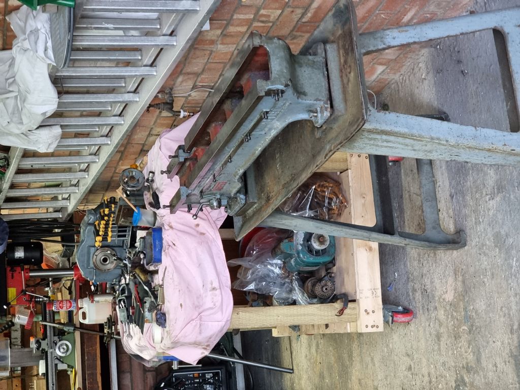

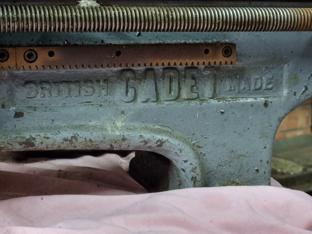

      Hello! I recently acquired a Murad Cadet benchtop lathe that will eventually take over from my unbranded Chinese minilathe for general tinkering. I couldn't find a huge amount of information online about them other than the lathes.co.uk page so I thought I'd document my attempts at a restoration project here. It's also my first attempt at trying to restore something that isn't just a small hand tool, so I'm looking forward to getting stuck in.
      Murad Cadet unloaded
      It's my first time dealing with a machine this substantial, but the seller kindly helped unload it onto the rolling bench. As you can see it arrived with a coat of rust on the machine surfaces.

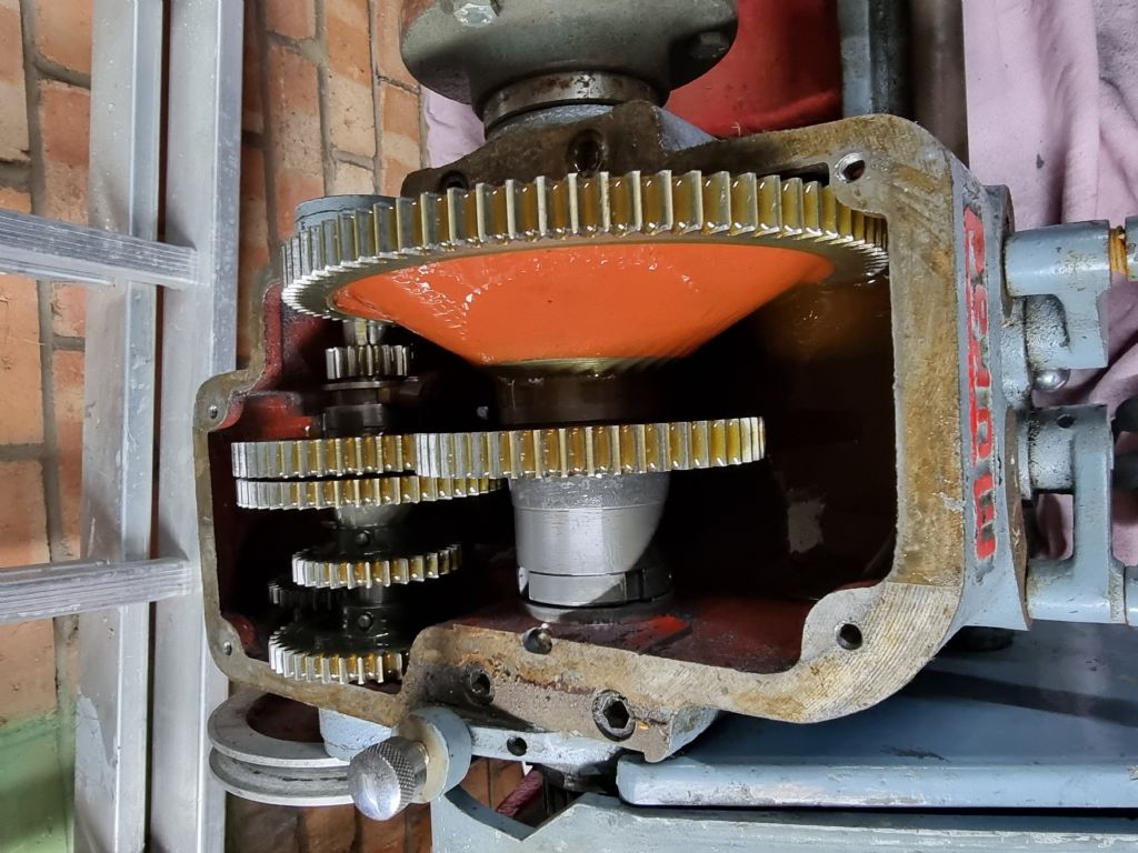

      Cadet headstock gearing
      A look under the headstock cover and all the gearing seems in good condition from what I can tell – I might just leave it at changing the oil for the headstock internals but we'll cross that bridge when we come to it.
      Nameplate
      Obligatory nameplate shot.

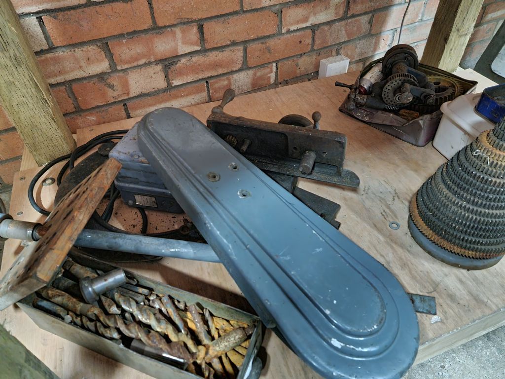

      Some of the tooling
      Some of the tooling that came with the lathe – a full set of change gears and an interesting dividing/indexing attachment as well as what I'm presuming is a milling attachment. There was also a huge amount of drills and cutter (not picture) that sadly look like they've spent a couple of years sat in a tin full of water.

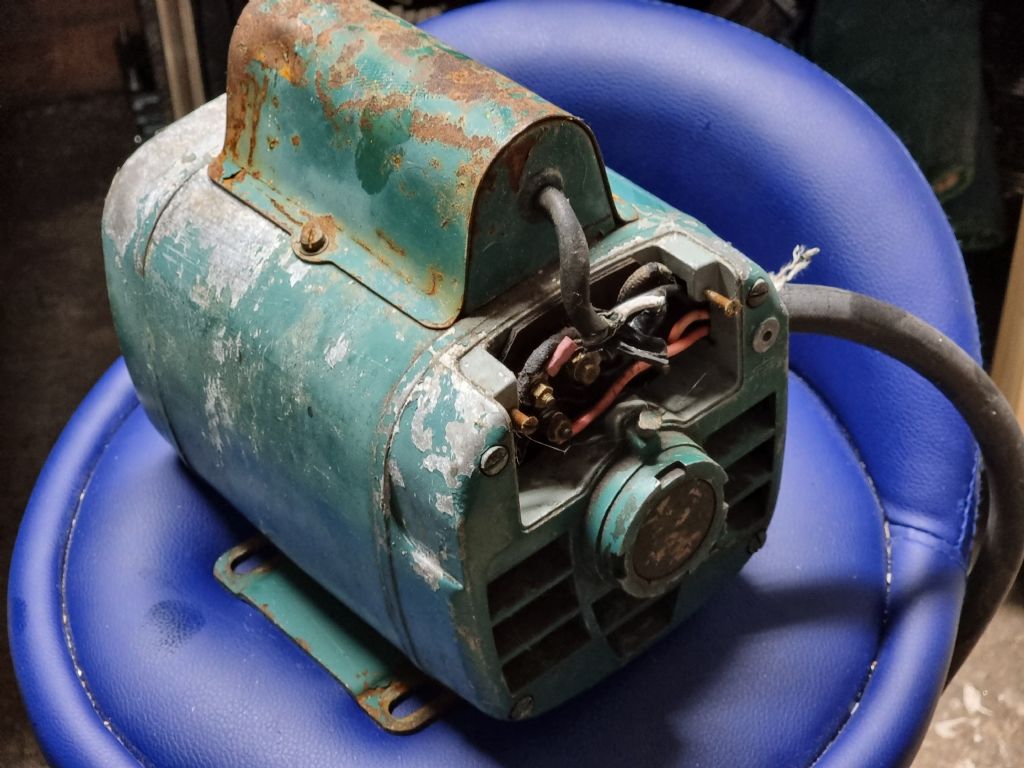

      A quick look at the motor it came with – whether it's original or not I'm not certain – it's branded Hoover.

      Breaking down the larger parts – I've removed everything from the bed and individual assemblies are bagged so I can take it a chunk at a time.

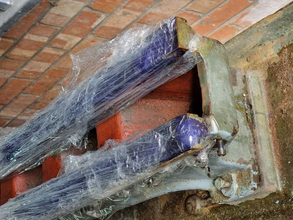

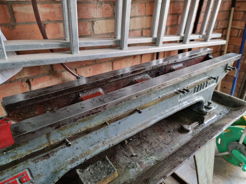

      Derusting the ways
      After getting off most of the surface rust with WD-40 and some 0000 steel wool, I switched to Evaporust soaked paper towels under clingfilm for the really stubborn stuff.
      Clean(er) ways
      24 hours later, and with the Evaporust coating scrubbed off and there's a decent improvement. There's some marks and pitting remaining, but the surface is smooth at least.

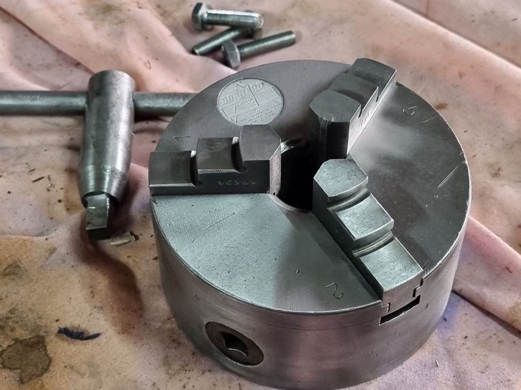

      Cleaned up up 3 jaw chuck
      I also dismantled and soaked the chuck in Evaporust, after which a gentle session with a scotchbrite wheel gave a decent finish.

              I'd be a bit wary of using that motor though, at least not without having it PA-tested first. Simply replacing more-or-less with similar, sticking with 1-phase, should be easy enough as the larger power-tool suppliers like Machine Mart* stock suitable motors. You may need modify the existing mountings for it a little, or make an intervening adaptor-plate. (I did that for my BCA jig-borer.)
              * I write as a customer, when the motor on my generic band-sawing machine went "POP!" in mid-cut.

                Don't go mad cleaning the ways, using the machine regularly for moderate work will wear the ways relatively quickly anyway so only the worst of it needs to be removed

                    I am leaning towards motor replacement at the moment, purely as it'll be one less thing to worry about I'll see how I feel when I have a poke around that area.

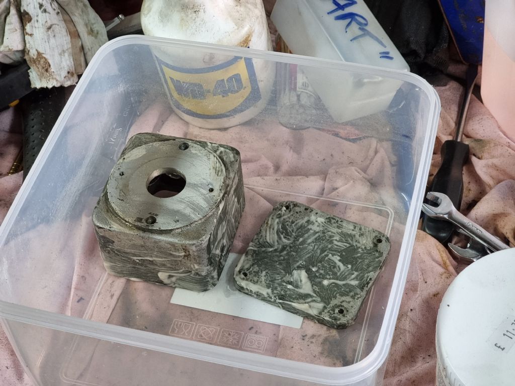

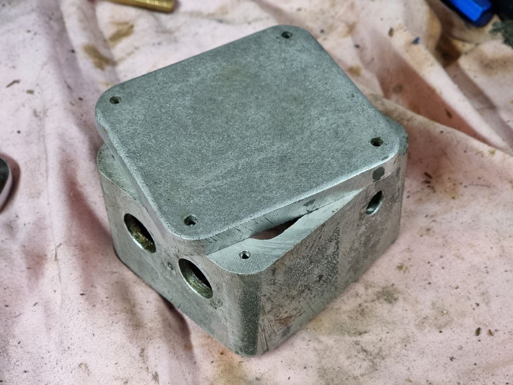

                    Stripping the junction box
                    Speaking of paint, I stripped down the wiring box from the back of the machine to use as a guinea pig for the new paint job. It's not super clear what the original colour was, so I've gone with something similar to what's on the lathe now: a kind of blue-grey with red highlights. Paints are on order from Paragon.
                    Aluminium
                    Cleaned up pretty well with generic paint stripper gel – this part (as well as the headstock cover) appear to be aluminium so will be etch-primed. I've got some red oxide primer for the main castings.

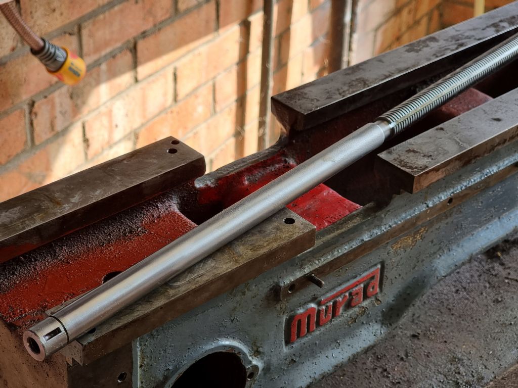

                    Leadscrew Derusting rig
                    The lead screw has also been taking a bath in my unspeakably high-tech derusting apparatus…
                    Shiny lead screw
                    …and has turned up a treat. A rinse, a gentle wire brushing to get off residue and a light coating of 3-in-1 oil for protection was applied.

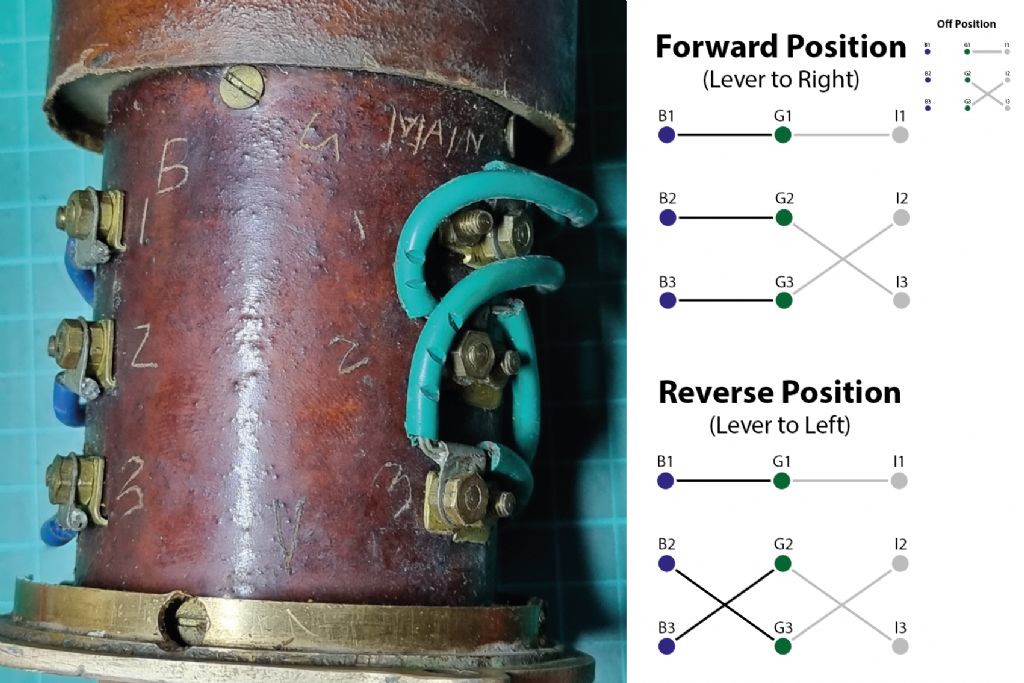

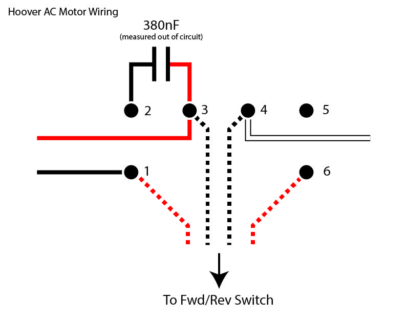

                              Main barrel switch
                              The barrel switch that mounts in the bed casting – I did strip the paint because I'm like a magpie with shiny brass objects.

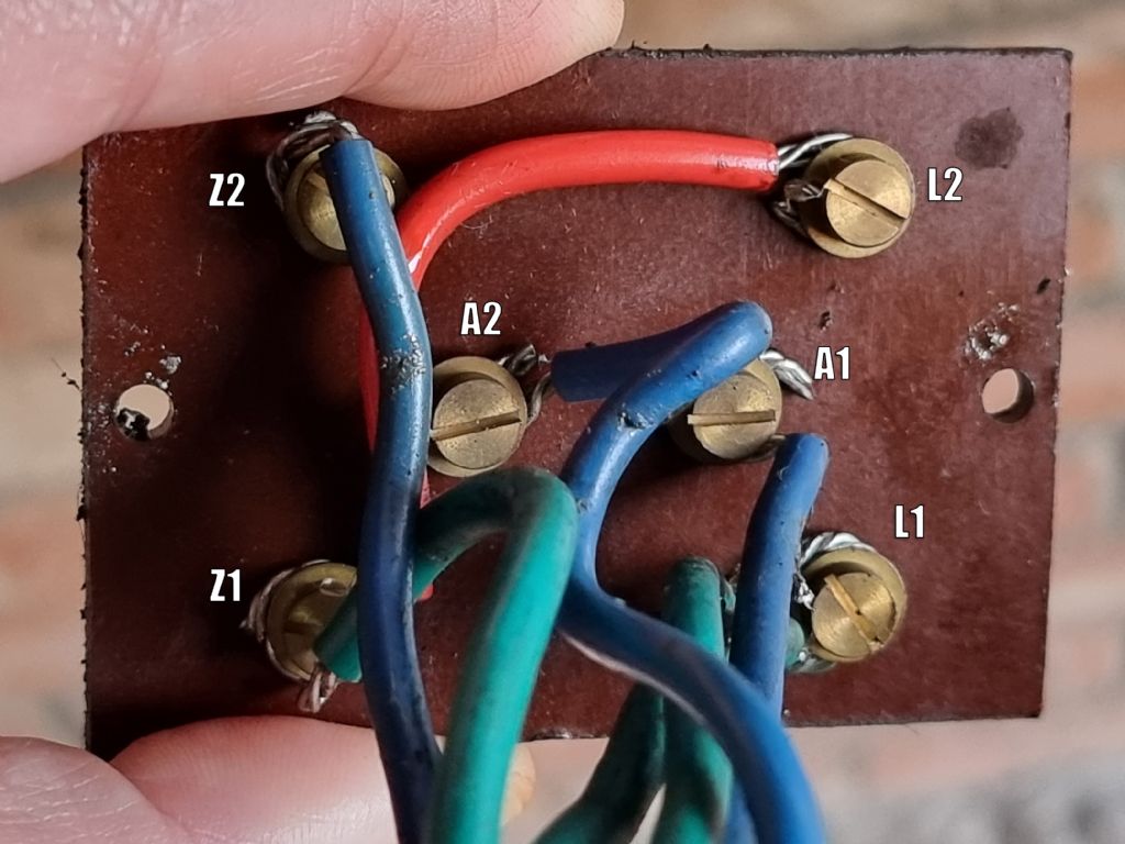

                              Original Switch Wiring
                              This was how things looked with a multimeter in continuity – there's a third set of internal terminals that I've marked with an I for completeness. I do appreciate the previous owner marking things up

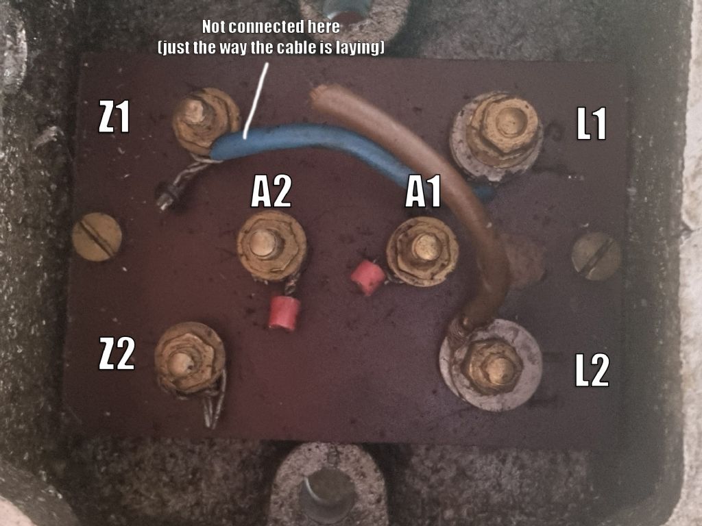

                              Original wiring switch side
                              This is the switch side of the terminal board that lived in the little electrics box on the back of the lathe. I'd documented this corresponding with John before I buzzed out the switch so unfortunately don't have the mapping back to the switch terminals. I do know that G1 and G2 were ganged together onto L1, with G3 on Z1
                              Original wiring motor side
                              And this is the other side with power input and motor output.

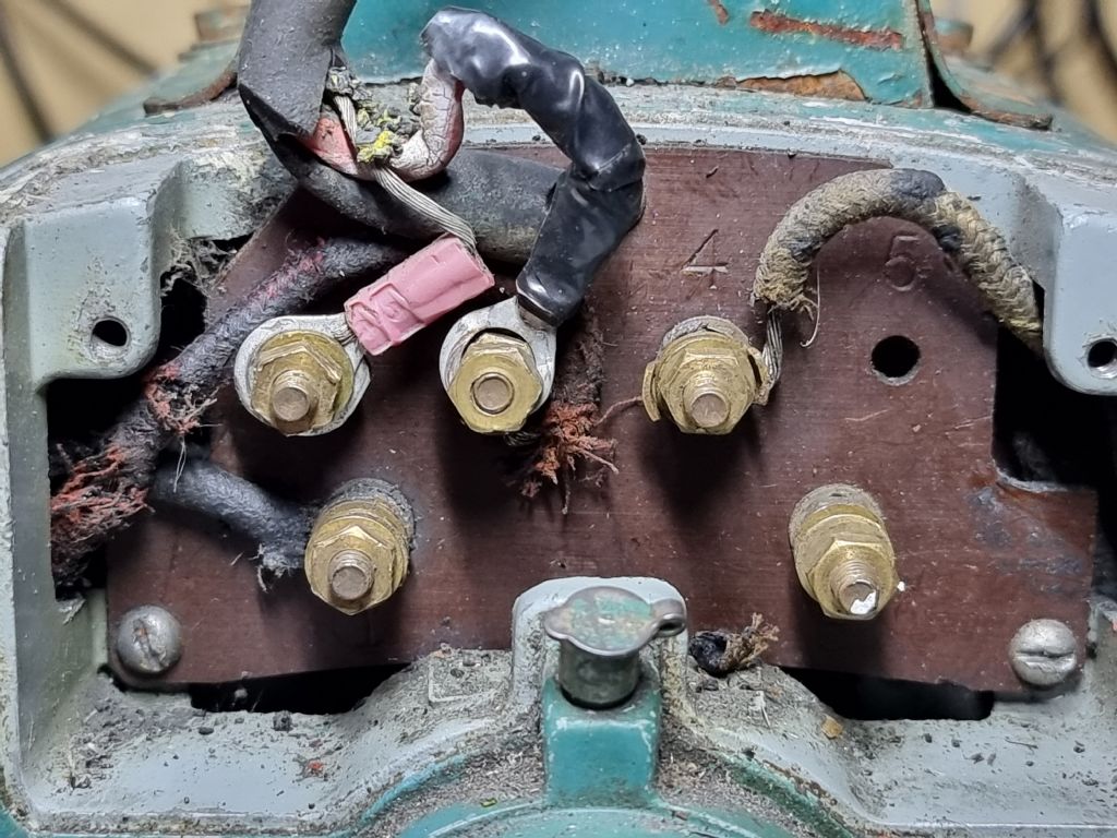

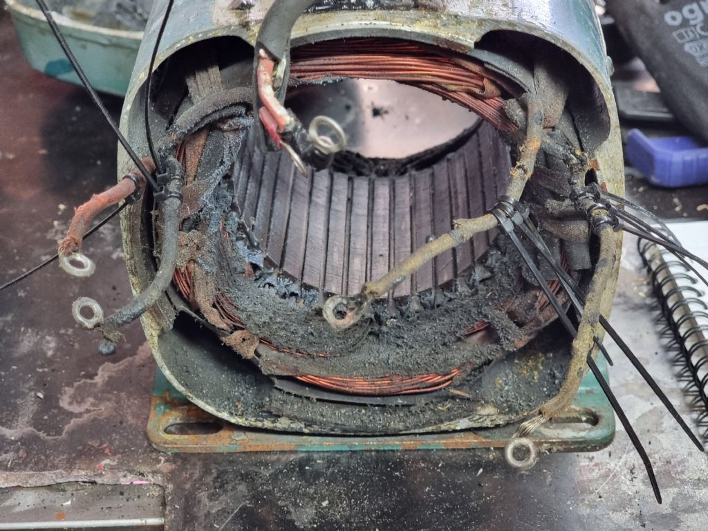

                              Original Motor Wiring
                              And finally the motor wiring side, with bonus appearance from the starter.
                              I'm still in two minds about reusing the Hoover motor, but the starter I do want to replace with something more modern that has a nice big E-Stop. I'd also like to be able to use the main barrel switch for control without switching the main motor load through it – I don't know enough about that kind of thing yet to see if that's a thing. More research required!
                              Edited By Xed on 29/03/2022 22:57:27
                              #592002
                              noel shelley
                                @noelshelley55608
                                Mostly it makes sense, but not at this time of night I will sort it out in the morning ! may have to ask a few questions. Noel.

                                  I like your gentle approach to the job. I wouldn't be gentle with that motor though, lose it . Hoover motors are nasty noisy things and the Murad is rigid enough to take a 1hp motor easily.

                                    If you are going to change the motor anyway, put on a three phase with a VFD. Well worth any extra cost.
                                    #592019
                                    noel shelley
                                      @noelshelley55608
                                      L1 and L2 are the mains live and neutral. Z1 and Z2 are the start windings A1 and A2 are the run windings. To reverse swap Z1and Z2. I will give more detail later if needed ! Noel.
                                      #592074
                                      noel shelley
                                        @noelshelley55608
                                        Check the coil voltage on the contactor coil, should be 220V and also the trip current which will be in the region of 1.5 – 4Amps. The MEM DOL starter is easy to wire, check out ME 4643 mid july 2020. Your wish for a BIG RED panic button is easy as you wire it into the DOL stop circuit in series with the stop button on the DOL as a normally closed switch. You then take Live and neutral to the drum reverser. Now we need the letters or numbers on the motor terminal plate to assertain the various connections. there were numerous letters and numbers used by various maker. what do you have ? wire colours coming from inside the motor may be helpful. Over to you ! Noel.

                                          Personally I would stick with the motor for now, and the starter, far better quality than you can buy nowadays! I have never come across a hoover motor that was noisy unless it was faulty! You can easily change it later if it proves to be underpowered. Why bother with the expense of a three phase motor and a VFD on a lathe that was not designed to run at high speeds anyway. By all means get the motor tested, but I doubt there will be much wrong with it, they were very rugged and reliable, as were the MEM starters, but I always recomend fitting the starter to the wall rather than the machine to prevent arcing at the overload contacts. Noel knows the game!

                                          Xed
                                            @xed
                                            That's fantastic info Noel, thanks so much! I've done more poking around on the back of the motor and drawn out the diagram with the cable colours. The terminal numbers match the back of the motor:
                                            Original Motor Wiring Diagram
                                            Original Motor Internal Wiring
                                            This is how it looks with the external wiring to the switch removed – insulation is a bit sketchy on the red wire and seems to have completely disintegrated on the capacitor wiring. I'm guessing finding a replacement cap would be a good idea?
                                            Edited By Xed on 30/03/2022 20:53:41
                                            Edited By Xed on 30/03/2022 20:54:21
                                            #592126
                                            noel shelley
                                              @noelshelley55608
                                              The way the wires have deteriorated would indicate the motor is oldish may be 60s, but still a good motor. I would expect 4 wires yet I can only see 3, I think ? he cap wires and the motor wires need to be sleeved to maintain insulation. Your diagram only shows 3 motor wires ? If you undo the small roundhead screws are there connections on the rear of 2 and 6 ? One wire will go to the cap from the cap to the centrifugal switch and then on to the start winding, the other end of the start winding will be a terminal. The run windings will be the straight to terminals. this gives you 4 terminals that should be taken to the reverser. In a effort to check the whole motor it would be a good idea to remove the 4 through bolts and strip. You can check the cent switch and it will be much easier to sleeve the wires and check which 2 are run and which are start based on the above. I will send a PM. Noel

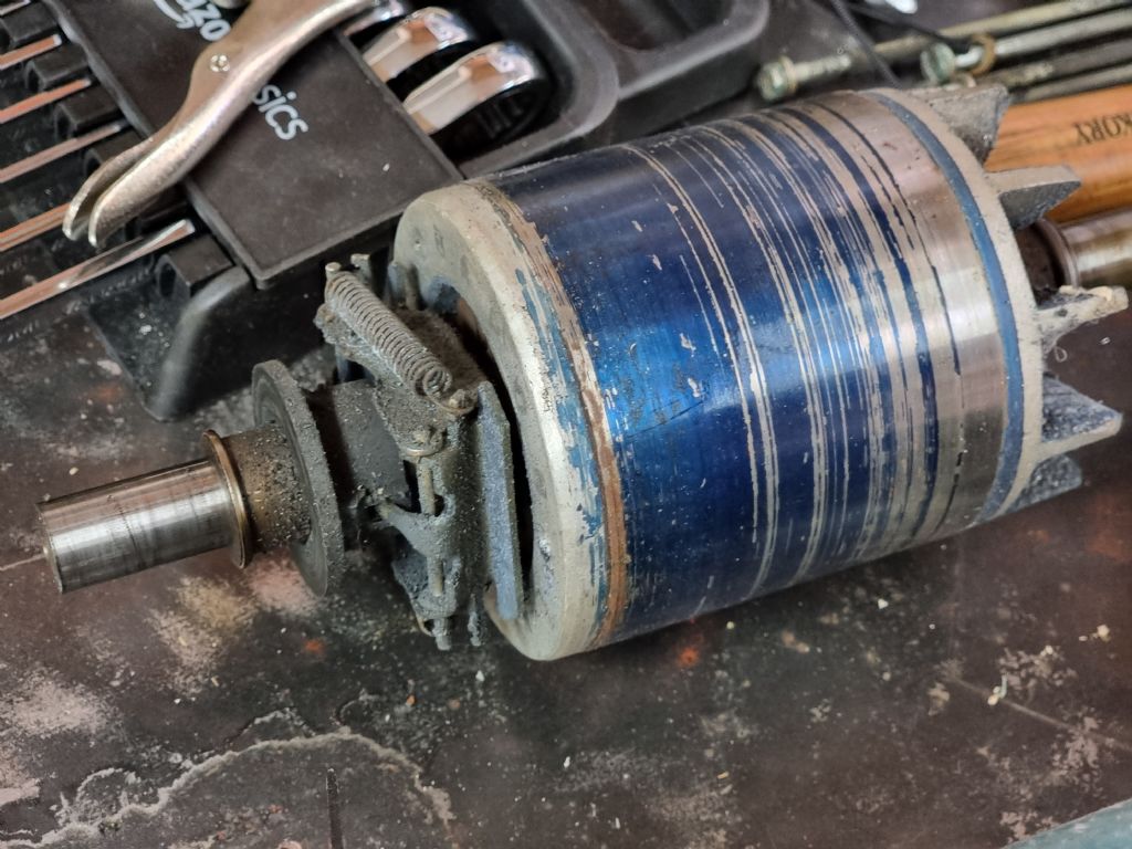

                                                It's going to be a bit of a big update, so I'll split it into sections – first up puzzling out the motor:
                                                Full Motor Wiring
                                                I've now got the motor apart and have added the internal wiring to the diagram.
                                                Motor Windings
                                                Wiring to the windings, numbered by cable ties.
                                                Motor Back Plate
                                                Backplate and switch
                                                Motor Rotor
                                                And the rotor.

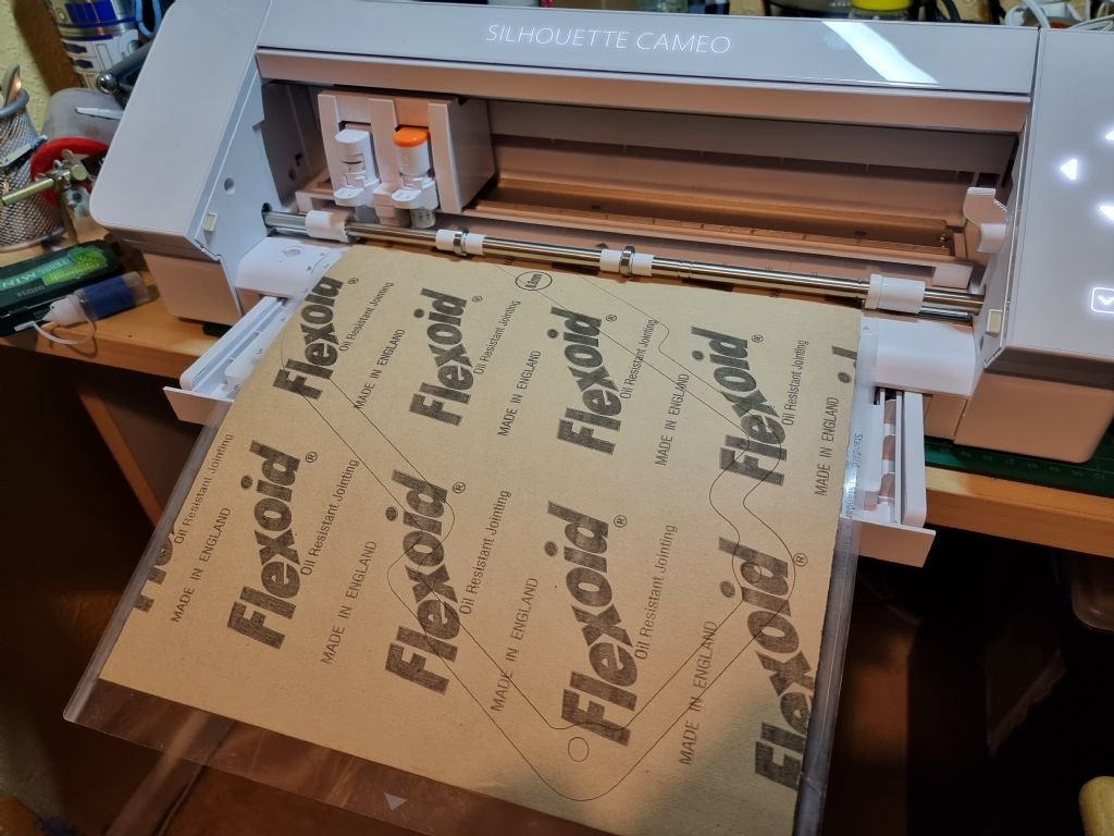

                                                #592538
                                                Xed
                                                  @xed

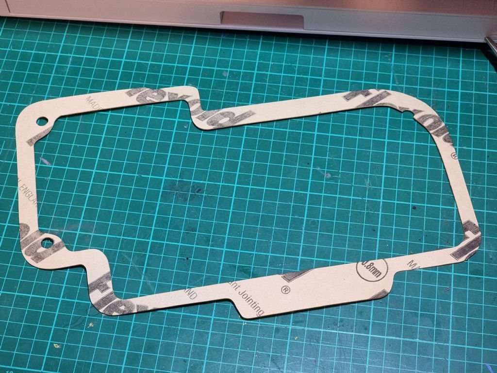

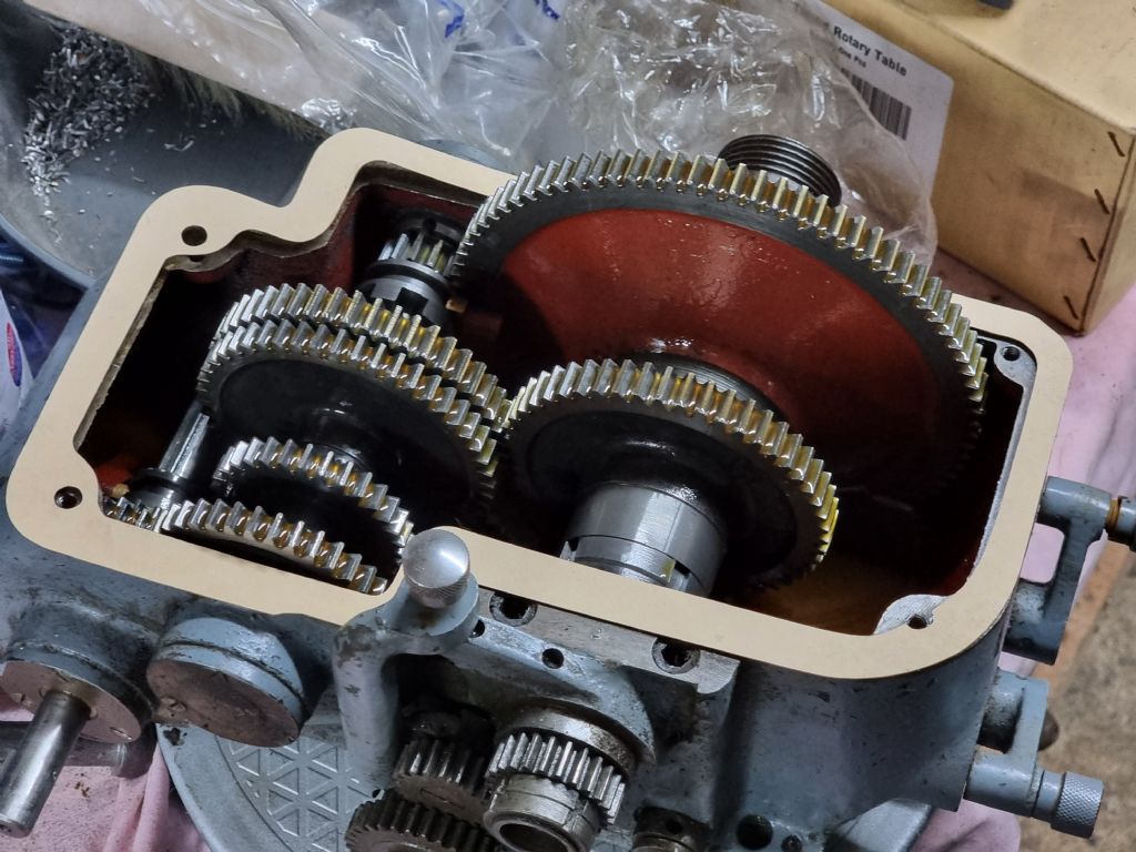

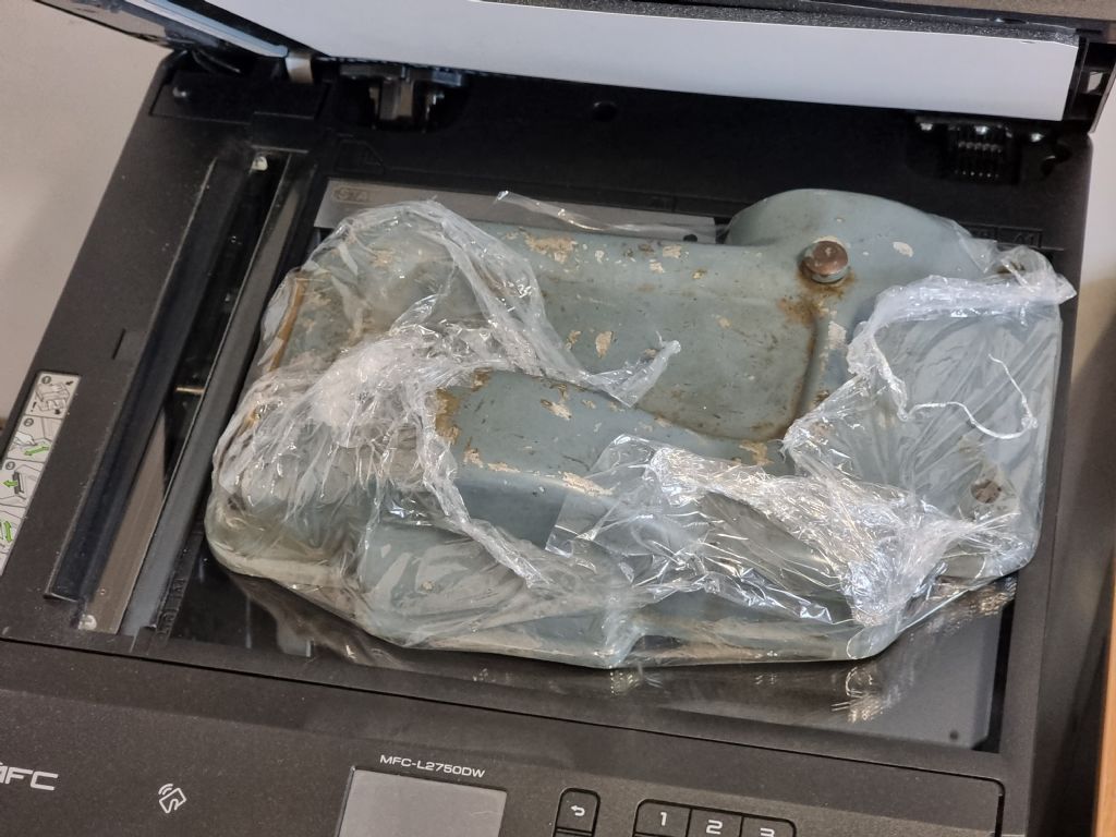

                                                  Next, I noticed there was no gasket between the headstock coverplate and the main casting, so I thought it couldn't hurt to make one and keep the oil where it should be. I also got to try messing around with the vinyl cutter.
                                                  Gasket Scanning
                                                  Could just about fit the cover on a scanner to draw up the gasket
                                                  Gasket Cutting
                                                  With the vector file drawn I then sent it to the vinyl cutter loaded with some 0.8mm gasket paper
                                                  Gasket
                                                  That worked surprisingly well!
                                                  Gasket Installed
                                                  And it even fits, which is always a bonus

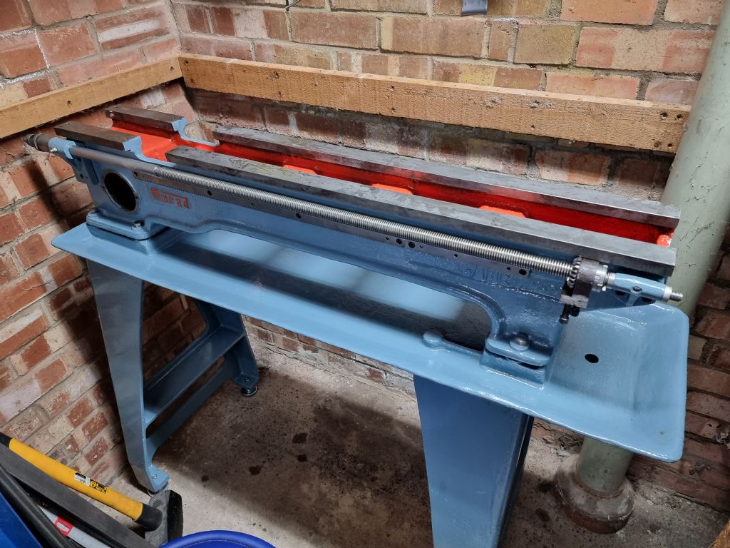

                                                  #592542
                                                  Xed
                                                    @xed

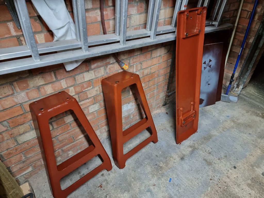

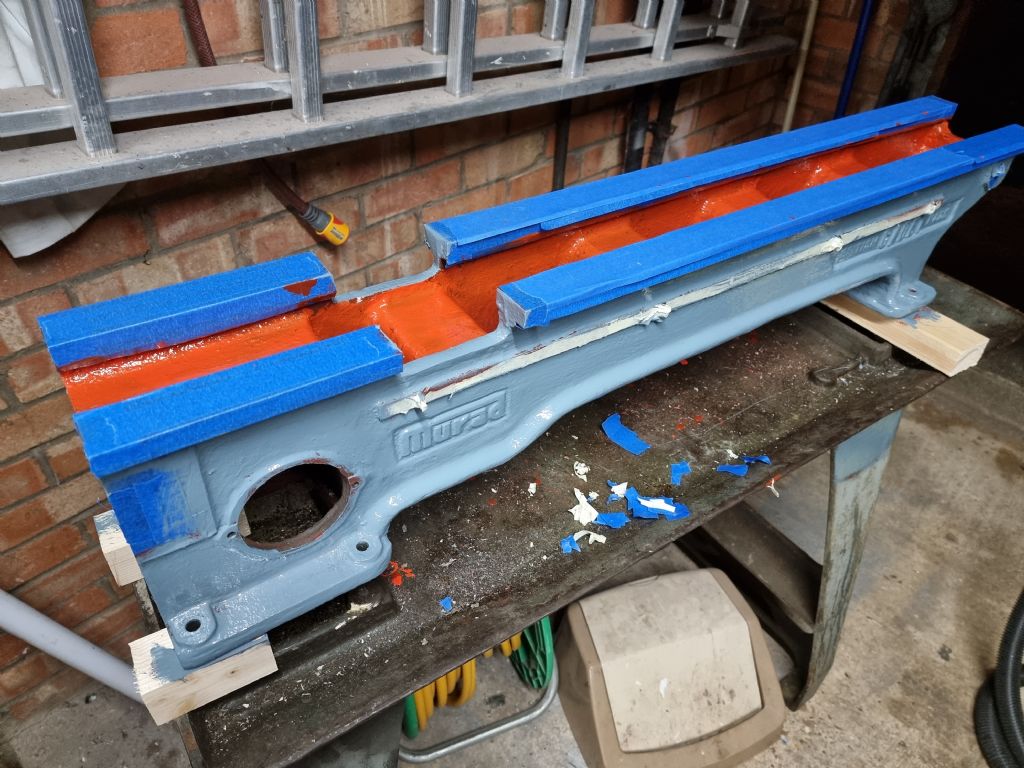

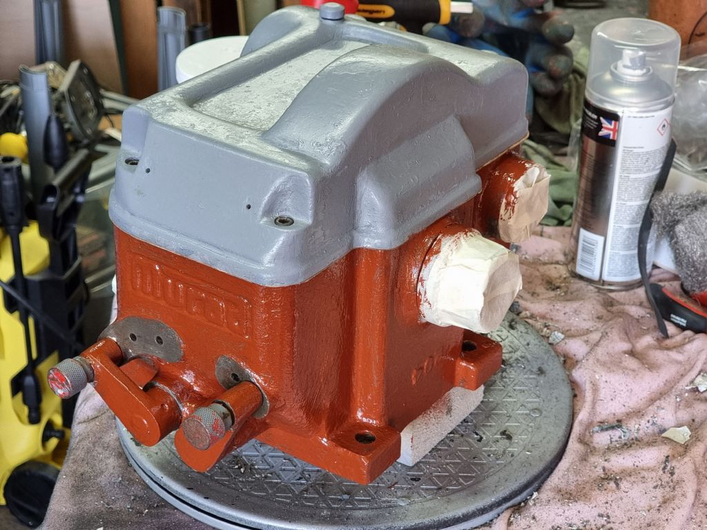

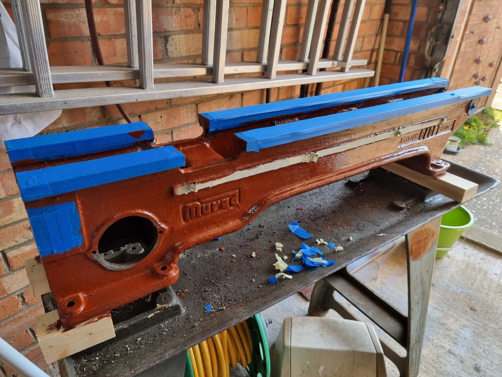

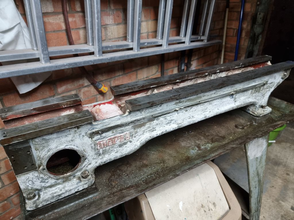

                                                    And finally, while all this has been going on I've been stripping, priming and painting the largest bits:
                                                    Stripping the bed
                                                    Stripping the bed
                                                    Bed Primed
                                                    Masked up, and a coat of red oxide primer on the cast iron bed.
                                                    Bed First Coat
                                                    First coat on. I'm using one of Paragon's Boxford greys and it's quite similar to what was already on there.
                                                    Bed - stand primed
                                                    The stand got the same treatment, which my back was not a fan of.
                                                    Bed Reassembled
                                                    Bed and stand pretty much done and near to final position. I added holes for levelling feet to compensate for the lunar landscape of my garage floor – I will be upgrading to fancy levelling casters though.
                                                    Headstock Primed
                                                    Headstock getting the same treatment – I couldn't get the levers removed so have decided to do them in-situ for the time being. The cover plate seems to be aluminium so I've switched to an etch primer for that. The cheap and cheerful lazy susan was also a great help!
                                                    And that pretty much brings things up to date

                                                    #592546
                                                    ega
                                                      @ega
                                                      Impressive!
                                                      Are those levers held on with taper pins?
                                                      I take it you are using a brushing enamel?
