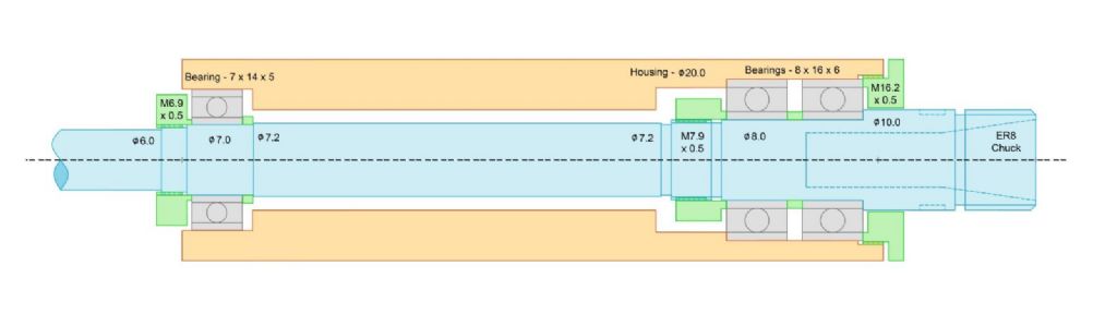

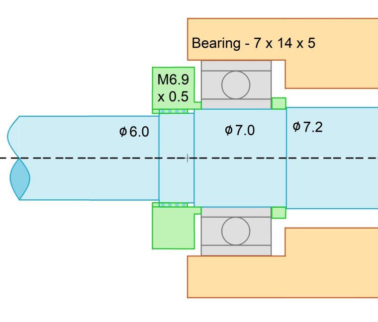

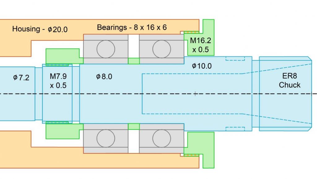

                        Critical comment time!
                        Preliminary drawings for my spindle with a few critical dimensions. Front end first –spindle front 1.jpg
                        And for wht it's worthh, the whole thing –
                        The colours are for clarity, they are not meant to represent materials.
                        Steve

                          Is that to scale? You can buy ring nuts from SKF, but not to those odd sizes. If you bore the centre section to say 14.5 diameter you can assemble the bearing to the shaft first, then slide the whole thing in from the front, this is a lot easier than trying to assemble the back bearing in situ. 7mm ring abutting a 7.2 mm step isn't a lot, you could omit the M7.9 nut and have a sleeve between the bearings
                          #653281
                          HOWARDT
                            @howardt
                            Minor diameter of M16.2×0.5 is 15.7, so that is a no, would need to be at least 16.5. Spacers between both inner and outer rings at the front, ground to suit the bearings will give some preload, otherwise nut is not locked in place. Use a snap ring below the upper bearing to give a larger thrust shoulder. Use M7x0.5 for rear thread, no point in odd size. As previous bore through for simple assembly. Make front pair bearing nut M8x0.5. It is quite normal for the bearing locknut threads to be same size as bearing bore. Machine to ensure concentricity of all bores. At 15k use light air oil lubrication, will also help o keep the swarf out.

                              Steve Crow
                                @stevecrow46066
                                Posted by HOWARDT on 22/07/2023 19:41:45:
                                My error the, thread should be M17 x 0.5.
                                The odd sizes were just meant to show clearance on the thread crest. Effectively, they'll be M7 and M8.
                                I'm only planning to buy in the bearings – I'd like to make all the other parts myself.
                                #653308
                                Kiwi Bloke
                                  @kiwibloke62605
                                  Not a criticism, but a suggestion…
                                  The design can be simplified, removing one screw-cutting operation, and making the spindle itself simpler to machine.
                                  Instead of a ring nut against the nose bearing inner track, a tubular spacer can be substituted, between the inner tracks of the inner nose bearing and the inner track of the tail-end bearing. Everything is tightened up by the tail-end nut. The tubular spacer should be a close fit to the spindle shaft, and will increase stiffness as a bonus.
                                  Probably need a simple locking arrangement for the ring nut abutting the outer track of the outer nose bearing.
                                  #653334
                                  John MC
                                    @johnmc39344
                                    A rather complex solution that can be simplified as Kiwi bloke suggests. Also, remove the spacer between the two nose bearings, clamp them together. Maybe a circlip rather than the M16 threaded holding the outer races?
                                    The mounting of the third bearing is as it should be.
                                    Another thought. Why not reduce the overhang from the nose of the spindle by removing what looks like a plain diameter with spanner flats(?). Then contrive something at the other end of the spindle to hold it while tightening the collet nut.
                                    Its good to see a design that doesn't (grossly) over constrain the bearings as many do, that are published in the world of ME.,

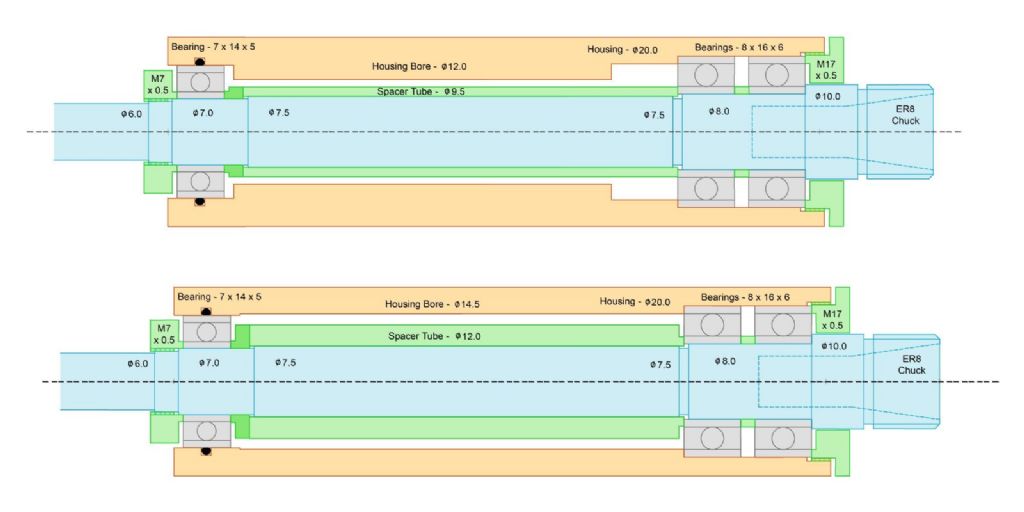

                                          #653408
                                          Steve Crow
                                            @stevecrow46066
                                            I'm really appreciating all this advice and I've tried to work in the suggestions for these drawings-
                                            The second one can be assembled first and has a beefier spacer. Things are getting simpler!
                                            All comments welcome.
                                            Steve

                                              #653457
                                              Kiwi Bloke
                                                @kiwibloke62605
                                                Looking good! And pretty pictures too. (Wish I could bring myself to re-learn CAD. I had an early version of TurboCAD – it drove me nuts. Ever since, it's been back to pencil & paper…).
                                                I think the most challenging aspect of manufacture is getting the spacer-to-spindle fit right, if one is going for a snug fit in the hope that it will add rigidity. Perhaps someone could tell us how snug the fit has to be to be effective, for this geometry. I'd imagine that significant hoop stress has to be induced in the outer member, to effectively pre-load the inner, so it would need to be a press fit, which rather screws up the whole idea. The idea is more effective when the spindle is really skinny, and the spacer can increase the overall diameter a lot. It's probably an unnecessary gilding of the lilly here, because the spindle is of relatively large diameter already, and the spacer can't easily be much larger. Please can someone advise?
                                                So, perhaps the spacer can be freed from its obligation to add stiffness, tolerances can be relaxed and simplification is achieved..
                                                More simplification. If the spindle's 7.5 mm diameter section between the bearings is made only a little larger than the ID of the tail end bearing (say 7.1 mm), the dark green thrust washer (?) twixt spacer and inner track of tail bearing can be deleted. Also, I'd delete the groove in the shaft behind the nose bearing pack. If needed (and it looks unnecessary from your drawing, a small internal chamfer could be added to the spacer tube to clear the transition between spindle diameters here
                                                Don't forget the pulley, the nut being outboard of it. Keep us posted!

                                                #653459
                                                Andy_G
                                                  @andy_g
                                                  Are you concerned about stiffness? (Of the spindle!)
                                                  For best stiffness, the front and rear bearings should be separated by 3-3.5 x the diameter of the shaft through the front bearings (so 24 to 28mm in this case – see page 66 of the SKF document I linked to earlier). The major contributors to the lack of stiffness of my original CNC spindle were the large tool overhang combined with an excessive distance between the spindle bearings, allowing the spindle shaft to flex between them.
                                                  I try and explain in this video (from about 12:45 if it doesn't go straight there).
                                                  For my improved spindle, I also considered (and rejected) a spacer sleeve to clamp both front and rear bearings to the spindle at the same time. I wasn't convinced that I could make the sleeve to fit well enough that it was guaranteed to: a) run concentrically; b) Not bind up on the shaft; and c) end up perfectly parallel so that it didn't induce a bend in the spindle shaft when everything was clamped up.
                                                  Edited By Andy_G on 24/07/2023 00:30:35
                                                  #653460
                                                  duncan webster 1
                                                    @duncanwebster1
                                                    The old skf catalogue gave lots of info about abutment dimensions. I made the mistake of binning mine on the basis it would all be on the Web. You could make the 14.5 bore 14.1 to increase the abutment. I
                                                    The spacer tube only needs to be a good fit at the ends, so if you machine the spindle so the the 8 diameter is proud of the bearing to the left by a few mm then make the dark green bit part of the long spacer it makes life easier, most of the length of the bore can be clear of the spindle, just the right hand end has to fit the 8 dia. It doesn't want to rattle about, a nice slide fit at the ends.
                                                    You need a means of locking the right hand bearing adjusting nut. Unless you actually need axial thrust both ways you could put a wavy washer in and tighten the nut fully, or take other's suggestion and get a matched set of bearings. I still think you'd be wise to draw it out to scale, I don't think it is at the moment
