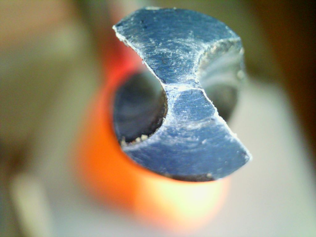

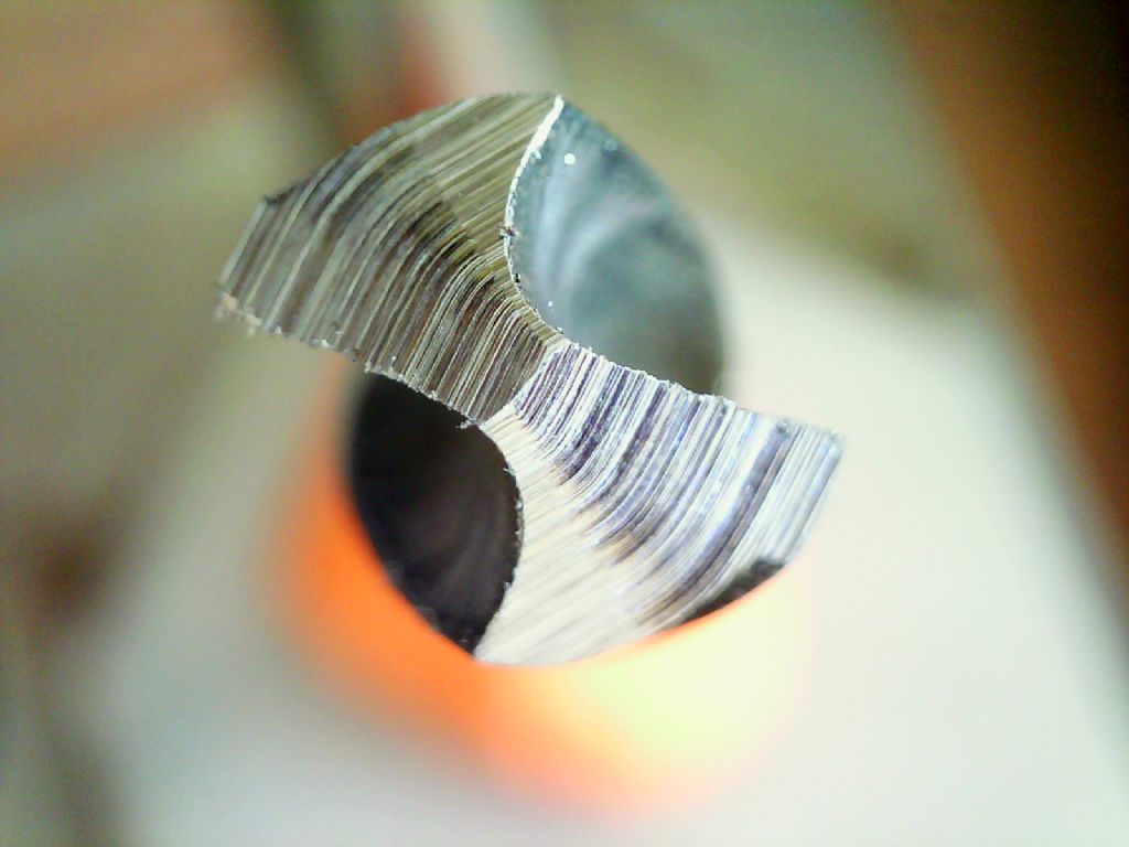

        When I posted this ***LINK*** to a demo of the Sealey SMS2008 I was surprised that there was no response at all.
        Here's a couple of before-and-after pictures of a drill sharpened on my device. It's really easy to use – just as shown in the video.The sharpened drill cuts very well – like it should.
