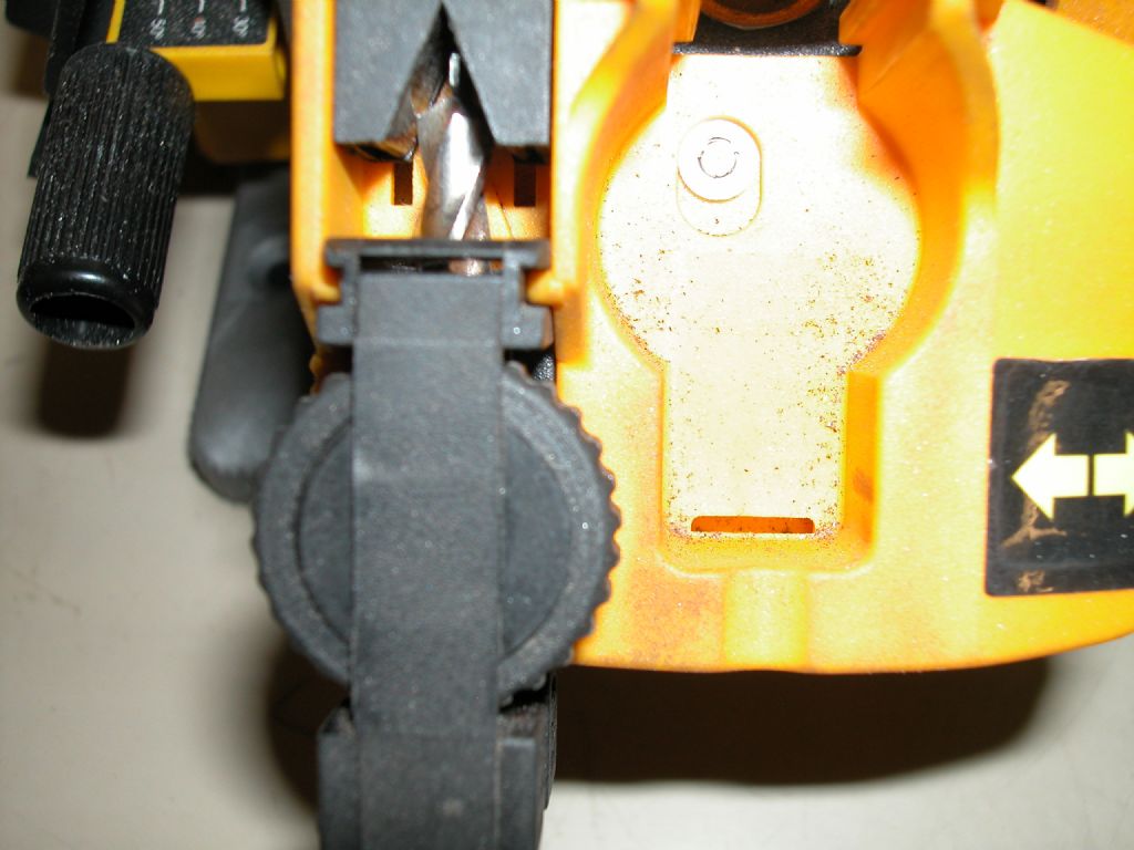

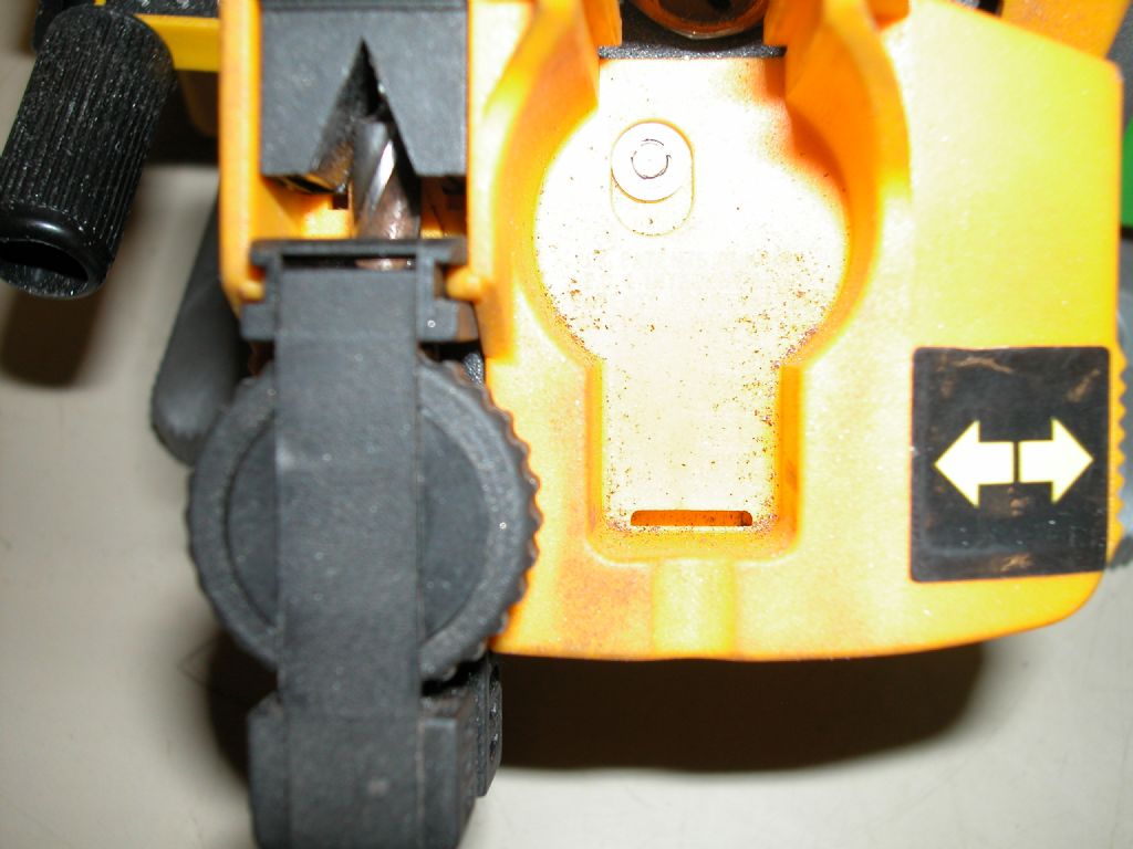

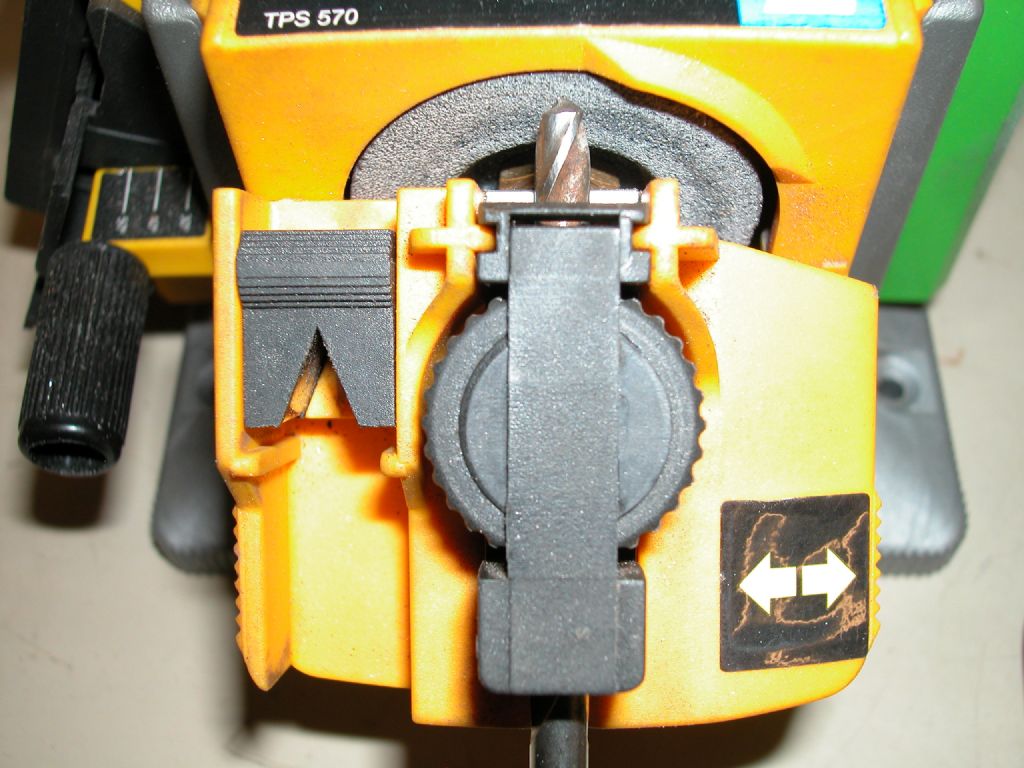

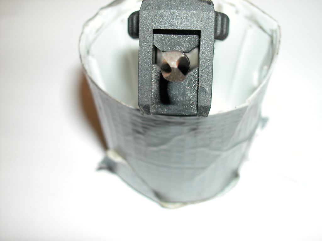

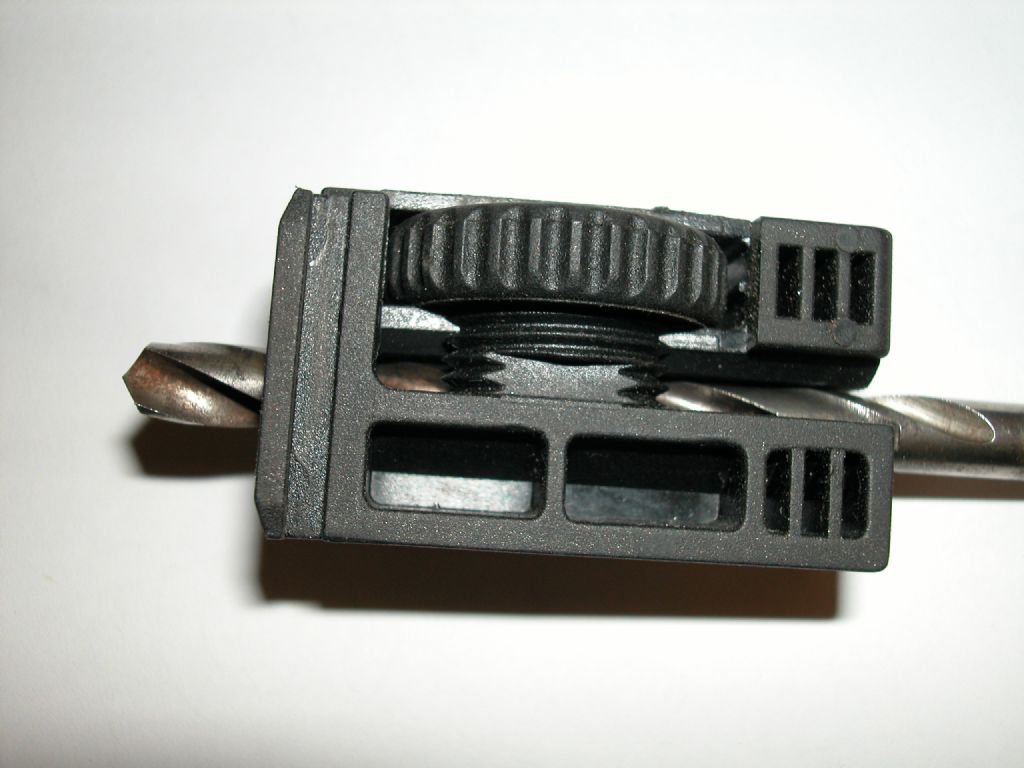

                              Some pictures of the plasplugs device :-
                              In action grinding the first cutting edge with the carrier upright, note the setting jig on the left
                              Using the setting jig. The drill point is pushed up to a metal stop and twisted until the floating Vee block drops to its lowest point. In this picture the drill is at the wrong angle so the Vee block is too high allowing the stop to be seen.
                              Drill at correct angle with the Vee block at its lowest point seated on the tips of the cutting edges. Note the shape of recess for the drill carrier in the swinging plate which allows it to be simply inverted to do the second edge without needing the drill to be reset. A major major advantage over the common swing jigs.
                              Here is a front view of the drill in its carrier showing the 5 to 5 position of the cutting edges. Same as the Picador jig.
                              Finally a side view of the carrier and (seriously mankey) drill. Grabbed out of the scrap box for photo purposes hoping the slight rust would give better contrast.

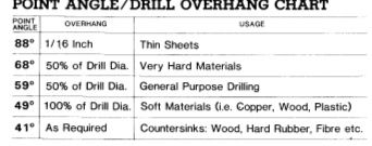

                              Getting back to the original Draper device I have a set of instructions for the American General No 825 version which gives some guidance as to drill projection. PM me if you'd like a copy. Its about the best set I've seen for such jigs.
                              Pasted Graphic.pdf
                              The overhang is measure from the lip rest at the front of the trough. Pictures are somewhat misleading as, unlike to Picador system the lip rest is rarely in contact with the drill flutes. Interestingly the grinder is shown working on the periphery of the wheel rather than the side as is normally specified.

                                  Gah, table of projections for the General jig didn't upload in my previous post. 2nd try :-
                                  Mark makes a good point about the inherent excess heel clearance of acted grinds. In practice its not an issue with technically guided drilling systems such as mills or pillar drills. These keep things straight enough until the drill is deep enough to register on the sides of the hole. Unless the drill is very blunt or grossly over fed.
