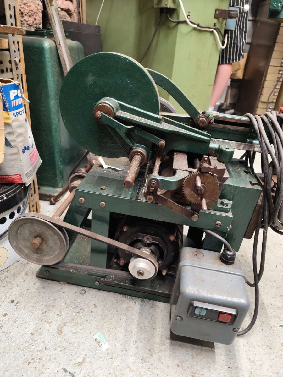

      Good evening all,
      I was fortunate enough to get a hand-powered version of the Adept No. 2 Shaper a number of years ago, but didn’t know a good thing when I saw it and moved it on. Kicking myself, I have been on the lookout for a motorised version and I have found one and availed myself of the opportunity:
      WhatsApp Image 2025-05-16 at 19.05.13
      My plan is to do a nuts and bolts teardown (if only for my own edification) and re-make or repair whatever is required.
      Does anyone have anecdotal advice they’d be willing to share on this little guy?
      For example: When looking at the Kennedy Hexacut the general advice was to not un-bolt the motor from the base under any circumstance, and if neccesary to pre-tension both the blade fork when replacing hacksaw blades, and to use a wedge to drive the saw assembly away from the motor assembly on the base to ensure proper tension on the flat belt.
      The previous owner had the motor and shaper bolted separately to a wide bench – is this a required setup? My current gut feeling is to mount the motor below, running the belt through a slot in the table surface.
      I believe the tool-holder may be fabricated, so if anyone has an original with measurements I would be very grateful to know them to replace that too.

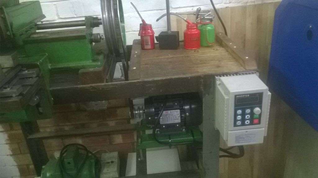

                  I used to own a similar Perfecto shaper, now alas in another’s hands, which was mounted on a not insubstantial angle iron bench fabricated, I believe, by the previous owner.  Having recently successfully retrieved my album photos from the “old” forum site, I am able to show it below in all its new-to-me glory:
                  Machine - left side
                  This was just after I purchased it back in 2016-ish.  It may give you some ideas as to how the shaper could be mounted and the “under drive” belt arrangement was achieved.  I later changed the motor to a ⅓HP 3-phase motor with cheap VFD to enable greater speed control without the need to change the belt position.  Thus:
                  One third HP 3-phase motor and cheap VFD installed

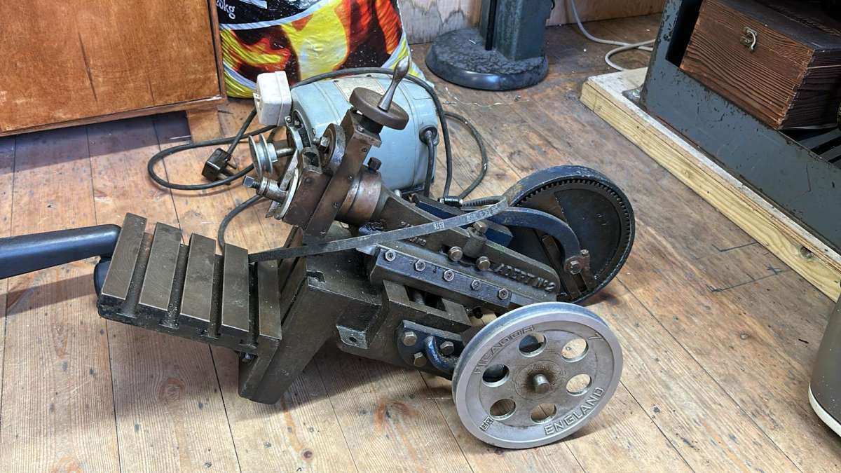

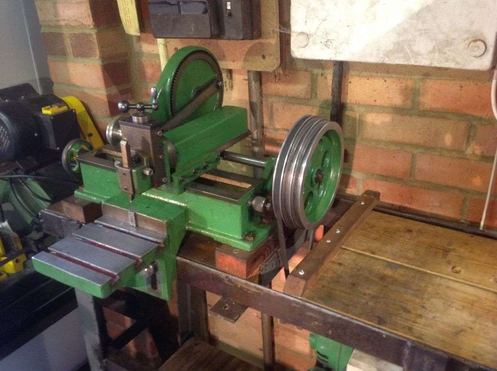

                            Bit late I’m afraid but here are a couple of pictures of a self contained mounting of the one Exeter DMES has. It is for sale by the way.

                                  William – yes the final pulley is similar to a lathe size it would be like a lathe without back gear which is a bit lively. At least further 2:1 desirable.
                                  NDIY you had better not have Dine It Yet – sacrilege to a Drummond. The screw in handle does lend itself to a longer one.
                                  Just now thinking an Adept No 1 would be ever so cute with a motorised copy of its big brother the No 2 above.

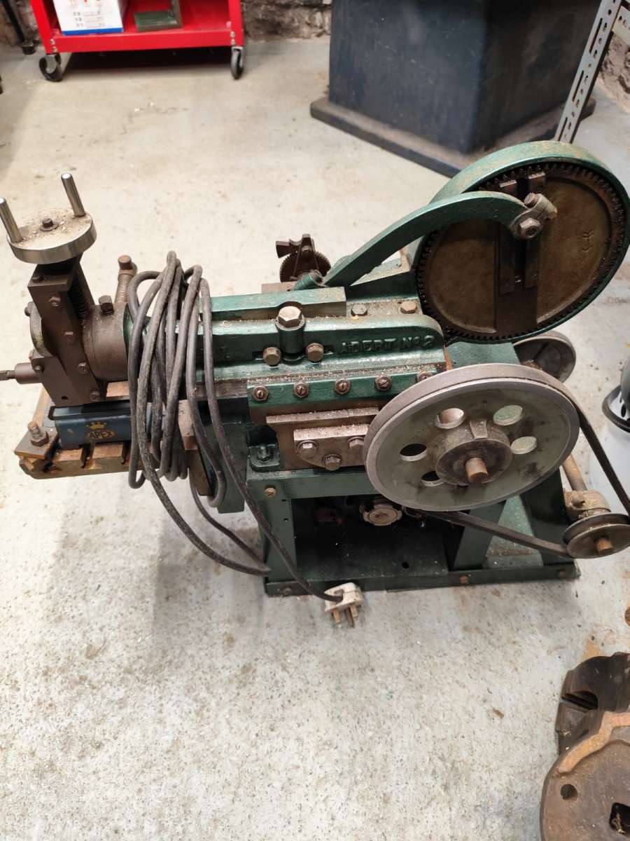

                                    I have finished the micro tapping spindle for my Universal Pillar tool, and so I’m juggling a restoration of the Adept amongst other smaller jobs.
                                    While cleaning, I noticed that all of the parts which make it motorised are coloured a deep Prussian blue, while the main body of the shaper (i.e. all the things which would be present on a non-motorised version) are grey, and there are a few splashes of a pea green (which may be undercoat?) on the ram.
                                    Was this a painting style adopted by Adept, or have I got the parts from two different machines?

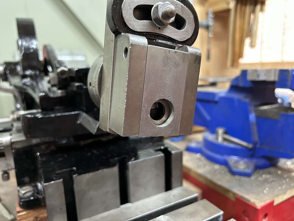

                                    Taking apart the tool holder on the clapper it is definitely not original – rather than the wide base that fits into the circular recess of the clapper inside, it has a very thin-headed bolt – and the tool holder slot is circular rather than square, with no taper. An easy enough piece to make, but curious. I wonder if the original broke?

                                      Mine is a consistent blue throughout. Maybe they sold an upgrade kit.
                                      The previous owner might have made a special holder because they had or wanted to use boring bars, such as the carbide tipped sets you can get. Also they might have seen it as a solution to the tools moving sideways which can happen for various reasons. Alternatively rather than break it  as such they might have stripped the threads. On mine the T-bolts holding the main table must have been done up by a gorilla with a six foot extension bar they are so distorted so I’m lucky he did not get at nay other bolts.

                                                    Overall pics here: https://imgur.com/a/yH6aXFm  – the hinged clapper is 1.25″ x 2’25”
                                                    I still can’t quite puzzle out the ratcheting problem – a few times I’ve tried to change direction I’ve noticed the ratchet pawl is quite stiffly engaged, so maybe there’s some binding in the mechanism? I can’t quite put my finger on it – doesn’t help that the leadscrew thread is left-handed and the ratchet action is the opposite rotation of the travel action. My brain is discombobulated!
                                                    Another puzzlement is the tool-holder – pictures of the tool holder removed from the Shaper are non-existent, so while I’m quite sure mine is a shop-made replacement, I don’t know what the original should look like!
                                                    The stepped hole in the clapper is 3/4″ for 3/16″ deep, then a through hole at 1/2″. The rear counterbore is 1″ dia for 1/8″ deep. Clearly, with counterbores on both sides, a solid tool-holder isn’t possible. I can’t quite visualise what it SHOULD look like, though. Any ideas?
