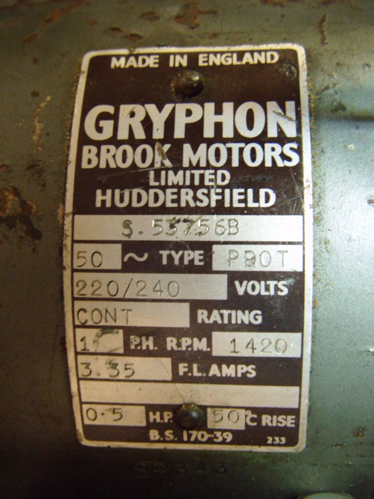

      The wiring on my Myford ML7 consists of a household plug, when you plug it the motor turns. It isn't even earthed. The motor has 4 terminals and no obvious capacitors.
      Three swiches came with the lathe which are not connected. A start, a stop and lockable forward reverse.
      A few questions,
      1) Should the motor have a capacitor, if so what specification?
      2) The stop and start switches are momentary switches, so to use I would need a contactor of some description. Any advise over which contactor to get?
      3) Should I junk that idea and get a Dewhurst switch?
      4) Is running the lathe in reverse useful?
      Thanks,
      Wokaik

            No capacitors needed with that motor, it has a simple start winding. Lower starting and run-up torque than the capacitor start versions but I can't see that mattering on a lathe where you are only spinning up the spindle, chuck etc not trying to drive up against a load.

                      I wired up my motor to my push buttons using a contactor and found that when put into reverse it blows the fuse. I don't think I have wired up the button or the motor incorrectly (however not imune to cocking it up).
                      Having found nothing wrong with my wiring I tried the following, direct from the mains to the motor.
                      Live to bridged A1/Z1 neutral to bridged A2/Z2 = motor spins clockwize
                      Live to bridged A1/Z2 neutral to brided A2/Z1 = fuze blows, I would expect anti clockwize rotation if all well?
                      I measured the the resistace across the terminals,
                      Z1 to Z2 is 3.6 ohm
                      A1 to A2 is 3.8 ohm
                      Z1 to A1 is 0.3 ohm
                      Z2 to A2 is 0.3 ohm
                      I am happy to use the motor in forwards only, sounds like I don't need reverse but is the motor running with reduced power.?

                        Hi Wokauk,
                        I think A1 is bridged to Z1 and A2 is bridged to Z2 internally. Without your bridging wires or any connection to the mains there should be no continuity between the A terminals and the Z teminals if you want to reverse the motor. If there is no internal connection between the windings then the way you say that you have connected it should work. If there is internal bridgeing then when you connected A1 to Z2 and A2 to Z1 there will be a dead short across the mains.

                              Les,
                              The motor did have the terminals bridged, removed them and then hey presto – it works.
