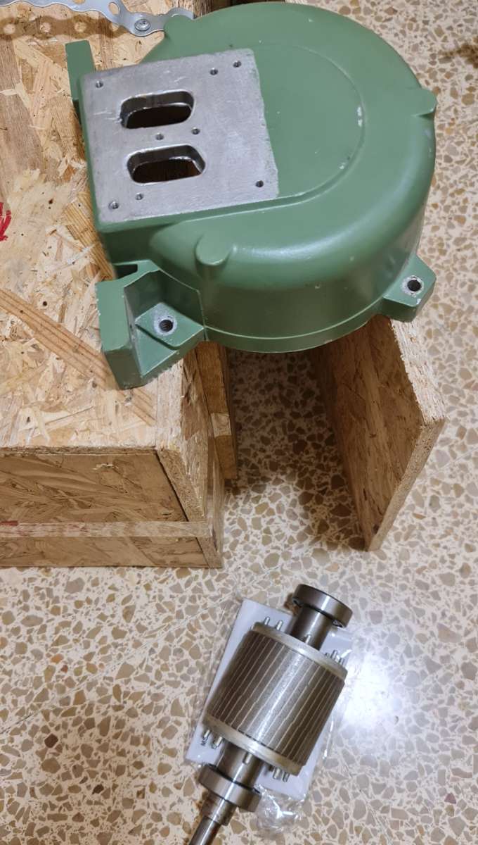

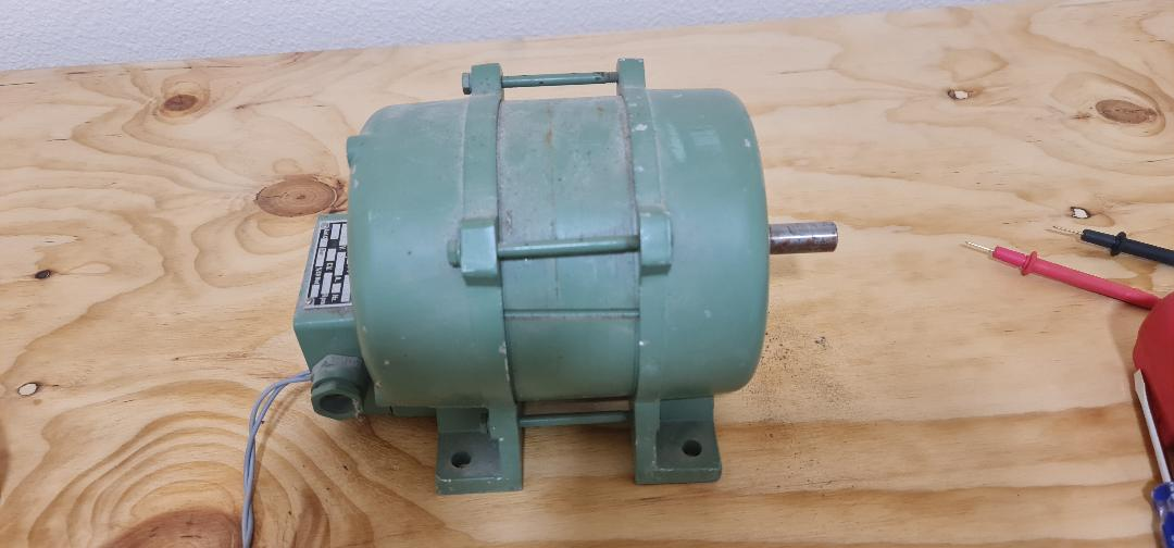

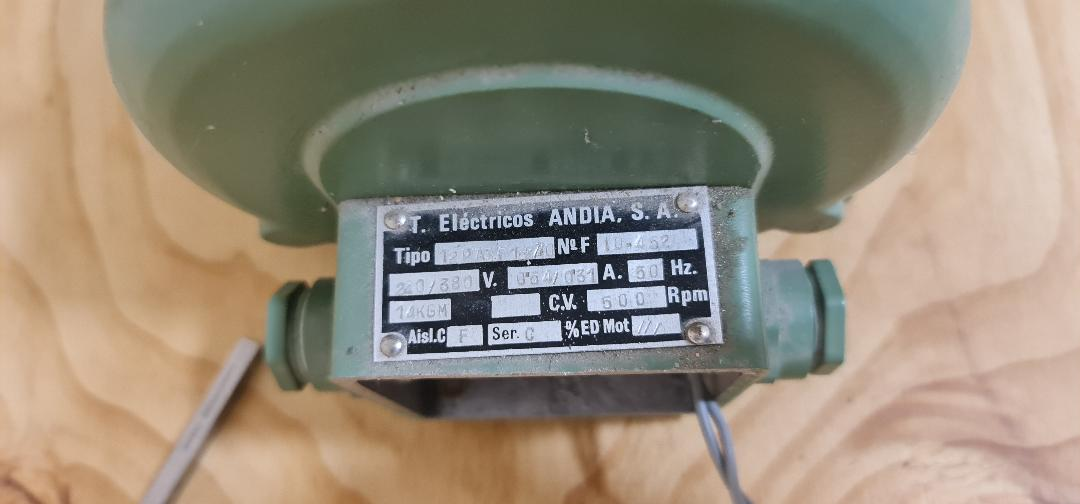

      I want to have a silent low rpm motor, something around 70rpm,  and after a bad experience with a new motor + reducer from a dubious brand I decided to buy something used. Since I lived in Spain now, I picked this motor eléctrico trifásico. I like how it looks without the usual cooling fins. I guess the low power to weight ratio of this motor makes them unnecessary. Since its speed is already so low I think I could reduce it to 70rpm in a single step with a pulley.

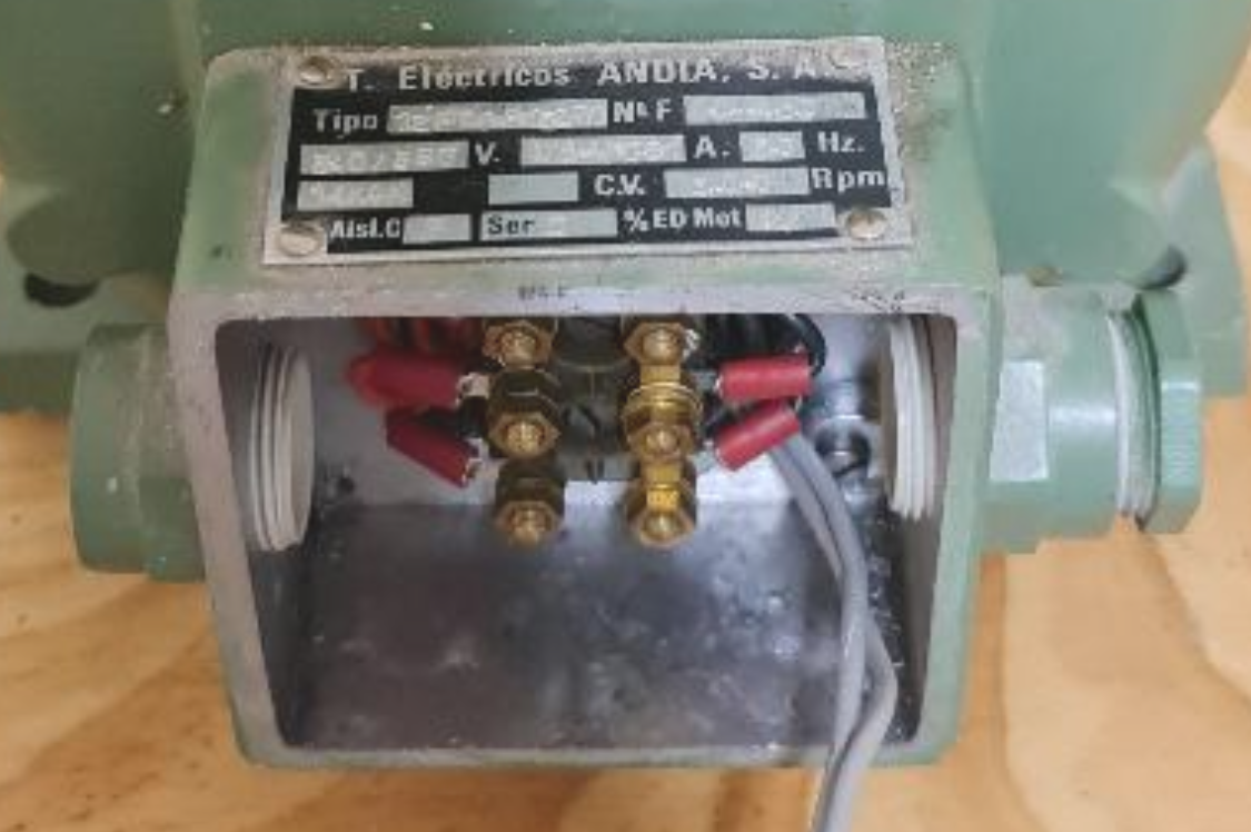

      That pink twisted cable was rolled inside the junction box. There is no marking about it. But when I brought the motor outside the resistance between the two wires was 97Ω and it started to increase. I think there is a temperature sensor inside.
      I don’t have yet my inverter to test the motor but I noticed that it was not spinning very easy. I found this to be strange because I think the motor was not unused since the rubber seals on the junction box are intact. So I had a look inside.

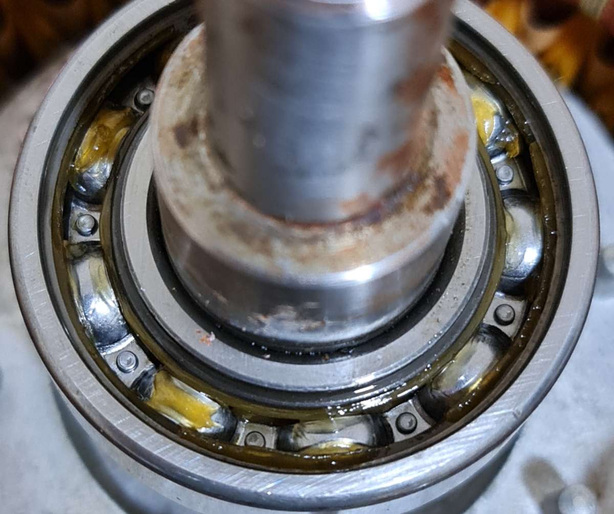

      There is something wrong with the top bearing. I’ve usually noticed that worn bearings feel like they have sand inside. But this is different. It feels like it’s out of grease. And it hangs a little, but it’s always in the same position. Like it has some dent inside. So I suppose I have to replace it? Or I’ll wait for the inverter to come and give it a test?
      Also another thing. I want to have a look on the other bearing. But how I could pull it out? The bottom of this motor is flat. So it sits in a blind hole. Also I don’t know how to pull the rotor with enough force without damaging the windings.

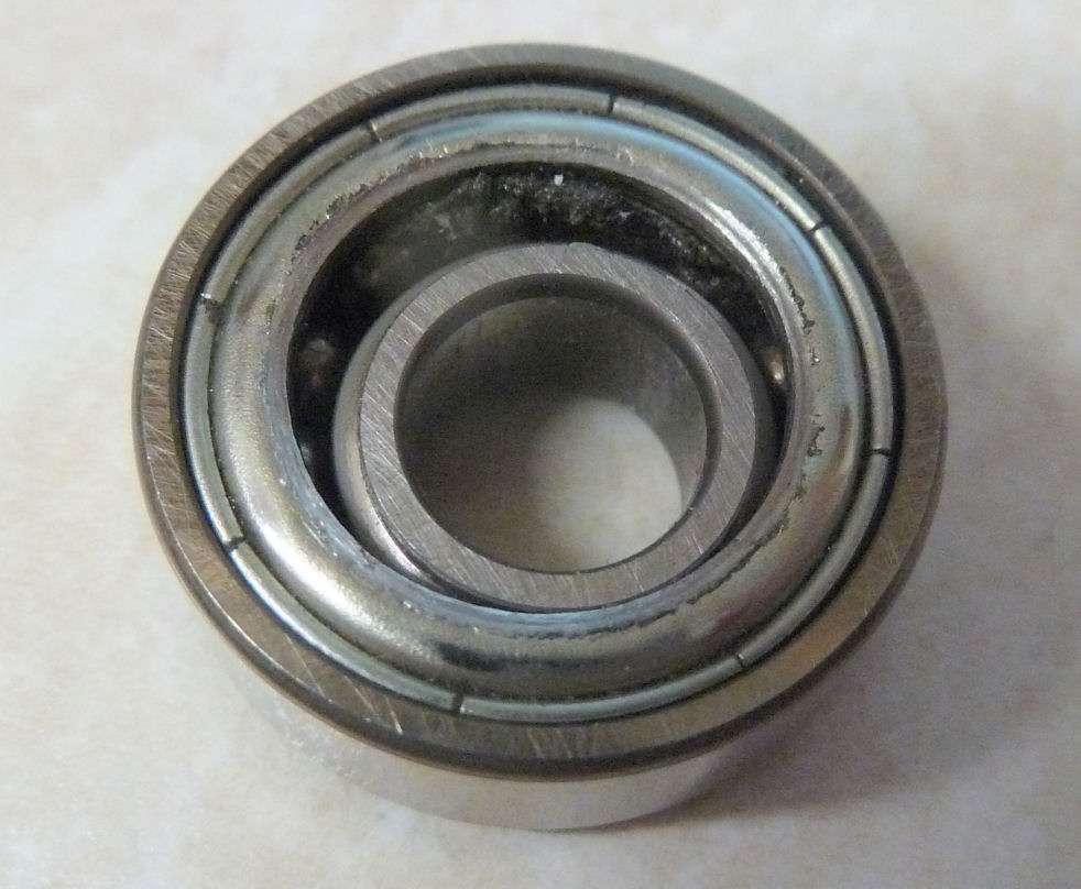

          Also, this is what can happen if a ballrace cage fails. Despite an apparently fatal failure here of this bearing in a vacuum cleaner, it still ran, scraping every second rev. Before it gets this bad there may be a variety of symptoms.BearingCage

            In the video it looks like there are ends of some material protruding out past the lip of the shield – either an internal  seal is damaged or it’s foreign matter.

              Sonic, the action of the bearing in the video is indicative of a bearing that is radially tight by a handful of microns.
              Is there any detectable axial play in the outer ring? If not, remove the bearing and check the shaft seating diameter. This is probably oversized or not very round.

                This is the bearing without the shield. It shouldn’t be more grease inside? I flooded it with WD40 but nothing changed.

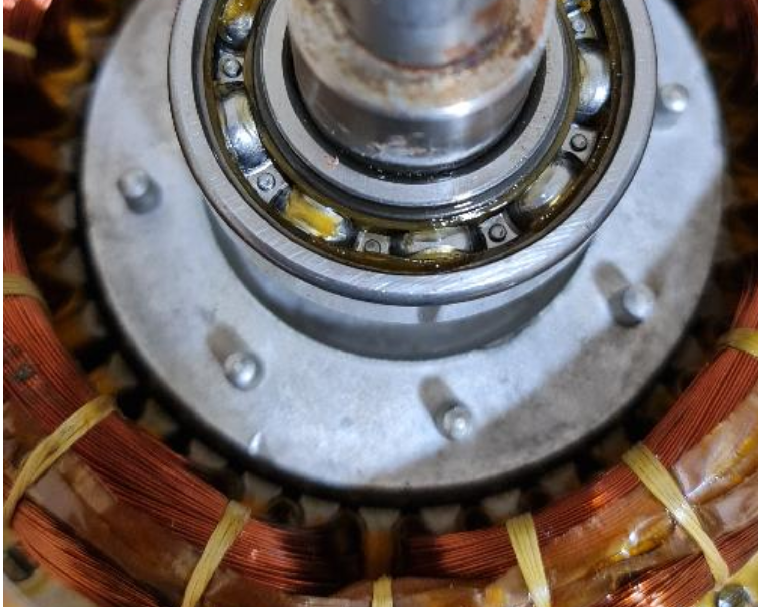

                I was able to remove the rotor from the back cover. Lacking many tools I was creative with the baby lathe wood shipping box.
                Rotor
                Fortunately the bottom bearing remain attached to the rotor instead of the blind hole. This bearing is fine. It feels like a new one. Both have the same amount of play. Barely noticeable. I’m going to order two new ones. Bearings are cheap.

                  In view of the internal condition, this is almost certainly a tight bearing giving that cogging effect.
                  Unfortunately when you remove the bearing, if you are unable to pull it off from behind the inner ring, you could well create some new notchiness from balls being forced over the sharp raceways shoulders. However this will be quite ‘long wavelength’ compared to the notchiness due to the tightness due to a bad seating. I’m sure you will notice a difference though.
                  Yes, you will need to fit new bearings. But you will need to check and correct the seatings first or new bearings will not be quiet.

                    That looks like enough grease. Don’t be tempted to fill the bearing with grease because the churning effect as the motor turns can lead to overheating.

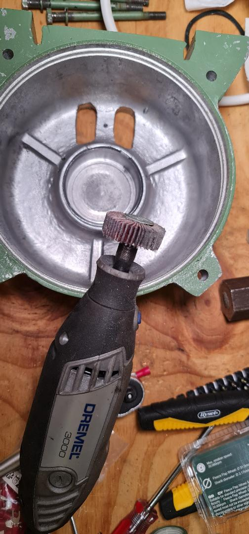

                                        The housing with the wavey washer is a press fit. I think this is the problem. Finally a good excuse to buy a boring head to enlarge it a little.
                                          A quick rub around with some emery paper should enlarge the hole the few microns needed to loosen the fit that tiny bit. Boring would be overkill and likely result in a loose fit.
                                          Or, even better,  gently heat the end casing with a heat gun or hair dryer to expand it and let the bearing race settle into working position as pushed by the wave washer. Run the motor while doing this.
                                          Listening on my phone, I can’t hear enough noise to worry about. But impossible to be sure how that relates to the first hand reality.
                                          #794161
                                          Sonic Escape
                                            @sonicescape38234
                                            Heating the end casing didn’t work. Even if aluminium is suppose to expand three time more than steel. It was a very tight fit. So I tried with Dremel and that thing that I don’t know how it is called. I set it to low speed and after a few minutes I had a nice slide fit. So boring head will have to wait …
                                            Now that clunking sound sound is gone. And an axial load doesn’t change the remaining noise. Thank you for all suggestions. I’m very happy with this motor. There were two available and now I’m considering buying it a brother 🙂
