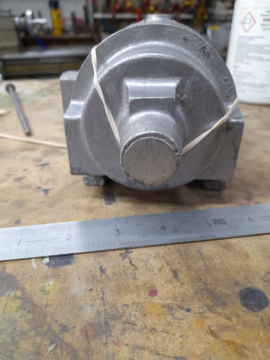

      Hi
      I just got a set of castings for a model dynamo but it didn’t come with any drawings
      It’s 3″ internal dia and about 5 inches long, 3 castings in total
      I can’t find anything on line so wondered if the collective knowledge on the forum might be able to help
      Thanks

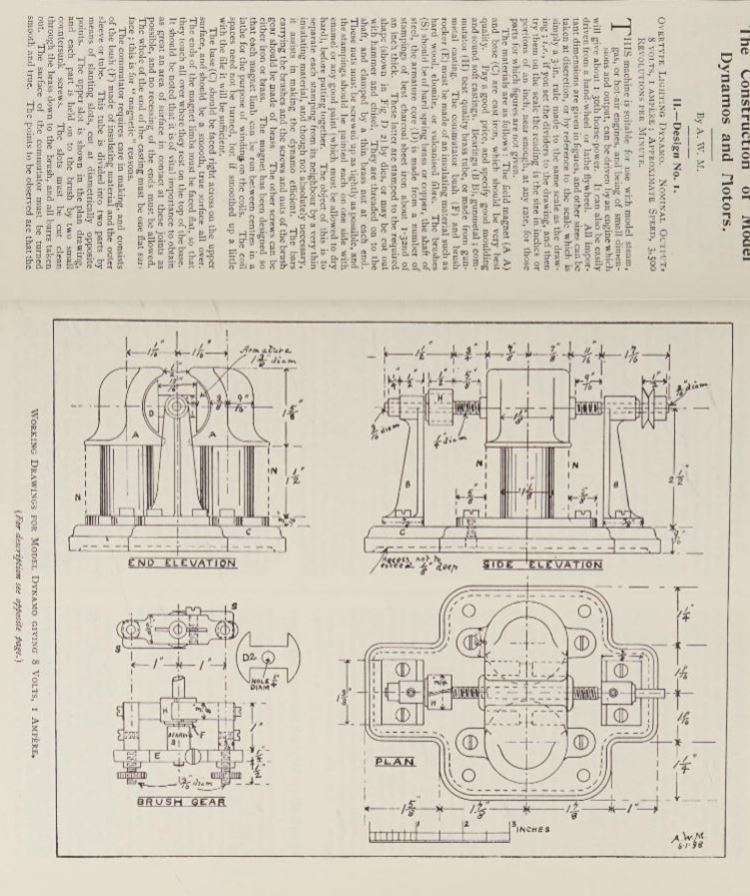

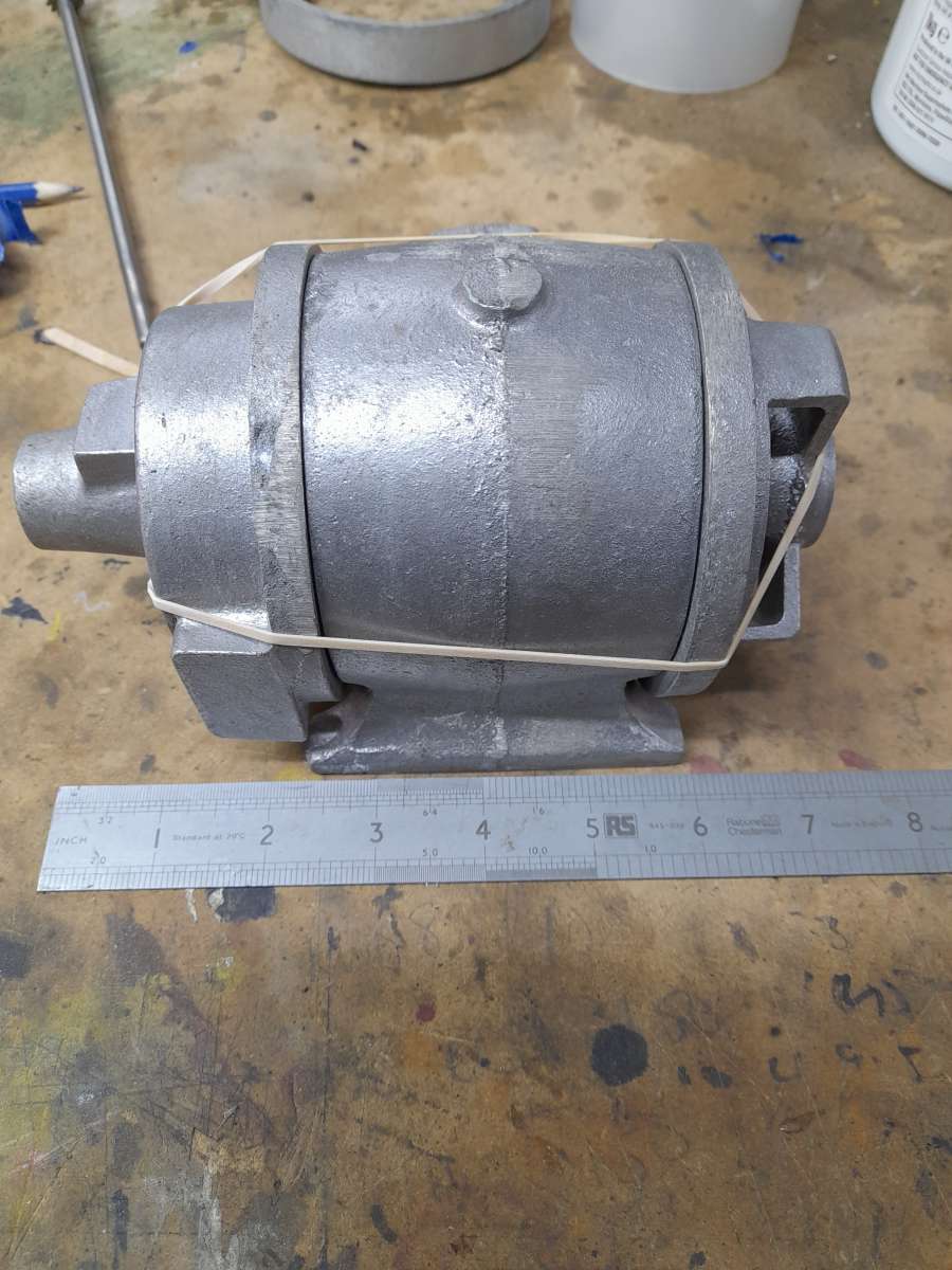

        Post a picture of what you have. Easy option tends to be to find a suitable motor and rip the totating bits out of that then wind your own coils and make the bearings and brushes to suit. That is how the Alyn one is done using a Lucus starter motor.
        Do you have any idea of it’s perantage as to whether it was a commercial kit or just a spare set soemone ran off. The like sof Stevens Model Dockyard used to sell castings as well as several other sources.
        I think I have some more details of this one that could be scaled up if that is the style you have
        dyno 2
        #800672
        noel shelley
          @noelshelley55608
          Very early editions of ME ( the first few volumes )had numerous designs for dynamos though may be not much help in this case they are interesting.  Noel.

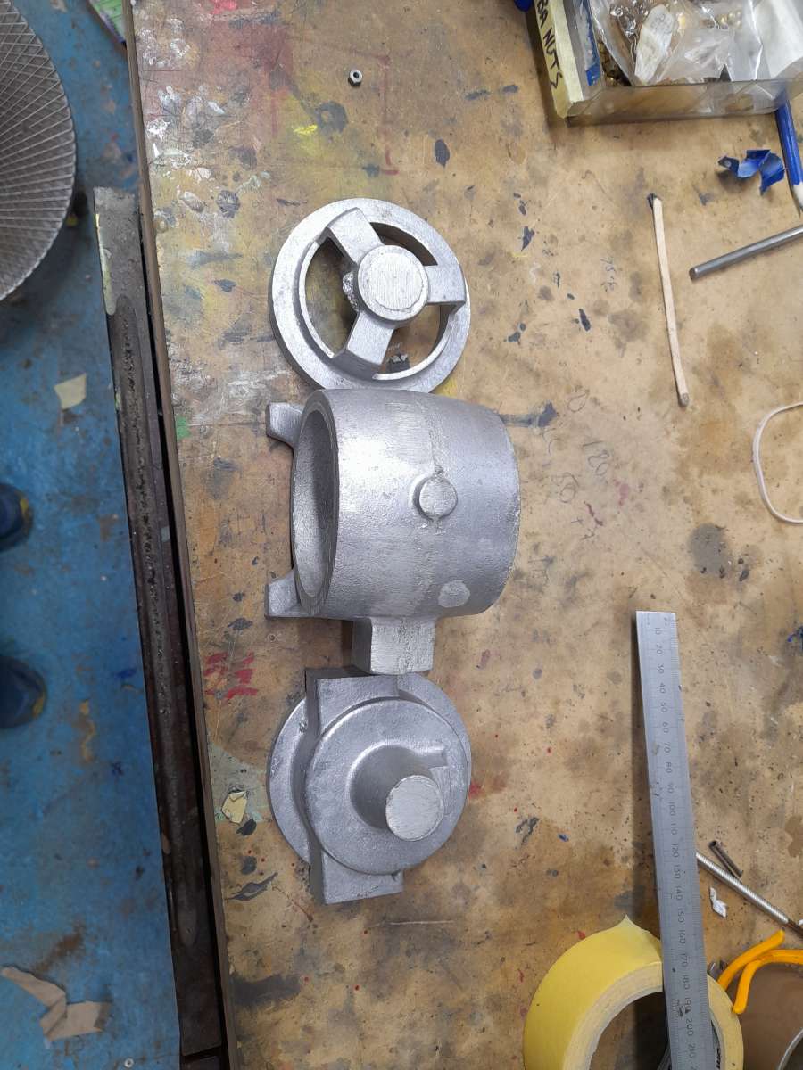

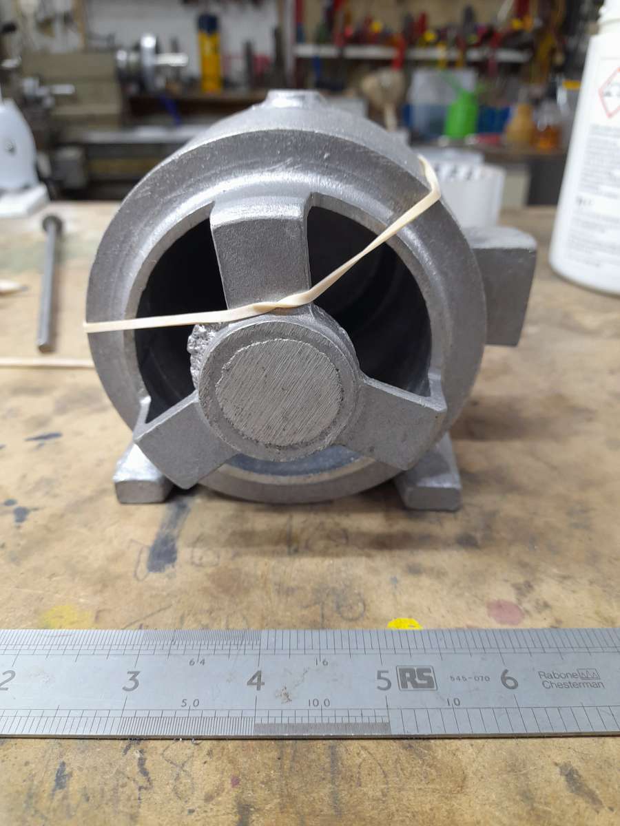

                #801218
                Dougie Swan
                  @dougieswan43463
                  • 20250601_16155620250601_16152620250601_16154320250601_161538
                  #801219
                  Dougie Swan
                    @dougieswan43463
                    Hi
                    These are the castings for the dynamo
                    Sorry for the delay
                    Dougie
                    #801253
                      It looks suitably cavernous to accept any one of hundreds of electric motors, if ‘gender reassignment’ is your chosen path.
                      Actually scratch-building a Dynamo in that casing could be a very long job though
                      … Which path are you on ?
                      #801275
                        That is certainly a big one and I do not recognise it as a published design. Maybe a home casting scaled up from a commercial one like the P M Research Dynamo.
                        If it were me I would work out what the main casting can be bored out to and what the likely lengths are going to be and then track down a suitable permanent magnet motor. Cut the ends off the case and fit that inside the main casting. Then make up suitable bearings for each end and a set of brushes.
                        Much like I did in this thread just larger. I’ll take a photo later of another motor I have that is intended for a larger version

                            I’ve a feeling it will want soemthing with a can diameter of about 3″

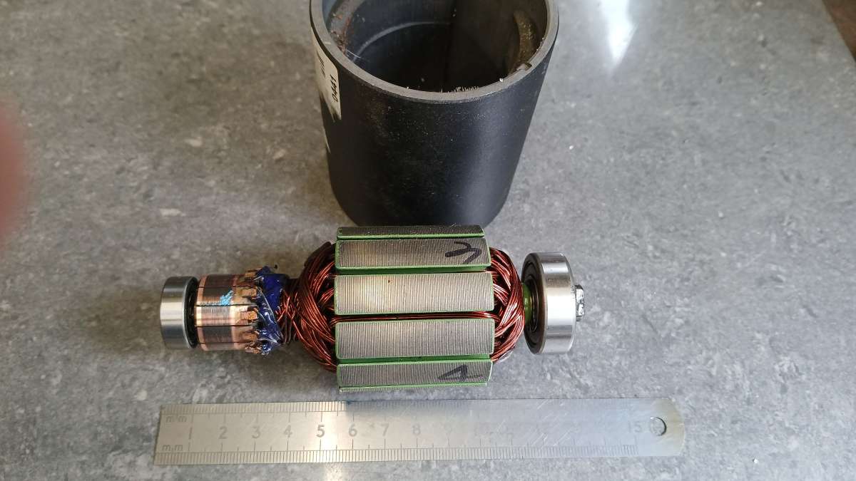

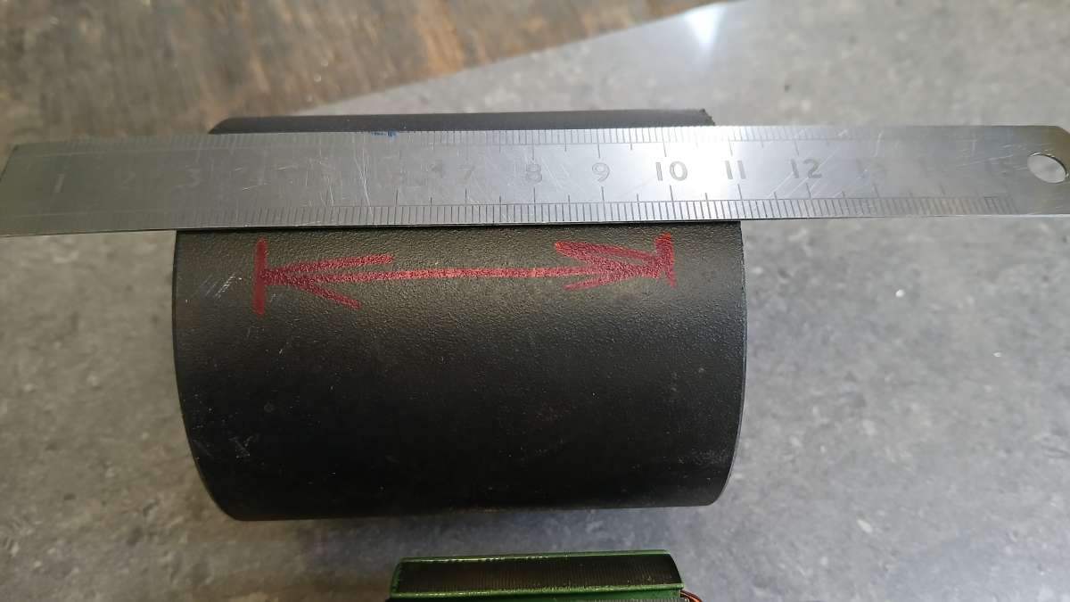

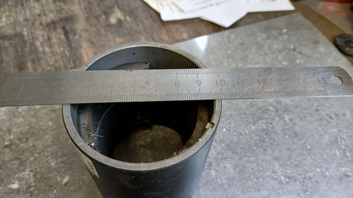

                                #801482
                                  This is the one I mentioned, it came out of a skip but originally drove a bolt on wheel chair power unit a bit like this.
                                  Can is 70mm OD and would trim down to 60mm long which is th eextent of the magnets. You might need to extend the shaft at one end if there is not enough length to get a drive pully on.
                                  20250604_160836
                                  20250604_160925
                                  20250604_160849
