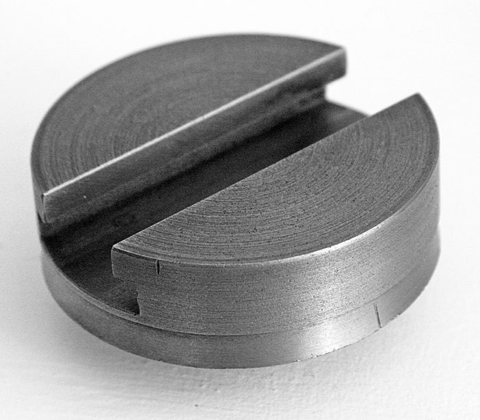

            -boxforduniversal base - 1.jpgKen, what would probably help you is a bas e like the Boxford Universal Base, which has a taper spigot ( like the Super 7 topslide base) on one side, and the usual Boxford fixing slot on the other. See pics
            #307342
            Ken Weeks
              @kenweeks58536
              Hi Robbo
              Thanks for the reply, Yes that would be the one.
              I was after information with regard to layout/dimensions etc to see what was involved in making one.
              My intention is to mount the tool post direct to the sole plate/raising plate without the top slide, making the plate the correct thickness to get the centre height correct.
              I do not have a ML7 top slide base to measure.
              Ken

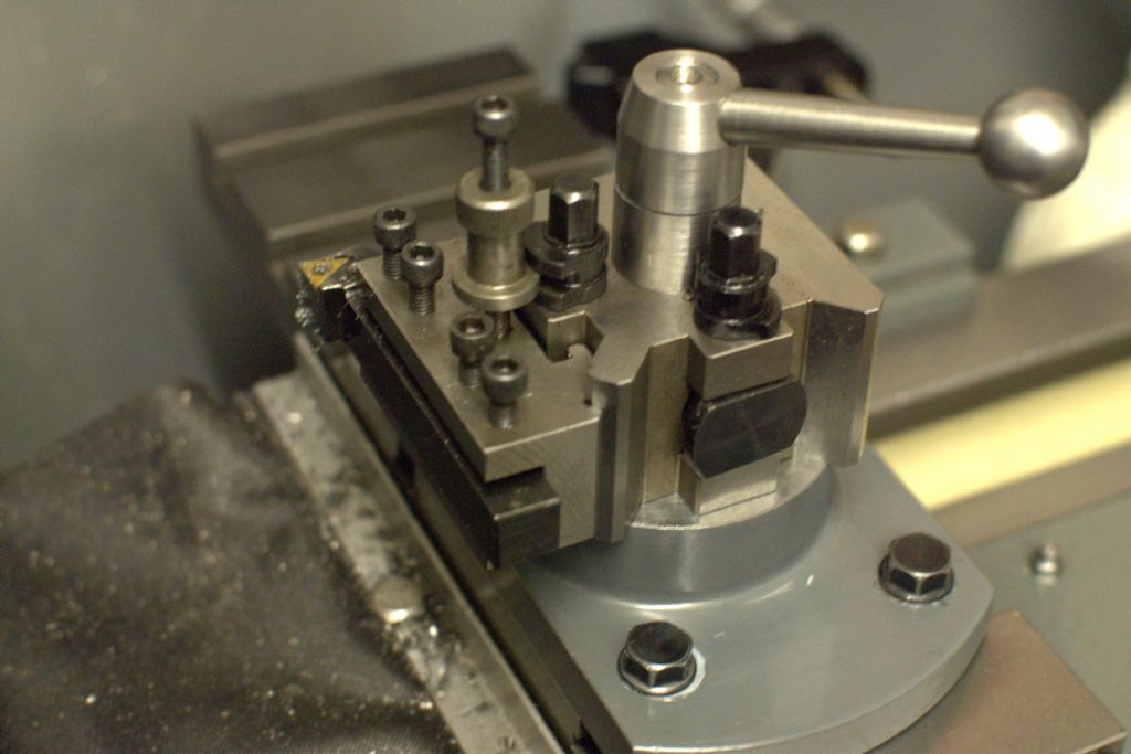

                      Hi Ken,
                      As I tend to use the top slide ( or compound as it was known when I was a lad) very infrequently on my ML7, I made a raising block from a chuck backplate casting.
                      The block is secured to the front 2 "T" slots on the cross slide which puts the toopost stud in the same position as the original. The top surface of the block is machined to be slightly lower than the equivalent height of the top slide so that the Dickson type toolholder can accommodate larger tools .
                      Maybe this is possible on the Super 7.
                      Gordon.
                      Toolpost raising block
                      #307555
                      Ken Weeks
                        @kenweeks58536
                        Hi Gordon
                        Thanks for the suggestion and photo.
                        I have been trying to think of other things that could be used.
                        Good bit of thinking outside the box.
                        Robbo has a ML7 top slide base which I think will do the trick.
                        Ken
                        #307664
                        Robbo
                          @robbo
                          Ken
                          The ML7 topslide base has those curved slots which will match up with the T-slots on either ML7 or Super 7 croo-slides.
                          So maybe you can take off the S7 topslide complete and mount the toolpost on the ML7 topslide base and hold it with a couple of T-bolts. Might need to make a bigger spigot on the underneath to fit the bigger hole in the S7 slide for positive location.
                          Problem is this seems too easy, can't possibly work ! crook
                          I'll put a bit of T strip in for you to try.
                          #308008
                          Ken Weeks
                            @kenweeks58536
                            Hi Robbo
                            As you suggest my intention is to remove the S7 top slide assembly complete.then fit the tool post to the ML7 base.
                            I have a plug for the hole in the S7 cross slide, an appropriate size hole can be bored to fit the ML7 spigot.
                            Thanks to you for all your help, and everybody who took the time to post.
                            Ken

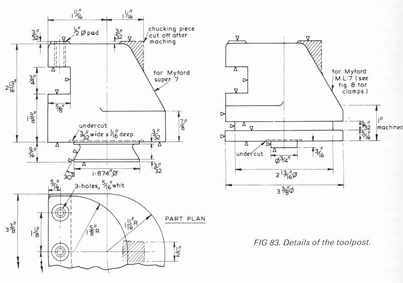

                            #312336
                            Ken Weeks
                              @kenweeks58536
                              Well they say everything comes to he who waits.
                              I have recently obtained the three volumes of "In the Workshop by Duplex (I love old books) .
                              On pages 152 to 158 of volume three chapter nine "Machining V-Pulleys" are details complete with drawing of making the sole plate.
                              Typical now I have solved the problem another way.
                              Looking at the date of the book 1949 I would think it appeared in Model Engineer about that time.
                              Ken
