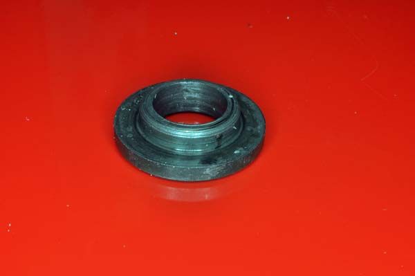

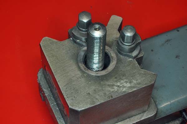

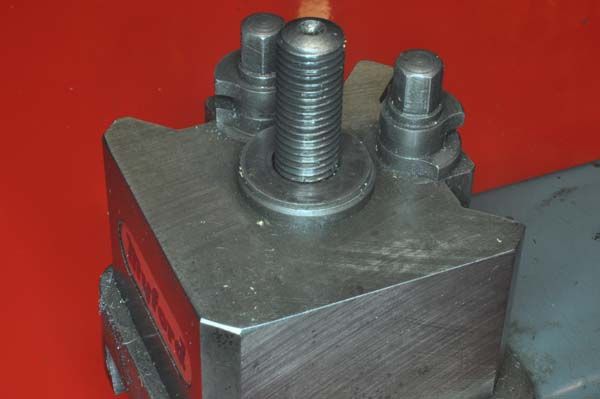

                Not sure if this is relevant but on my S7 the hole in the QCTP is much larger than the stud in the topslide.
                The kit included a top hat washer
                This works very will, no movement of the QCTP when tightened down.
                HTH,
                Rod
