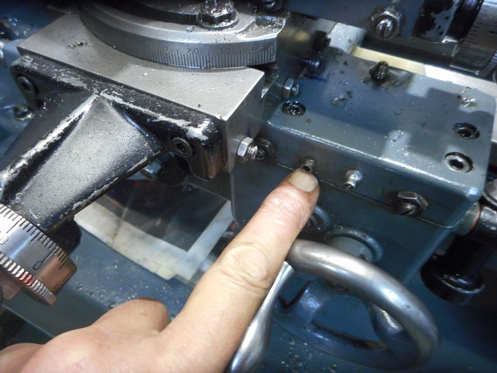

        Hi, I’ve just taken possession on a 1950’s ML7 to accompany my Bridgeport mill. I have found that the carriage hand wheel (the one on the side that moves the carriage back and forth) is exceptionally stiff, so much so that at times I need two hands to turn it. It seems to be okay when engaged with the screw gears and when disengaged the leadscrew turns freely. Could someone please give me an idea as to what the problem maybe? From what I’ve seen the the wheel should move the carriage with little effort. Thanks.

          could it be swarf in the pinion which engages with the long rack beneath the bed.

            Just a guess. Maybe the half-nut mechanism swivels due to wear or maladjustment and wedges.
            If the nut is at all visible where it engages the leadscrew, it might be possible to see it tilt and wedge when the handle is turned. The state of the half-nut threads is worth checking. With luck stuffed with easily removed swarf, on a bad day, the threads are badly worn.

              Doubt if it's the half nuts most probably swarf filled hand wheel pinion and associated gears /rack. Easy to remove and clean up, you could clean up the half nuts at the same time and also see how they are adjusted. Good job its not power crossed that would be a different ballgame.Look at Myfords site the exploded parts diagram is helpful.

                Probably a stupid question but you don’t have the saddle lock tightened do you?
                Its the bolt on the back of the saddle to the right of the cross slide.

                    Are the gibs too tight?

                      I would not go stripping it down at this stage. It is not a beginner's job and can cause more problems than it solves. The stiffness will be some simple thing. All you need to do is go through and check/rectify the simple things one at a time without disturbing the whole show..
                      Tap on the carriage lock at the rear after loosening the locking bolt to make sure the lock disc is not jammed up.
                      Squirt WD40 in around the handwheel pinion and shaft.
                      Check there is a bit of end float slack on the handwheel pinion shaft. I don't remember now if that handwheel is held on by a pin or a grub screw. If a grub screw, you could move the handwheel out a fraction to create clearance.
                      Use a brush to clean any swarf from around the pinon and rack.
                      Check the carriage gib adjuster screws and readjust them a bit on the slack side for now. You can tighten them up later after free movement is achieved. And check if the previous owner has added the common extra locking screws in between the original gib screws. These could have been left half tightened etc. A common mod when milling in the lathe as it gives a better, more accurate lock than the rear bolt.
                      Check the felt carriage/bed wipers and remove them for cleaning if full of swarf.
                      Loosen the screws holding the rack that the handwheel pinion engages with and allow it to move upwards to create a bit of clearance between rack and pinion.
                      Check the Allen screws holding the apron to the saddle are tight. Or if they are tight, try loosening them off and see if that frees up carriage movement, indicating that some shimming is needed between the saddle and apron.
                      Let us know how you get on.

                          It might just need one or both of these locking screws backing off
                          Or one of the gibs screws like the one next to it with the hex lock nut.

                                So, took the apron and saddle off and it appears my father in law used grease in the nipples instead of oil, consequently it was a gummed up. Gave it a good clean cleaned out the oil ways and the nipples, slide way oil on the bed, I used HT 46 instead of 32 as that was all I had. All seems perfect now. I need to get an oiler from somewhere and some HT32 and all should be good. Thanks everyone for your help.
