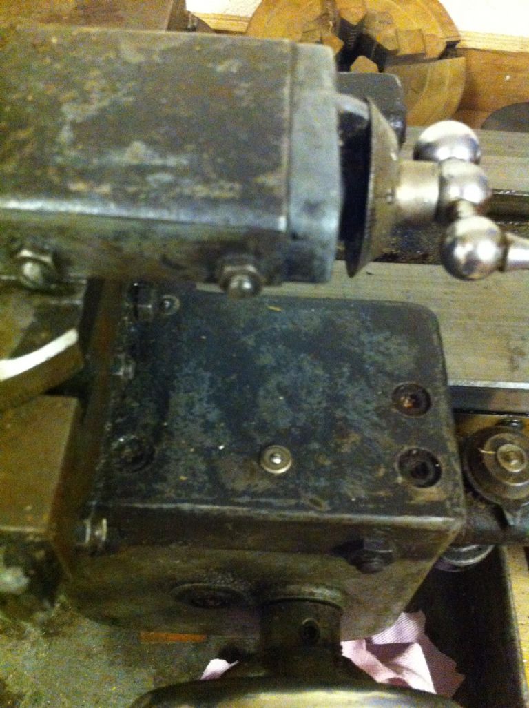

      Another question – sorry and thanks!
      My ML7 has raised nipple oil points on the countershaft / drive area but almost flush oil points on the saddle / slides etc.
      I don't have an oiler yet – do I need two to cope with the different geomety of the points as raised nipple types on the saddle would be a pita + I can't see an easy way of removing the old ones as they are flush with no means of applying any torque to them.
      As ever, help appreciated.
      Simon.
      Edited By Simon B on 24/11/2012 10:21:09

              Some photos to see what I mean:
              Edited By Simon B on 26/11/2012 20:48:21

                Simon,
                use a 1ft of clear plastic tubing (windshield cleanner nozzle)
                Push it over the oil nipple and maitain it with the hand (the oil pressure push it out)
                d'ont forget to oil the back gear mechanism (2 points)
                pierre
                #104772
                Terryd
                  @terryd72465
                  Hi Simon,
                  The nipples on the countershaft are not for oil but are grease nipples and are intended to be used with a grease gun. The simplest push type has a cupped end to fit the nipple and the pressure of pushing the telescopic gun seals and pushes in grease. There are ones such as the Wanner lever gun which clamp on to the nipple and have to be released after use. The latter are too high pressure for this application a simple push type would be best. I don't know what grease is recommended for this application as I have not had anything to do with Myfords for 40 + years.
                  The 'flush' ones are ball oilers, just push the nipple of the spout of the oilcan onto it and squeeze the trigger. The ball is sprung and will let oil in but keep dirt and swarf out.
                  Regards

                    Terry,
                    Thanks for this – I was under the understanding all points were for oil and the only applicatrion of grease was onto the gears directly? Have I got this wrong?
                    Simon.

                          #104780
                          John Stevenson 1
                            @johnstevenson1
                            Sorry Terry, they are oil nipples, they have no undercut for the end to snap on.
                            It's been a bain of every Myford owners life that the OIL gun supplied with a Myford leaks when filling this nipples, given is a metal to metal push fit it's hardly surprising.
                            John S.

                                Hi John,
                                Having looked closer I see what you mean I thought that they looked like button headed grease nipples. My eyes take a while to get working in the mornings these days sad. Perhaps it may be an idea to swap for grease points rather than oil?
                                Regards

                                              How did you gat the original spring ball oil tips out? Are they screwed in or a push fit. The flip top oilers sound entirely sensible.
                                              Oh BTW, the photo up top shows what looks like grease nipples on the counter shaft. I dont think grease is a suitable lubricant, too high a speed on plain bearings
                                              Cheers

                                                Hi Simon B.
                                                My ML7 is fitted with oil nipples throughout, they are screw in and are 2 ba thread size, as you can see I've recently fittted new ones.
                                                I do not know if the sprung ball type nipples on your machine can be removed easily, but you could try phoning Myford for advice.
                                                The lubrication chart (in manual) shows some 17 points which need an oil gun.
                                                Generally speaking I would suggest you get an ML7 manual from Myford Ltd, or Ian Bradley's 'Series 7 manual', which I think has been re-published.

                                                    Posted by Robin teslar on 27/11/2012 18:00:57:
                                                    I had oil nipples exclusively on mine and they just unscrewed (2-BA thread).
                                                    The oilers (eBay) had M6 threads which I turned down and threaded #10-32 UNF which is what I have here and is close enough.
                                                    The Myford manual for the ML-7 (with exploded parts diagrams and parts list as well as lubrication info) is kicking around the internet as a pdf in various places if you don't already have a copy. The relevant Yahoo group(s) used to have it. PM me if you have any problem.
