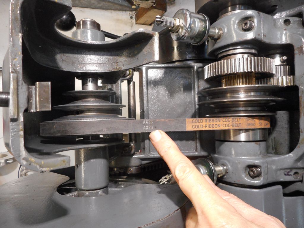

        #632064
        Hopper
          @hopper
          I don't remember any problem getting that large countershaft pulley off mine when I did it up some years ago. It is held on by a woodruff key and one grubscrew. Trick with those types of pulleys is to never put force on the outer rim. If you have to use a puller, hook it up to the central hub, or a metal plate or bearing puller clamshell behind the central hub. And heat from a propane torch should be enough to make it fall off without a puller anyway. Cheap torch that clips on to a disposable can of gas will do the job.
          From memory, the keyway in the three-step pulley goes all along the bore so it can come off either way. It has two grub screws that need removed first. Same as above. Don't put pullers on the outer flanges. Support the inner solid part of the pulley, heat it, and tap the shaft out.
          You don't need to pull it apart unless you plan to replace the Oilite bushes. A clean out with solvent and re-oiling should do the job if grease is the only concern.
          When fitting a new belt, it is worth getting the "cogged" V belt that has the notches around the inside diameter. They run better around the tight bends of small pulleys like the Myford's.  They are AX series belts rather than the standard A series. You can see the belt in this pic.

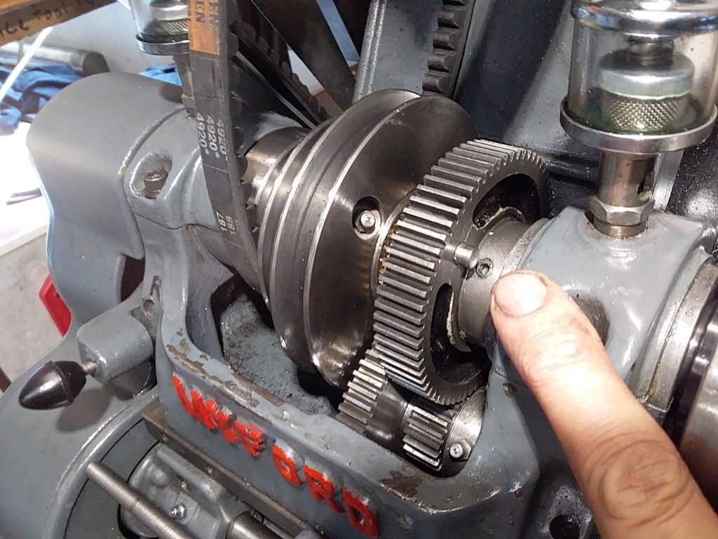

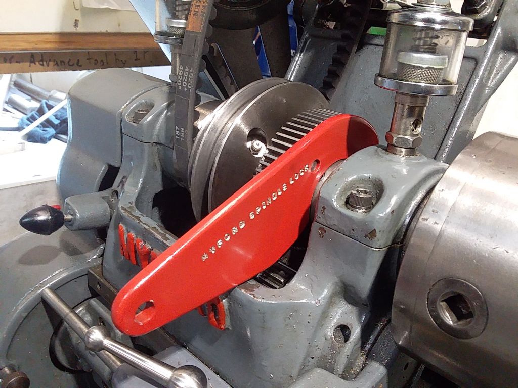

                Hopper
                  @hopper
                  And i forgot to mention is easiest to take the whole belt tensioning H-frame off the lathe and work on the pulleys and countershaft on the bench where you can properly support the pulley while tapping out the countershaft.
                  Stuck chuck. If you grip the spindle in the vice be sure to do it b between where the bearings go so there is no risk of damaging the bearing surfaces. Hard to get good grip like that though. I would try to loosen it up with the spindle still in the lathe. Myfords recommended way is to grab the belts and spin the spindle backwards with a block of wood under one of the chuck jaws so it smacks into it. Not sure how much force you get like that though.
                  If you look in the photo I posted above I am pointing at a pin I drilled and either threaded or Loctited into the bull wheel (don't remember which) and then made a tool below that locks the spindle for chuck removal. YOu can do something similar by jamming a block of wood between the little Allen head screw on the back gear drive dog and the headstock casting. Then you can put a length of wood between the chuck jaws as a long lever to yank on. Heat might help too. Be careful not to overheat the spindle and melt the white metal bearings though. Heat the chuck body only.

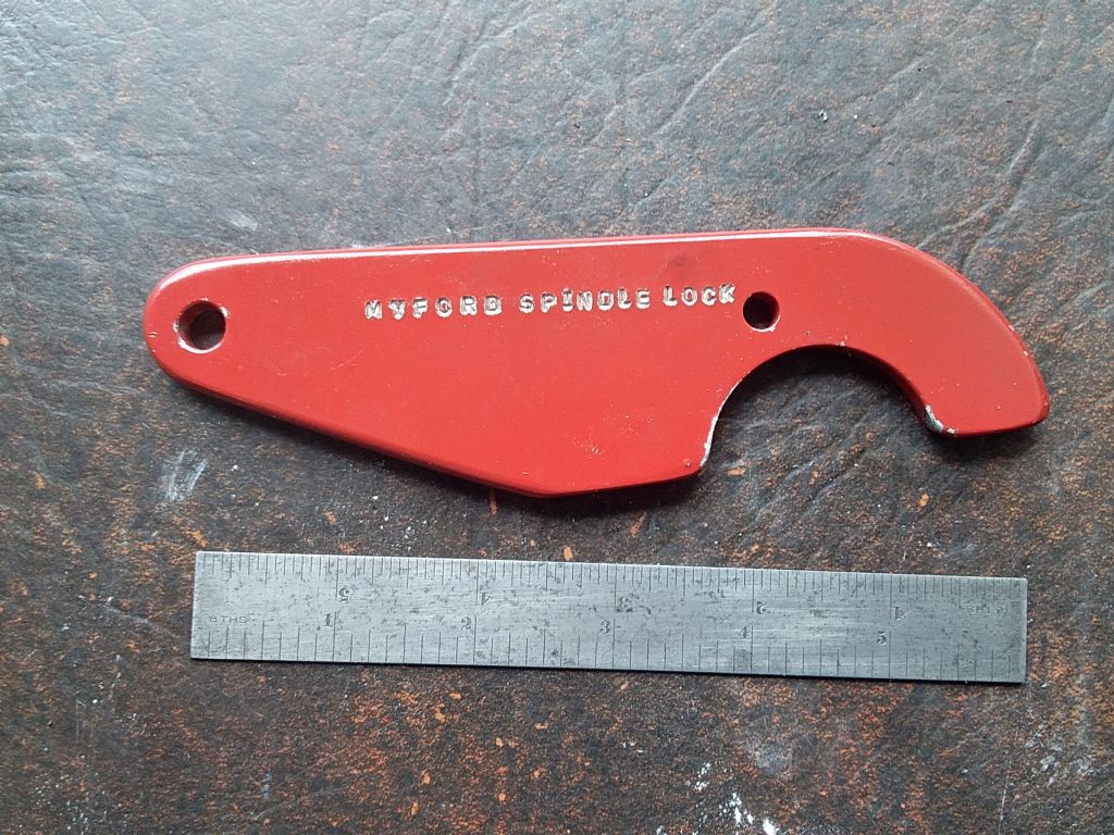

                    #632091
                    Hopper
                      @hopper
                      Yes. The Super 7 has a spindle lock but the ML7 was the budget model when it came out in 1946 and never changed much. I reckon Myford sold a lot of new backgears over the years as a result.
                      Tell your mate to keep the spindle thread and chuck threads lubed with Never Seize etc and it should not happen again. (There was a thread on this recently with many varying opinions on what works best for this but this is what works for me!)

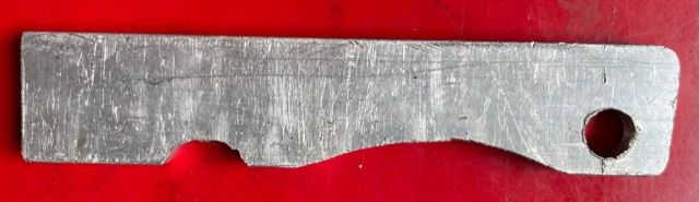

                                    Simon Collier
                                      @simoncollier74340
                                      All done but a brain teaser. I made a split spacer to go around the shaft and against the pulley with room for the key and used the press to push the shaft with key clear of the pulley. It took a lot of force. Then the problem was obvious and you are right: someone had tightened up the two grub screws, missing the slot in the shaft and catching the edge of the slot, raising two huge burrs that would have help up an elephant. I filed them flush and tapped out the shaft, freeing belt and pulley. A good day, first the chuck and then the pulley. I was surprised how soft the countershaft steel is.
                                      By the way, the chuck is a Griptrue. Also, the tailstock has the Myford lever attachment. The cross slide is the long one, and he has 4 jaw and fixed steady, faceplate and boxes of more stuff. 4 way tool post. Not bad for a gift from another member.
                                      #632545
                                      Simon Collier
                                        @simoncollier74340
                                        This is the tool from 6 mm Al. It sits in the bottom of the casting. Slots for spindle and oiler. The two front bolts holding the headstock casting on are missing!

                                        Hopper
                                          @hopper
                                          That's a good result, mate. Yes the shaft is just a piece of cold rolled bright mild steel bar, nothing special. Very easy to make a new one from a piece of stock without need to machine the OD. A typical Myford piece of frugal but practical production engineering.
                                          Sounds like the young fellow made a great score. The lever tailstock and especially the long cross slide are very choice upgrades and rare here in Australia. And the Grip Tru chuck is the Holy Grail. Very nice. And it is good he has someone like yourself and obviously other club members to help him make the most of it.
                                          Good idea on the locking tool. I'd be replacing the missing headstock hold-down bolts asap. Most probably BSF threads but I have never had mine out so not sure. Can be a bit of a hunt to find BSF these days but they are around. Myford still sell most parts including bolts but the shipping has gone through the roof in the past 3 years.
