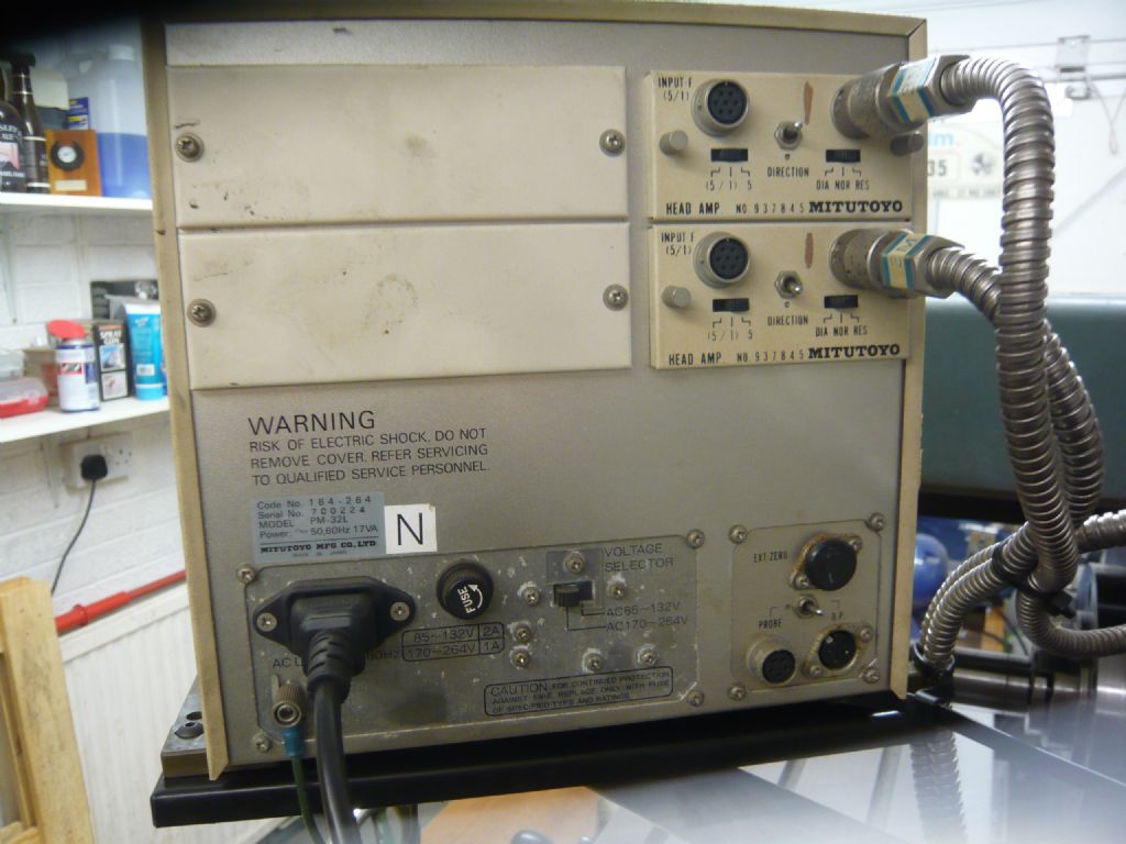

        I have a Tom Senior Major milling machine with 2 axis DRO. One of the scales is not working but If I swap the inputs for X & Y then I get a reading which indicates to me that one of the amplifiers is not working.
        However, operating the metric/inch button shows that the display is changing.
        Can anyone suggest what might be wrong?

            This DRO uses a separate amplifier for each channel, with it's own connection to the scale, i.e. the parts fastened to the milling machine tables.
            The X axis shows no change, just a series of zeros . The Y axis works as expected.
            I tried swapping the connections to the amplifiers and this confirmed that the scales were working so the fault must lie with the X axis amplifier.
            I tried swapping the amplifiers and this confirms that the X axis amplifier is not working, but some of it is! If I press the metric inch button then the number of displayed digits alters on both displays.

                      Les Jones 1
                        @lesjones1
                        In your first post I got the impression that each scale connected directly to the DRO (The unit with with the displays for the 2 or 3 axis's and the buttons for setting zero points etc.) I interpreted your use of the word amplifier as the internal circuits on the DRO that convert the signals from the scales to the logic levels that connect to the internal micro controller. I am assuming the scales are glass quadrature scales with 2 or possibly 3 output signals that are either sine wave or square wave. Are you now saying that the output of each scale goes via an "amplifier" before feeding the inputs on the DRO. Can you clarify how things are connected together with a block diagram.
                        Les.

                        Brian H
                          @brianh50089
                          Hello again Les & thanks for the message.
                          I thought that a couple of pictures might be appropriate here.
                          The first one is the back of the display unit (which is 2 axis) and the 2nd one is of one of the amplifier units. There are 2 inputs on the back of each one and the difference is the resolution of the scale.
                          Thanks for all help
                          Brian
                          #437626
                          Stuart Bridger
                            @stuartbridger82290
                            Having the modular amplifiers should help in diagnosing the location of the fault.
                            I suspect that you should be able to just swap the ampliifiers between slots.
                            So take one scale input (you know these are good) plug into each amplifier in turn. Then swap the amplifier modules between slots ans see if the fault stays with the slot or moves with the amplifier.
                            While you are at it, it would be worth reseating the connectors from the back panel to the PCB and also give the edge connector a clean

                              My understanding is that you have swapped over the two cable connections at the top right and this proved that both scales work on one of the inputs but neither works on the other input. You should now be able to prove it the fault is one of the "amplifiers" or deeper inside the DRO by swapping the positions of the "amplifiers" in the DRO. So does it always fail with the top position (For example.) or does it always fail with the "amplifier" that WAS in the top position (For example.) ?
                              Les.
                              #437638
                              Brian H
                                @brianh50089
                                I have swapped over the plugs and find that the display that previously worked, now doesn't and the one that previously didn't work, now does.
                                I then swapped the actual amplifiers with similar results so to me, that would indicate a fault with some part of the amplifier but not a total failure because switching from metric to inches results in the correct number of digits and even the decimal point changes position correctly. There is a switch on the back of the unit that changes from 'Normal' to 'Diameter' and when switched to 'Diameter', both displays show a small 'D' at top left.
                                Hope that helps
                                Brian
                                Edited By Brian H on 17/11/2019 11:16:30

                                  Posted by Brian H on 17/11/2019 11:10:00:
                                  Hope that helps
                                  Maybe. It suggests a cable or connector fault to me rather than electronic trouble.
                                  No disrespect but the style and condition of the unit hint that it's been round the Sun a good few times since it was new! The problem may be dirt, corrosion or ageing of a joint that wasn't quite perfect on day one.
                                  As the plugs and cables are proper armoured industrial gear, I think it unlikely anything has given way internally inside them, though dry-joints are always possible. Solder joints in electronics should be shiny silver, never grey and crystalline looking. Any crystalline joints should be remelted with a dab of fresh solder. A bad case might need to be de-soldered so the metal underneath can be cleaned before the joint can be remade properly.
                                  Rather more likely is dirt and corrosion on the male and female parts of connectors causing intermittent or broken connections. Sometimes it's enough to recover metal to metal contact just by removing and replacing plugs a few times but I'd clean the whole lot carefully with q-tips and switch cleaner. Not just the panel connectors but the metal innards of the plastic plugs and sockets on the board as well, plus the board's gold-plated contacts on the other side.
                                  Although the electronics are in a proper box, it's also possible that decades of dirt or a barely visible whisker of swarf has managed to bridge a track on the board. Again, a gentle polish of both sides of the board with switch cleaner might clear it.
                                  #437668
                                  Dave Halford
                                    @davehalford22513
                                    Brian,
                                    Given you now say swapping the plugs swaps the fault proves the display unit is good.
                                    That leaves you with a broken wire or a dead bulb or led in the scale or SOD's suggestion a dirty plug.
                                    If this machine is new to you it's possible someone has stressed the lead during transport or removal, if you have had it some time then the lead is probably fine.
                                    You can normally remove the end of a scale and slide the read head out. If the scale or head is gunged up with oil, then it may only need a simple clean with meths. The head has a lens that focus's the light ( visible or IR) onto the reader so both the lens and the reader must be clean as well as the glass scale.
                                    #437686
