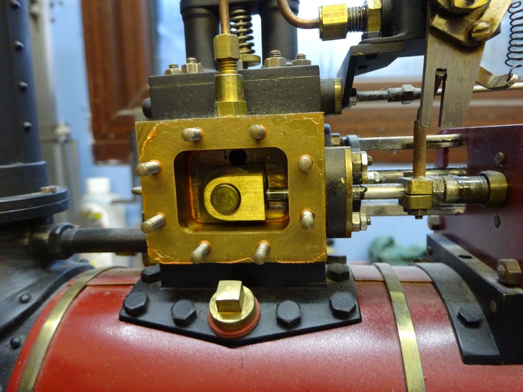

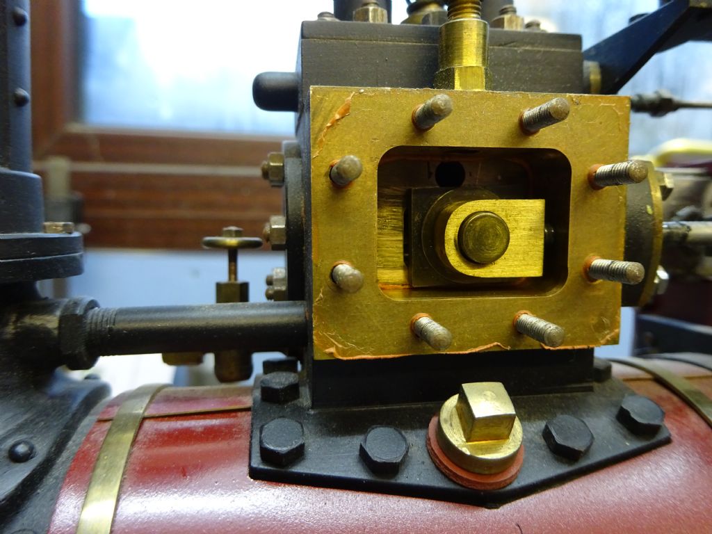

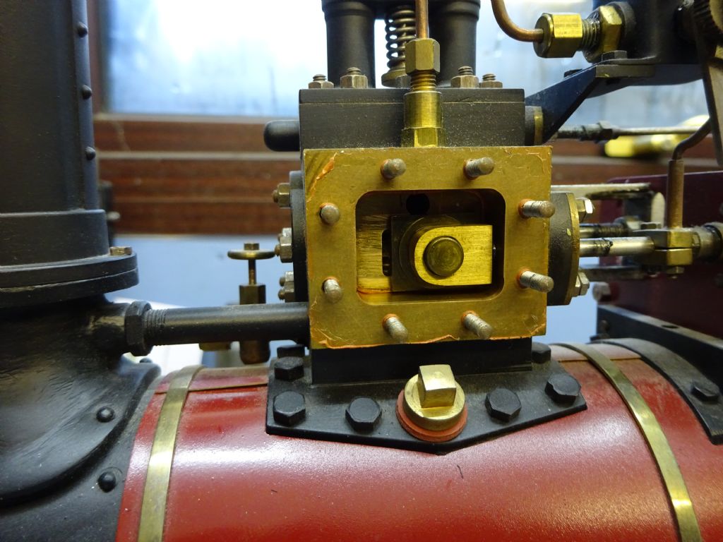

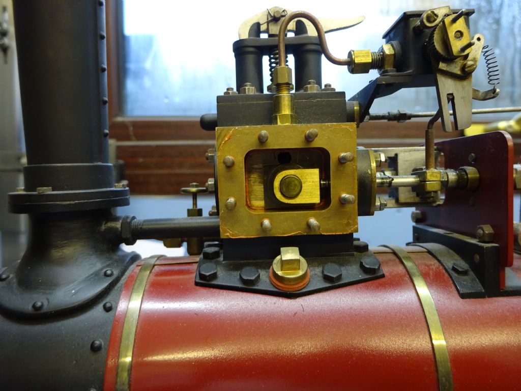

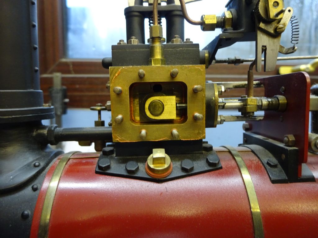

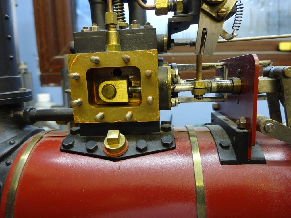

                                        I took the valve chest cover off of mine and took a few pictures for you. Reach rod in full forwards (or as far as you can get it before links hit the boiler) This will have the expansion link in its lowest position. The forward eccentric is the one nearest the flywheel and this rod should be in the top hole of the expansion link therefore when in full forwards it should be inline with the valve rod. All comments are looking from the flywheel side and flywheel rotating clockwise.
                                        Starting at Forward dead ctr eg crank pin at 9.00 o'clock the valve has just started to move towards the rear of the engine
                                        By the time the crank has rotated clockwise to 10.00 o'clock the front port has started to be uncovered
                                        at 12.30 the valve has moved as far back as it is going to and max port open
                                        At 3.00 o'clock (back dead ctr)the valve has just started to moved forwards and is about to uncover the rear port
                                        4.00 o'clock and port has started to open
                                        And by 6.30 the max of the rear port is open, after this the valve will start moving forward as we get back to 9.00 o'clock
                                        Well thats how mine is set up, seems to tick over OK on a bit of air
