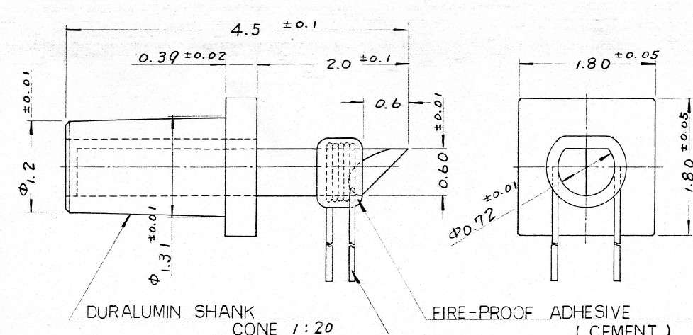

      Hi All,
      I need some very small parts making (1.8mm x 2.11mm).
      A friend tells me there is a company in Leicester that does miniature work, on Davenport autos. But he can’t remember what this company is called.
      Does anyone here know what company he’s talking about?

          bernard towers
            @bernardtowers37738
            I have to say that regardless of size I am really struggling with your drawing.
            #811443
              I think I have got the bit that matters, the only thing I can’t see is the actual hole size in the dural cone which by a by of maths is the part he is after at 2.11mm long.
              It’s  tapered round item with a hole to take the other part. it is that hole which I am not sure is just round or if it has a flat and the size of the hole is missing. A guess would say the hole is 0.72mm
              A view from the other end would help as the Heating coil? obscures the detail of the hole in he other view.
              Looks like a collet for some for of hot knife or engraver judjing by the shape of the tip.
