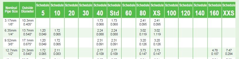

                          Paul Lousick
                            @paullousick59116
                            Martin,
                            The BSP system does not have a standard wall thickness for each size but is available in different thicknesses as shown in this link: **LINK**
                            If your work is using the ANSI standards for pipe (American National Standards Institute) it may be because of the availability of obtaining stainless steel pipe. S/S pipe is not as common as MS pipe and galvanised MS pipe used for plumbing, etc.

                              Paul Lousick
                                @paullousick59116
                                When BSP pipe sizes changed to metric they did not change the bore size to an OD in metric but specified it as an approximate mm size of the nominal bore diameter. The OD of a 1/2" pipe is 21.3mm, not 15mm.
                                The link above for 1/2" BSP pipe has the wall thickness for the available schedules. (From 0.065"- 0.294"). The wall thickness varies but the OD has to remain constant to be compatable with screwed fittings. The ID is important for calculating the volume of liquid that can pass thru the pipe and is given a nominal size (average size) for the bore.
                                Pipe tends to have thicker walls and have screwed connections. Tube is thinner and uses flared or clamp type fittings using an olive or are soldered.

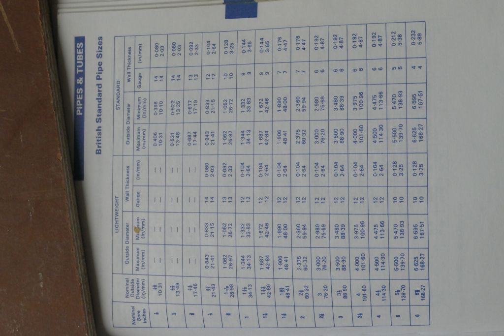

                                Martin Connelly
                                  @martinconnelly55370
                                  Paul, it doesn't say BSP pipe it says Nominal Pipe. You are repeating the same mistake again. British standard pipe was not supplied to a schedule, it had standard (imperial) gauge size wall and was a close match to ANSI but not the same.

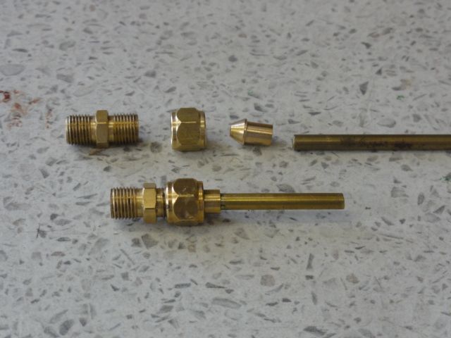

                                    Here is a picture of a set of bought in components.
                                    The pipe is 1/8" OD, the union thread is 1/4" x 40 TPI ME and the nut is 8mm across the flats.
                                    HTH
                                    Jim

                                    #544455
                                    Anthony Knights
                                      @anthonyknights16741
                                      A picture is worth a thousand words. Thanks Jim

                                      #544516
                                      Paul Lousick
                                        @paullousick59116
                                        Hi Martin,
                                        Is not the Standard pipe size in your table the same as Schedule 40 pipe which is the common size used for plumbing ?  It is even listed next to the Schedule 40 in the table above and is only one of the sizes available
                                        Paul.

                                          #544533
                                          Martin Connelly
                                            If you look at the tolerances of the ANSI standard and the BSP standard you will find that the ANSI standard is much looser. So while the nominal sizes of both look close but are not quite the same the actual sizes delivered under the two standards can be very different. Additionally the wall thickness in BSP is defined with upper and lower limits, the wall thickness with ANSI schedule pipe is a minimum with no maximum. The limitation on wall thickness with ANSI pipe is only limited by the pipe standard defining a maximum weight per unit of length. This means the wall thickness with ANSI pipe can be at the minimum for some distance then be a lot thicker for a short stretch before returning to the minimum and still be within spec. European manufacturers started to supply ANSI standard pipe defined by a metric defined OD and wall thickness that kept it within the ANSI standard but was made to a much better tolerance, more like an OD tube with ±0.005" tolerance on OD. This was important for people who needed accurate sizes for bending machines with costly outside dies and internal mandrels. Where I worked we often had ANSI pipe that we had to put aside labelled as for straight lengths only as it was either too large or too small a diameter for the clamp and bend dies to grip correctly or had a bore that was too small for any of the mandrels we had to go down smoothly (or occasionally was too hard and snapped rather than bent).
                                            The wall thickness issue showed up when looking at elbows, tees and reducers and pipes from different batches. In order to do  a satisfactory weld that was going to be X-rayed you needed to have matched bores and this often required that the thicker walled part had the internal wall reduced and blended out at a smooth and shallow angle to match the thinner walled part. Scoring that would show up on X-rays were unacceptable and the result was that a lot of time was spent manually blending parts for welding which put up the cost of pipes that required radiographic testing.
                                            The wall thickness issue with ANSI fittings also caused issues when the designers had assumed that ANSI pipe bores were what they calculated from the basic tables and had not looked fully into the tolerance issues. With smaller sizes such as 1" or 3/4" nominal bore you could have elbows with the actual bore as much as 50% less than the maximum. It plays havoc with flow calculations.

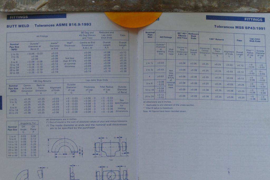

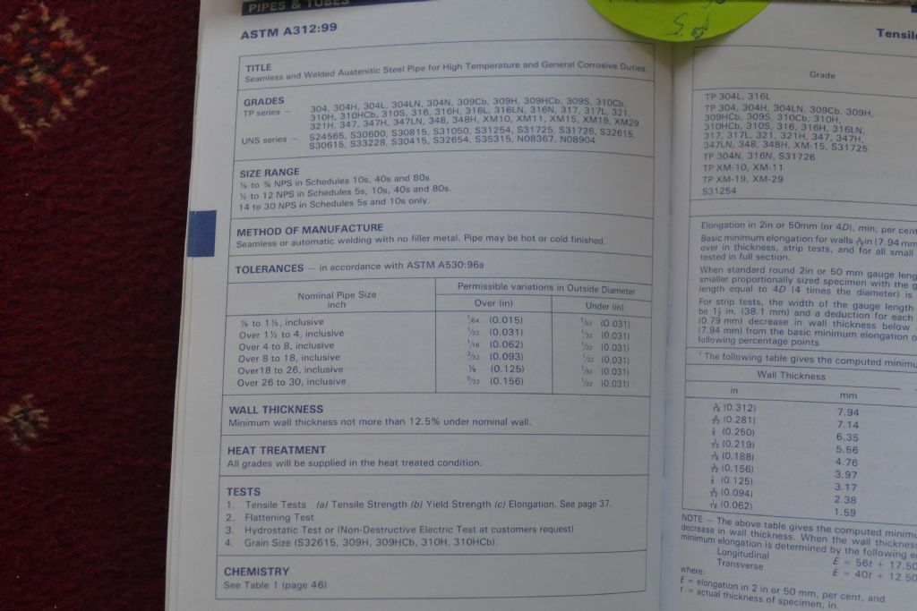

                                            #544545
                                            Martin Connelly
                                              This is the page of ASTM tolerances applied to ANSI general purpose pipes. Using this information you can calculate the maximum and minimum diameters of a 2" ANSI pipe and compare it to the BSP 2" pipe from the earlier post to see how different they can be. It also shows there is a minimum wall but there is no mention of a maximum and you have to delve fully into the standards to find the limiting factor on wall thickness is purely by weight. This means that the maximum wall on a pipe at the maximum allowed diameter is different from the maximum wall on a minimum allowed diameter pipe. An example of a very poorly written standard in my opinion.
