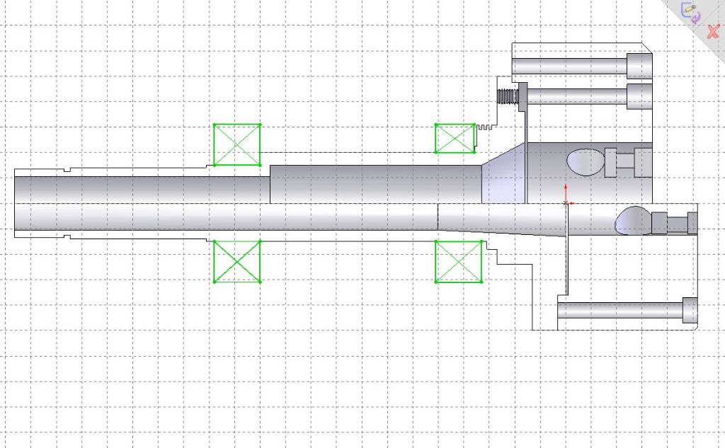

        Parting need less overhang and stiffer spindle.The picture shows a mini lathe upgrade where spindle (ca 15 $ among chineesemanufactures ,bearings (less than 2$) and drive system (30$) has changed.The spindle belt drive disc cannot sit between bearing and has to come out in free air..
        The gearing to leadscrew is unchanged and the 125mm four jaw is bored to 50mm.Front end of new spindle is 30mm bore.
        Enjoy or improve

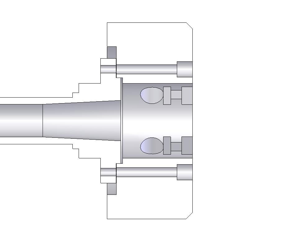

              It will also be no big deal to fit a 125mm big hole fourjaw on a 80mm mini spindle
              125 chuck on 80 spindel
