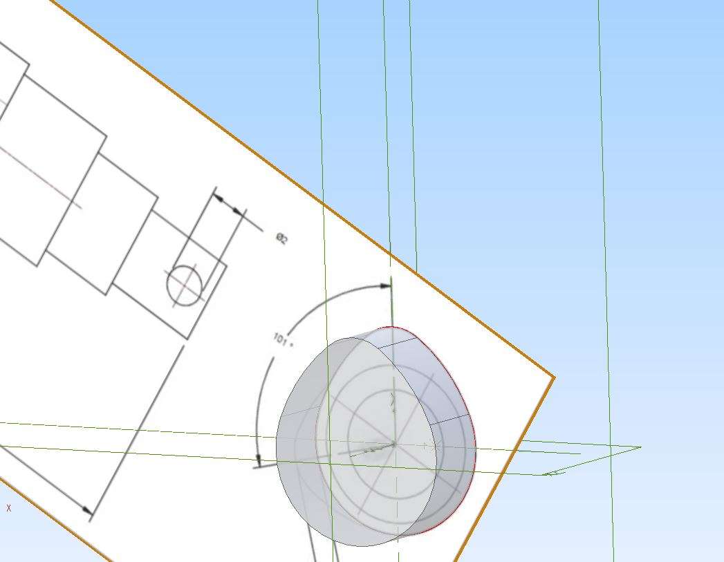

              #805125
                The 101 degrees is the offset of one cam from the other not the duration that is normally given.
                As the side view has neither cam at max lift the 10mm is not useful
                Lift is 1.3mm as given given
                As the 10mm is not to the peak then deducting 1.3mm from that won’t give the base circle.

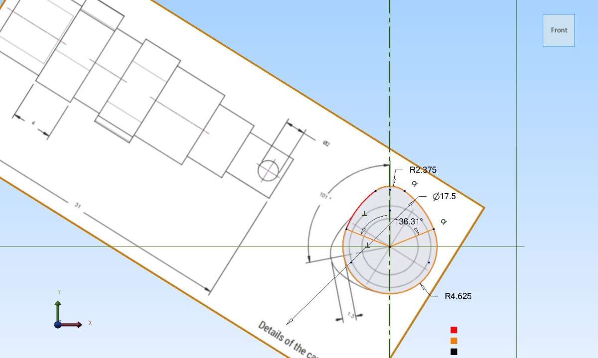

                Now I know you are using a boring head I will complet the CAD. This is what I have so far
                Base Circle Radius 4.625
                Flank Radius 8.75
                Tip Radius 2.375
                Duration 136.3deg
                cam1
                Scaled the 31mm length as it gives the least amount of error
                cam2

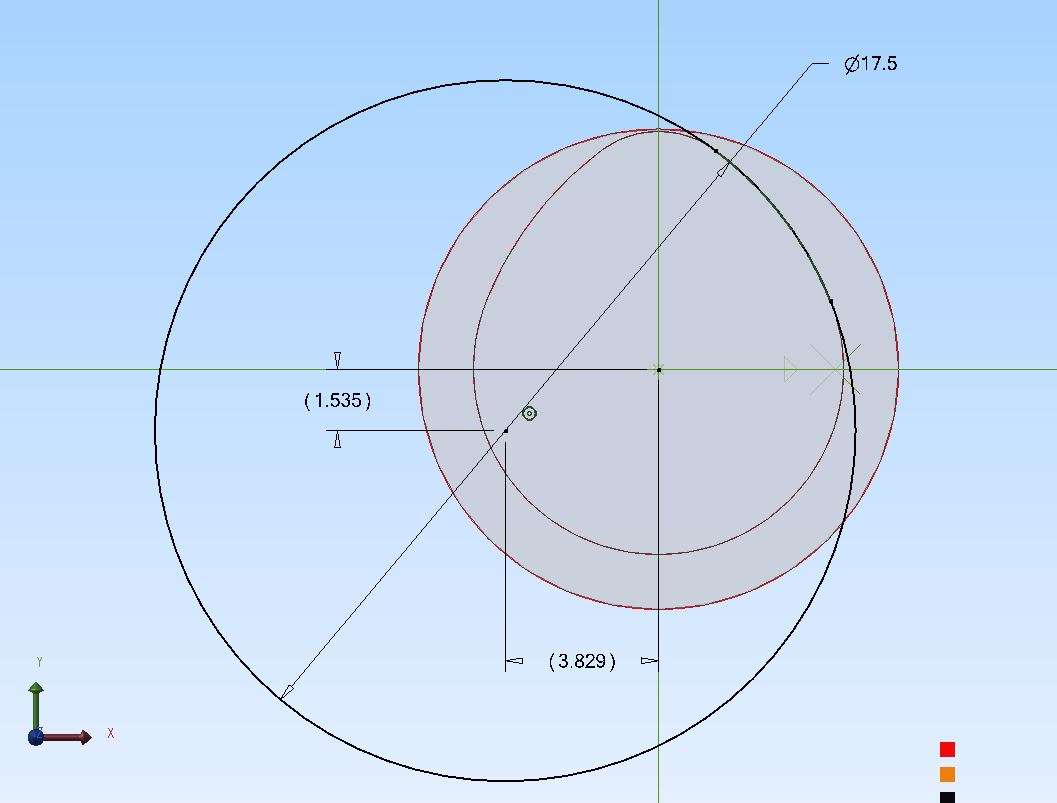

                #805128
                  So if we round the duration to 136deg that makes for simpler machining.
                  12mm stock would be the minimum you could use, turn to 11.9mm which will set the tip height
                  Set the boring head to swing a diameter of 17.5mm
                  Offset Y by + 1.535mm and bring in the boring head until the X offset is -3.829 which will have it cutting the right hand flank.

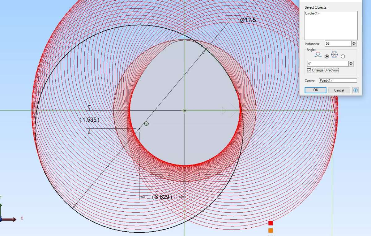

                  cam3
                  360deg less the 136 deg = 224deg which is how far the rotary table needs to be rotated assuming a 90:1 worm then 56 cuts at 4deg (one handle rotation) works out quite nicely. and will produce the cam. Just blend the tip radius with a file.
                  cam4
                  Check which end you are working from as this may need to be swapped round to get the two cams spaced correctly but assuming first cam cut from zero to 224 deg of rotation then second cam is cut from 101deg to 325 deg

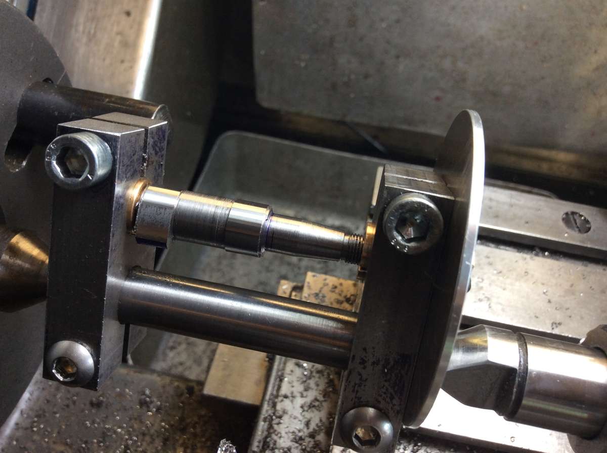

                        Why not use a Westbury jig???IMG_3839

                              #805193
                                It is quite an easy method and does not need any specific tooling just the boring head and a cutter that will do outside diameters. It’s only drawback is the length of the cam which can’t be too long as it may flex or get in the way of the boring head but fine for individual cams that will be Loctited onto a shaf or one or two cylinder engines. Any longer and the jig Bernard shows may be better.
                                One I prepared earlier
