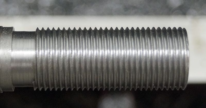

            Had a bit more practice thread cutting this morning and out of interest I took a different approach, I didnt set the top slide at 30 degrees but set it square. I did all the cutting on the cross slide which seemed to work ok, pitch is 1.25 on 15mm steel bar. A couple of questions: I ran a fine file across the top of the thread (picture below) is it enough or is it normal to have more of a flat on the peaks..? Also I dont think the root of the thread looks quite right maybe I need to look at the tool..?
            #387923
            Anonymous
              Looks good, but I agree the root/crest is a bit odd. I'd expect the crest to be flatter. What tool was used? A full form insert should automatically create the correct root and crest, provided you get the infeed depth correct. I always use the cross slide only for screwcutting, makes it easier to get the correct depth. Of course the acid test is does a mating part fit.
              Andrew
              #387924
              Ron Laden
                @ronladen17547
                Thanks Andrew, the tool is a HSS 60 degree which came as part of a set I have, its a new tool and I havnt modified it at all.
                Ron
                #387929
                Paul Kemp
                  @paulkemp46892
                  Ron,
                  Profile on that one looks better than the first one (from the pictures). One way to check the tool geometry and get a rough and ready "full form" tool is to check out in a bolt of the same pitch (using it the same way as your screw cutting plate gauge). That will show you if the tip width / radius is somewhere near correct. I also only use the cross slide and don't bother setting over the top slide with the proviso that if the thread is tearing I add a couple of thou on the top slide to move the tool over a touch and bias the cut on one flank. Useful if the tip of the tool is too pointed as once you get to depth and the root is too narrow and then crest too wide you can kiss a bit from each flank, cleaning them up and getting a better finish and evening up the thread, if you get my drift? Good wheeze to get things right if the tip is too narrow and you are at full depth, using the top slide at half the thread angle doesn't give you that flexibility.
                  Paul.
